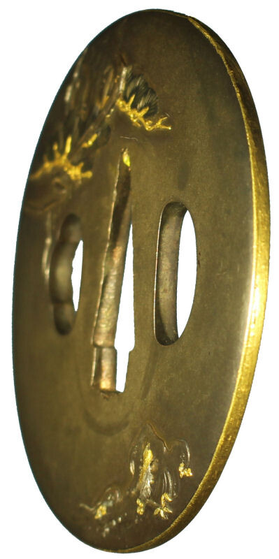

Hi

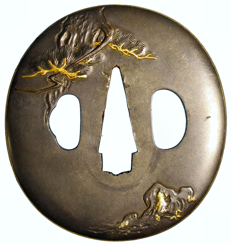

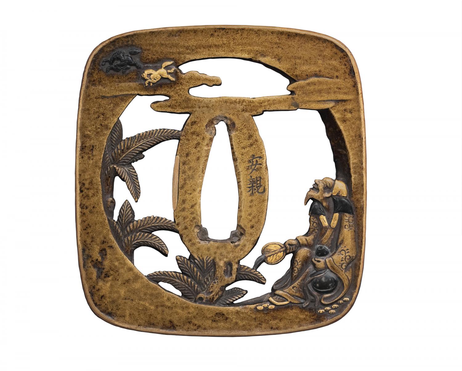

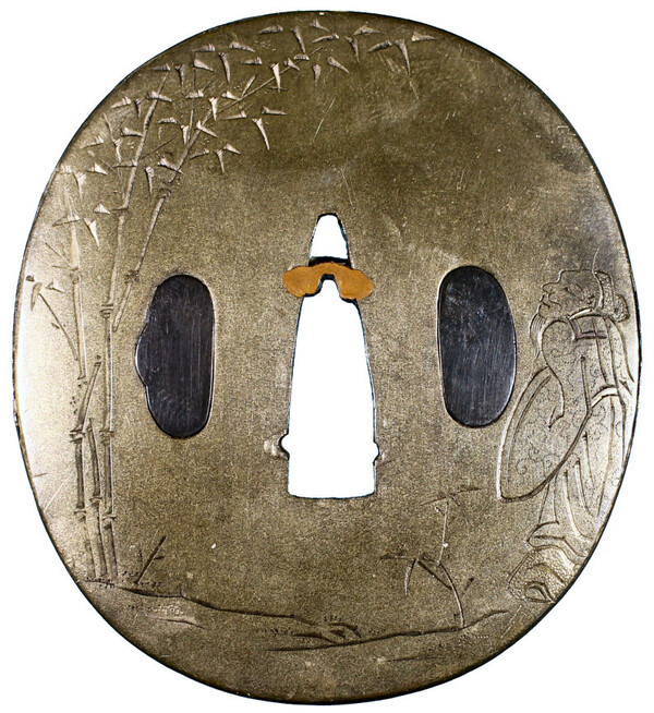

I have two tsuba that I think are gimei
One's been on before and the second was purchased from the NMB a couple of months ago
I'm updating my records and I like to be as accurate as I can so no problem with any views
Do not worry about adverse comments about the second one as I'm happy with the sale and have no intention of returning the tsuba

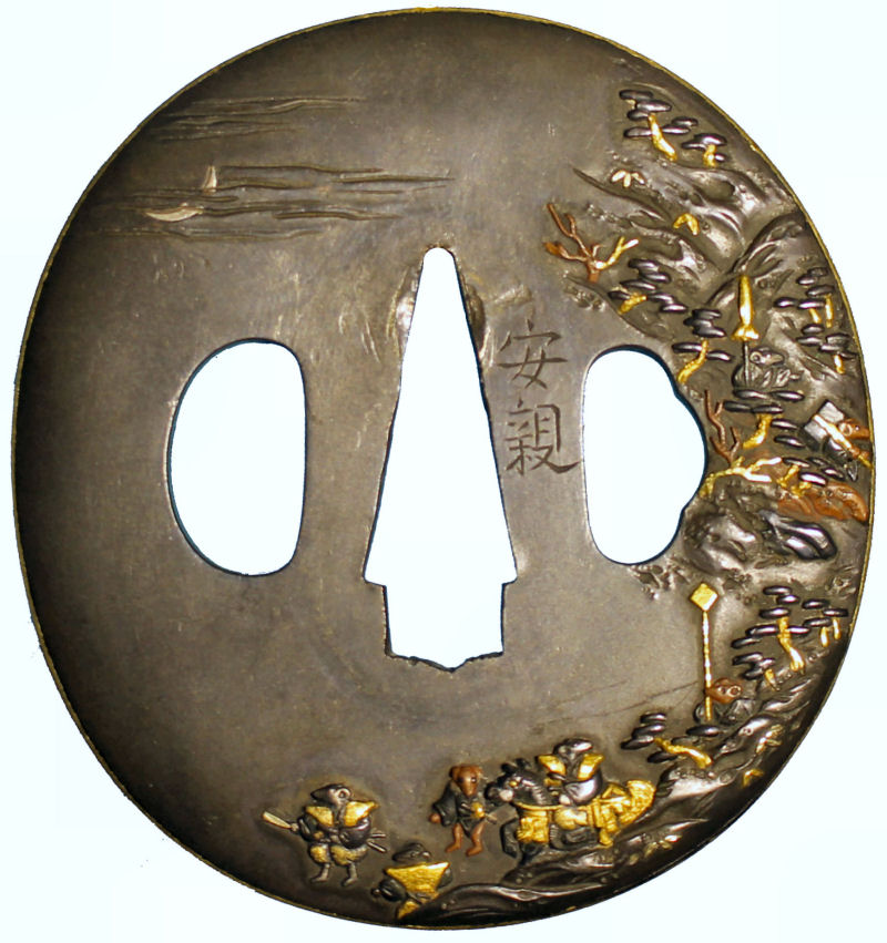

T367
Yasuchika 安親
Circa: 1750
Size: 69 x 65 x 3.9mm
post-2100-0-82733300-1591535935_thumb.jpg post-2100-0-59436600-1591535943_thumb.jpg post-2100-0-45245700-1591535956_thumb.jpg post-2100-0-64373200-1591535963_thumb.jpg

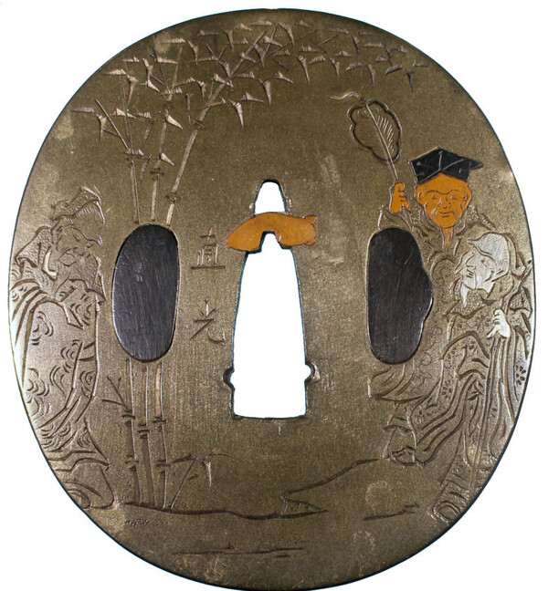

Yanagawa - Naomitsu 直光
Yanagawa Naomitsu (1733-1808)
Style: Kebori. Sanmei
Size: 73 x 66 x 4.6mm
post-2100-0-30650800-1591535975_thumb.jpg post-2100-0-83456000-1591535982_thumb.jpg post-2100-0-88599900-1591535991_thumb.jpg post-2100-0-41174400-1591535999_thumb.jpg

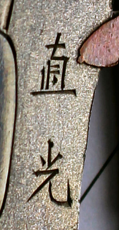

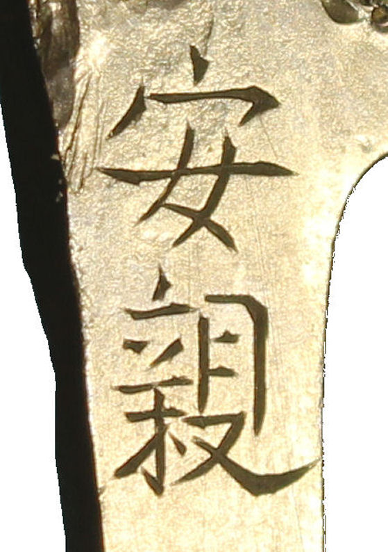

Thanks for the images. I think on mine one of the strokes is incorrect
They are nice

I wonder if the mei is removed and submitted for shinsa what the results would be
Not sure why you would expect adverse comments about the second one. I love it...that's my taste exactly. Little condition issue that could easily be sorted by Ford or others.
You should be very happy with that, as I would steal it in a heartbeat :glee:

An example is you will probably never see a well known maker outside a museum or special collector
In this case if the workmanship is very good you still have a gimei tsuba and generally it is a kiss of death
Remove the mei and you have a good tsuba that is not gimei
In very good workmanship it can be submitted for shinsa and an opinion gained rather than having it returned as gimei with no opinion expressed
This is the position I'm in with the two posted tsuba
PS. This is a lot more common with swords as the value is generally higher

I think the issue of (good quality) gimei tsuba could be more complex than we (Westerners) can appreciate. Possibly not an issue about to deceive on mere value of the object, and more on the attribution of value in a complex system of exchanging gift in Edo period. So a gimei is part of a cultural context that should be a pity to remove just to gain a better evaluation in a shinsa.
Just an opinion...
I can't help thinking that there is something badly wrong with the assessment during shinsa - any and all mei should be the very last thing to come into the judgement. Put some tape over the signature and have it assessed  - then you will get an unbiased oppinion and once the tape is removed either the assessors will have a smile or egg on their faces. Anyone think this is unfair?
Yes to Dale and Stephen where it is the Western way of objective proof and I agree with it, BUT - it is not the Japanese way.  Mauro is right on with the GIFT tradition and I suspect there is potential for a very much longer dissertation on this aspect.

The mei on the first tsuba is so well cut!
Ah, Grev mate, I appear younger because of the company I keep!!!  My Auld Wormates and I still hobnob together for lunches and reunions and we keep each other on our toes.  This is all through cancer ops and the sundry troubles of aging bodies.  Same goes for my Nihonto buddies.  Red wine too is a lovely prop.  My colleagues once asked (in our working daze) "Barry, is there anything red wine doesn't go with?"  I thought for a while and said "Tripe!"  Red wine goes well with raspberries and icecream, I have found...
Selfie will be forthcoming.  I get slack because I'm swept off my feet with distractions of manifold sorts, but it will happen.  In fact, I had some photos set aside, but I forgot in which folder I put them...
On your two tsuba, I particularly like the second one because of the fine condition of the shibuichi.  Even from a mere photo it exudes a certain quality.  Since you are in the UK do get Ford to have an in-hand look at it as it might be worth putting some restorative money into it.  Now, for our newer NMB members interested in tsuba I heartily commend this thread as a darn good read:

Now on gimei, We have all seen those gauche Meiji productions that "look good" at first blush, but are really knock-offs for tourists and the unwary.  They have no merit at all.  I have read that there are many times more tsuba in existence than swords to put them on, which bespeaks a burgeoning industry of (some) artists creating high quality utsushimono.  The parlance in Western art is to use the descriptor "After..." to describe a painting from a student in a master's studio.  The same applies to tosogu that are high quality pieces, but not from the Master's hand.

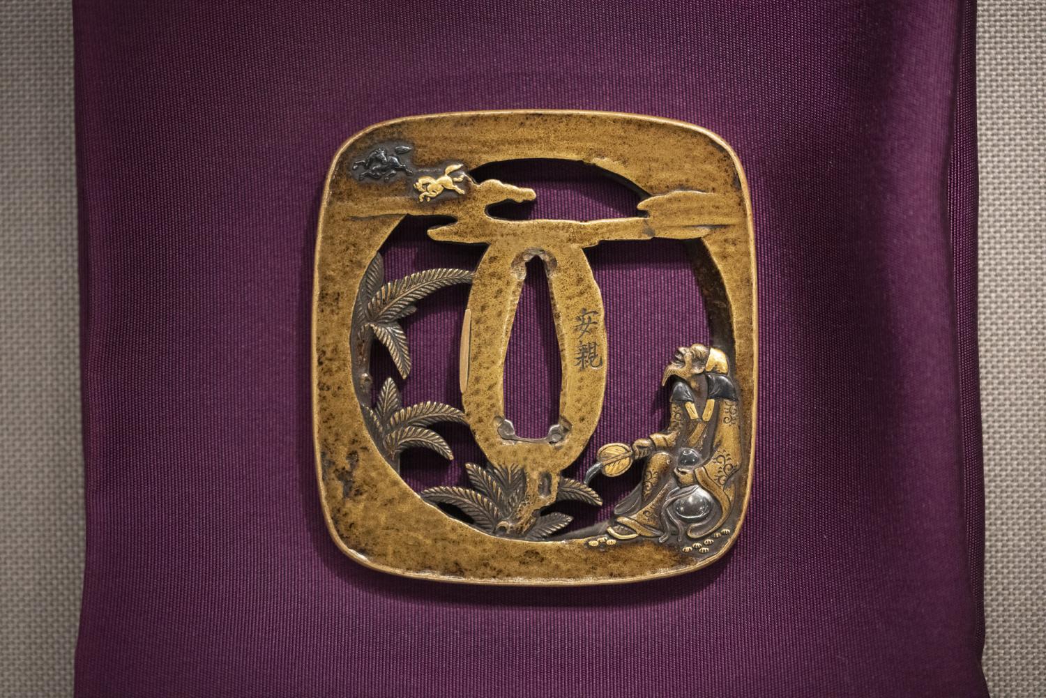

Dear Alan,
I surelly don´t own the tsuba. But I had the chance to make a photo in Tokyo at the Sword Museum. So I thought I would share. This is not just one shot but 4 pics stitched together.
You can see my workflow. If you have Photoshop and your are interested in my post production process I attached the psd-file as a download. But be carefull: 814,1 MB. :)
http://daten-transport.de/?id=kS3KTwR4LzET
Uwe G.
I hate it when they display a guard with a dark background - it seems to suck the colour out of the image - [and when I want to copy an image I don't have Photoshop so I must trim everything in MS Paint !] Why can't people be more responsible, and make it easier to steal an image? :glee:
PS I would like to steal that tsuba too !  :)
