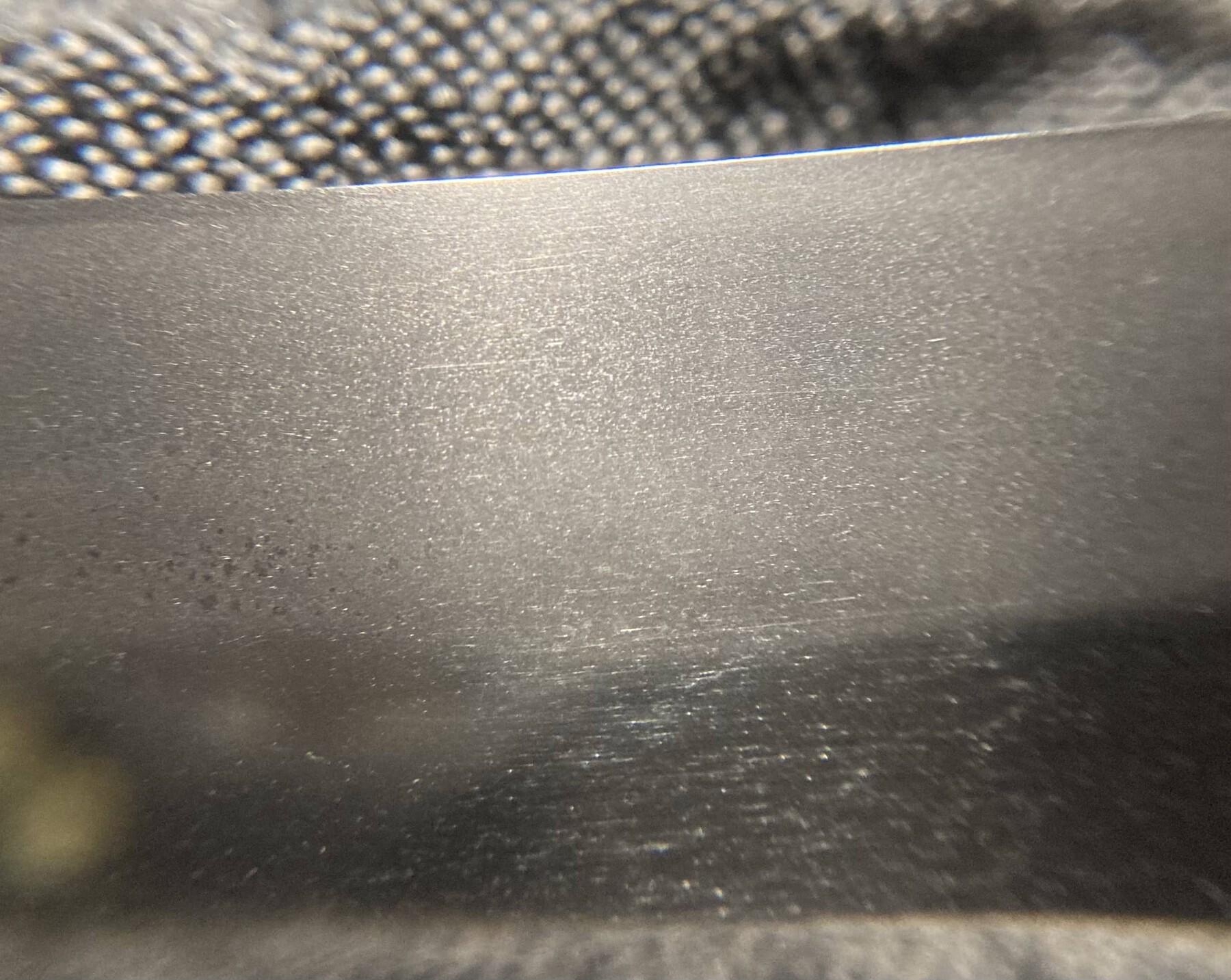

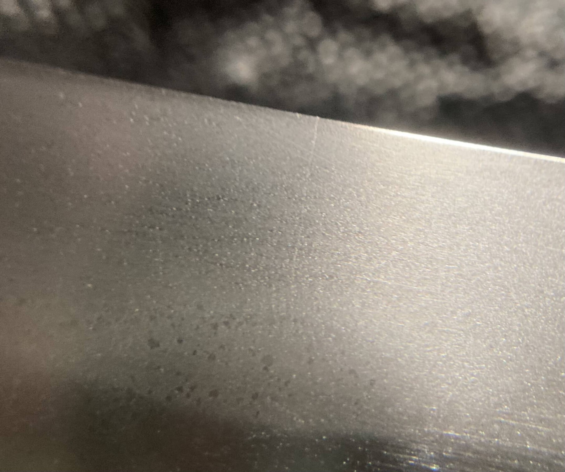

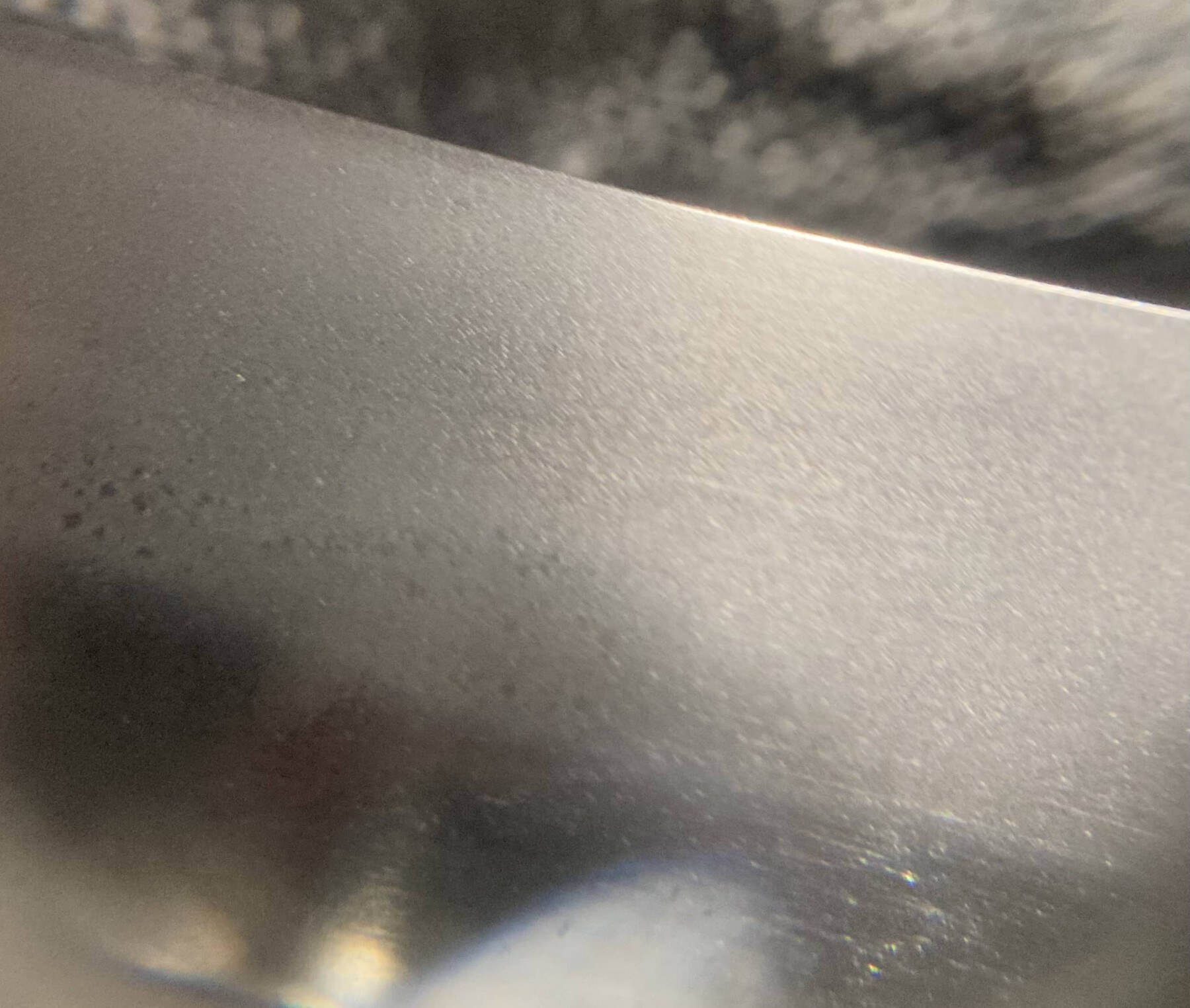

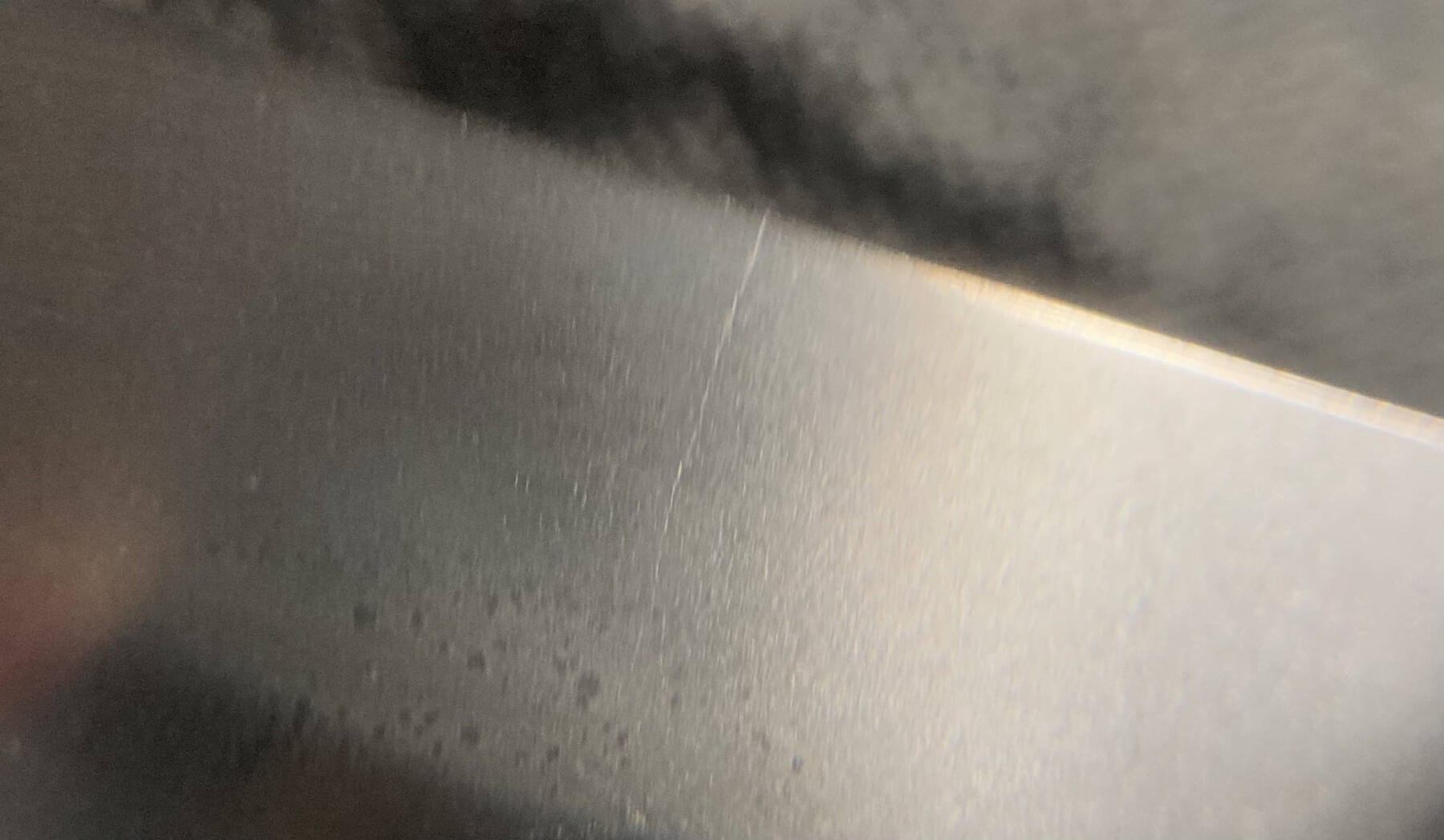

So I will preface this by saying the dealer I obtained this sword from is certain it’s not hagire, has an excellent reputation here and elsewhere so this absolutely isn’t a case of someone like Monkey trying to fleece me. That said, I noticed while examining my sword with a lamp that there was an edge scratch on both sides, perpendicular to the hamon, and that provoked the sword hypochondriac in me so here I am hoping it’s not a crack.
The “scratches” in question are almost impossible to see with the naked eye unless you have strong incident lighting, if so they’re visible depending on angle. With a phone mounted microscope, they are more notable, one is an interrupted scratch with no depth whereas the other side seems to have a very shallow gouge. Again, not very visible under some lighting and noticeable under other angles. Also, there is no apparent depth to the scratches, I ran a nitrile glove covered fingernail against the scratches and never could feel any sort of depth or catch like true cracks and gouges have. Oil also did not seep or sink into the scratch or linger there; being as easy to wipe off from the scratch as any other part of the edge.
My dealer is sure that the appearance of the the scratch along the the lack of any depth, and his not observing hagire while selling means it’s just a scratch? Would other experienced eyes agree with that? I hope these photos under different magnification and lighting help.

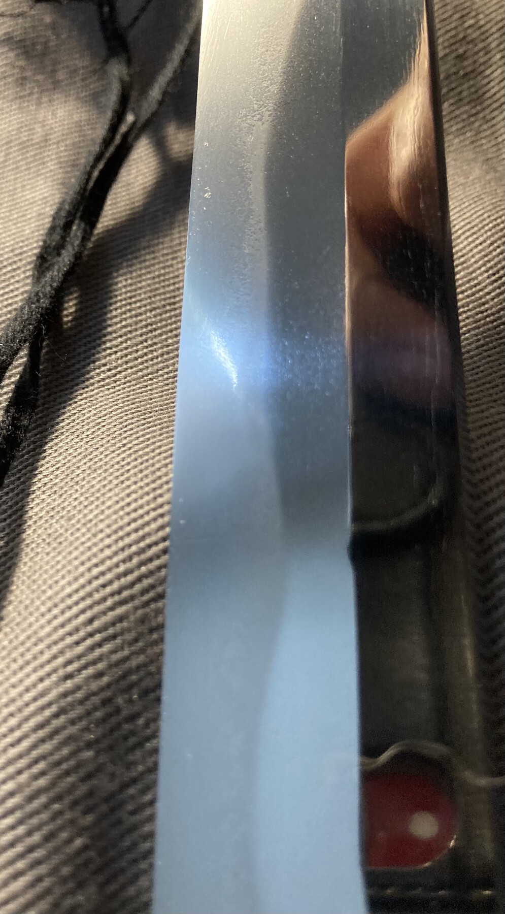

Also, here is a photo taken without a microscope and with a lighting angle that yields maximum scratch visibility.
I also have a YouTube video of the scratches, it’ll need to be viewed at maximum resolution to discern them
I am including the video because I think it’s the most representative of what the scratch looks like under the naked eye: near invisible unless you’re hunched over and looking at the edge with good lighting.

in my understanding, a scratch will be straight or almost straight. What I see in your photos does not look like a scratch.
If this phenomenon is visible on both sides in exactly the same position, I don't know how to call it otherwise than HAGIRE.
Juan,  Do you have access to a blade with a scratch?  If not, perhaps someone can post a photo of what a scratch looks like.  When you compare the two, you'll know the answer.
I would not say it’s symmetric as it’s interrupted on the other side, but yes it’s present in both.  That said my dealer was adamant that it could not be hagire.
I do have blades with scratches, and from a naked eye (the video) it does resemble some shallow scratches (invisible unless angled right with light), which is why the dealer insisted it’s a scratch. I would say this one is a bit different from deep scratches in that I can’t notice depth. It was my understanding that there would be some depth in a hagire and oil would adhere. Is it possible for hagire to also exist in a seemingly depthless form?
It would certainly concern me if it is hagire. I’m not certain what to do next.
If it means anything the “scratch” isn’t apparent unless I have great lighting.
That would certainly be terrible news, I’m fond of this sword and I wouldn’t know the first thing to do if I was inadvertently sold a hagire sword. And only now, about two months after the sale have I gotten down to studying it and noticed the flaw.
The dealer doesn’t think it is hagire and says he observed no hagire. Could have just been missed since it’s so hard to see? Could this have happened during the shipment (I see no damage to the sword though and the polish is good)? What should I say if he’s certain it is a scratch?

The simple odds of there being any kind of "scratch' apparent on both sides of the blade, at exactly the same location, are beyond minimal, better luck with buying a lotto ticket I'm afraid.
Additionally, in the magnified views, you can clearly see the anomaly following grain patterns. That would be as very cleaver hat trick for a scratch.

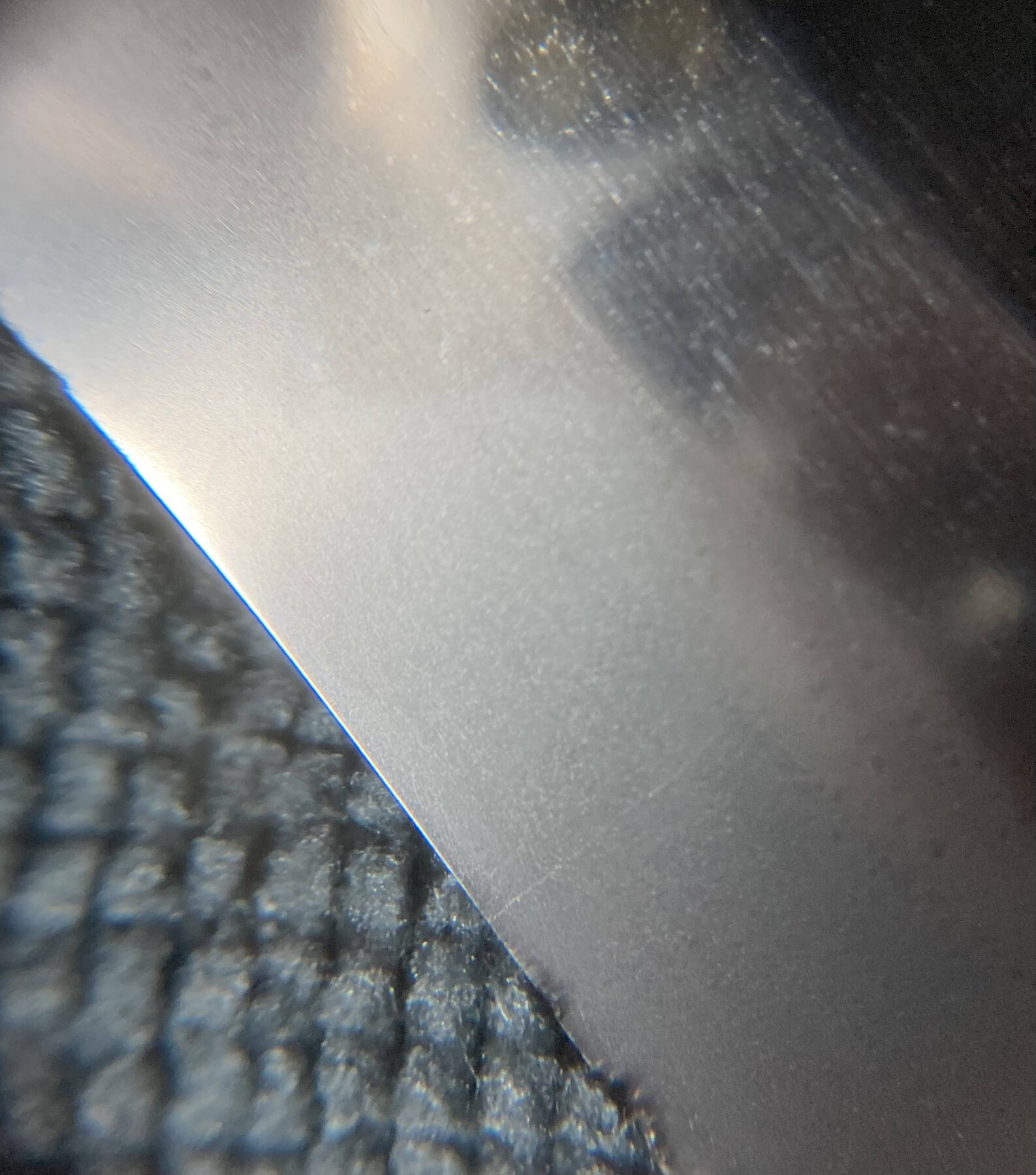

I wonder if there is any chance the crack/scratch could be spidervein rust damage, it seems that some time after the last polish,  the sword suffered minor surface rust damage on the ha, which was treated but left depressions and colored spots on the ha. I’ve seen spider vein rust in the past and wonder if this could be the case since some parts of the scratch/crack are interrupted (as in no crack for part of the length of the crack)  and depending on the light angle it’s invisible. I hope these photos show that.
Regardless I will be contacting my dealer.
Thanks again everyone,
A jewelers loupe or good  magnifier will help clarify matters, but i have not seen rust damage mimic cracked steel. Unfortunately, it only takes seeing a few hagire in one's own work for recognition to occur. A polisher can use uchigumori hato finger stones to eliminate a scratch; hagire will remain.
