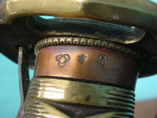

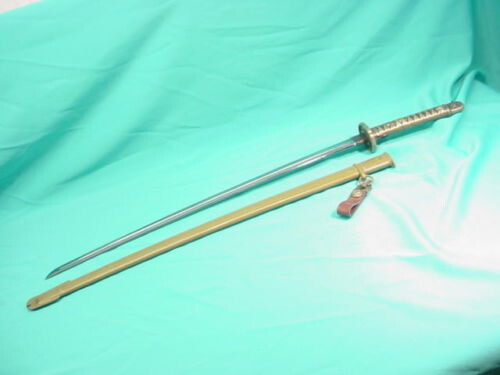

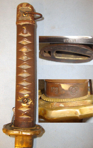

Shamsy Posted June 23, 2016 Report Posted June 23, 2016 Hi all,while I'm sure our members know how to pick a fake NCO, I wanted to share these.http://mountcastlesantiques.com/index.php?main_page=product_info&cPath=18&products_id=277http://mountcastlesantiques.com/index.php?main_page=product_info&cPath=18&products_id=276&zenid=qot0424cgushvekob07rapkkq2The really disappointing part is that I informed the site owner about the first sword and provided a comprehensive list of indicators the sword is not genuine. I offered to send photos or provide opinions from experienced collector's. After that I heard nothing. Today I checked, just in case the sword was pulled from sale, and lo and behold there is a 'rare copper handle' now listed, clearly of the same manufacturer. Truly disappointing. Quote
Kai-Gunto Posted June 23, 2016 Report Posted June 23, 2016 The last idiot hasnt been born yet! 1 Quote
lonely panet Posted June 23, 2016 Report Posted June 23, 2016 like many dealers, there main concern is profit, regardless of the piece being a reproduction. I have been asked this many times at shows, from dealers and buyers. once told the facts they simply try and sell it on at the same price they paid, to avoid a loss of money instead of learning from there mistakes. collectors often have a higher knowledge base then dealers, and a higher respect for items and there history. As we have a grater passion for and preservation in mind rather then profits as a dealer does. 4 Quote
charlie1 Posted June 24, 2016 Report Posted June 24, 2016 I searched into the rest of the Japanese items on the site. What a bunch of junk. The sad part is someone probably will buy one of them too. Charlie Quote

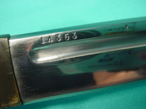

Shamsy Posted January 13, 2017 Author Report Posted January 13, 2017 Here is another example that's not too bad, but the bohi, stamps (these are most obvious parts) and other details are off. Even so, enough to fool a novice. I'll continue to post where I find different examples. 1 Quote
Stephen Posted January 13, 2017 Report Posted January 13, 2017 well it would have fooled me, how about you other gunto guys? Steves last post real or copy? Quote
Stegel Posted January 13, 2017 Report Posted January 13, 2017 This is why the education side of collecting is so important!! To a novice who buys on impulse........then asks in the forums..........you'll get BURNT This is a blatant fake, which you should keep well away from. Quote
Jean Posted January 13, 2017 Report Posted January 13, 2017 No, as stated by Steve, the bohi is off. 1 Quote
Bruce Pennington Posted January 13, 2017 Report Posted January 13, 2017 well it would have fooled me, how about you other gunto guys? Steves last post real or copy? This looks good from a distance, but up close the details reveal the fake. The biggest giveaway are the stamps. They are getting better with the Kokura cannonballs, but this one - the lines are to thin, the balls too big. Then the horror is the "Ko" stamp! WAY too big, wrong place and the square imprint around it. The seppa is a clear fake, and like everyone else said, the bo-hi starts too far down the blade and the tip is round (like a Nagoya). Quote
mauser99 Posted January 13, 2017 Report Posted January 13, 2017 well it would have fooled me, how about you other gunto guys? Steves last post real or copy? As I said in the other NCO topic. The overall swords are getting better. The best place to look is at the serial Numbers. One, they aren't in the correct range. Second the Font isn't even close. Here is a decent fake Stu W. posted over on WAF. This would fool most entry level guys. The serial #'s are the best place to focus IMHO 1 1 Quote
Bruce Pennington Posted January 13, 2017 Report Posted January 13, 2017 As I said in the other NCO topic. The overall swords are getting better. The best place to look is at the serial Numbers. One, they aren't in the correct range. Second the Font isn't even close. Here is a decent fake Stu W. posted over on WAF. This would fool most entry level guys. The serial #'s are the best place to focus IMHO Yes, those are strangely too perfect and not a recognized font. Quote
Stephen Posted January 13, 2017 Report Posted January 13, 2017 Wayne i would have called bad on it, think F&G early book had balls that big, remember two diff stacked ball stamp, or not, memory, lol, i jest. Quote
Shamsy Posted January 13, 2017 Author Report Posted January 13, 2017 The detail that troubles me is the saya suspension ring being in the right place. Usually the copies are considerably lower, making it very obvious. Slowly improving. I'm reposting the pictures of the fake pattern 5 that Stegel provided in the wooden handled topic just to have them all together. 1 Quote
mauser99 Posted January 13, 2017 Report Posted January 13, 2017 another example where they got the product near correct but numbered it wrong. And with the wrong type stamps. Serial range could be wrong as well but, I cant see them. Quote

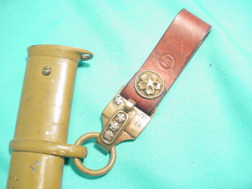

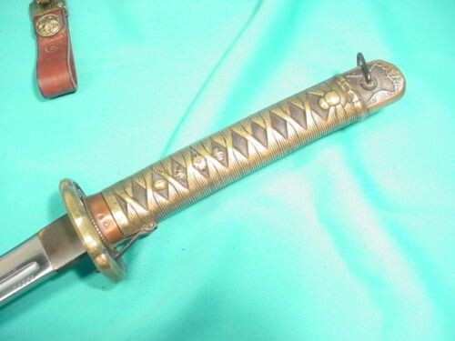

Shamsy Posted October 24, 2017 Author Report Posted October 24, 2017 Hi all, A new sword was pointed out to me recently which is very well made and in fact at first glance addresses a lot of the issues with obvious fakes. Cheers to Dan for bringing it to my attention. Because it's really quite a nice repro, thought I'd better share it here as for reference. Obvious two issues are the scabbard pattern and additional screw. See how many more you can pick! Gee they're starting to get good though... 1 1 Quote
PNSSHOGUN Posted October 24, 2017 Report Posted October 24, 2017 The one thing that always sets off alarms on these is the tsuka almost looks blurred or sandblasted, the real NCO's are usually crisp and bold and well defined. It's hard to really pin down, just doesn't sit right with the eye. Otherwise that is dangerously good to newcomers or unwary collectors looking for that ebay goldmine. 2 Quote
J Reid Posted October 24, 2017 Report Posted October 24, 2017 Close up and of kissaki and bohi termination is a must. It's a huge tell tale. Fakes never get it right. 2 Quote
Bruce Pennington Posted October 24, 2017 Report Posted October 24, 2017 The one thing that always sets off alarms on these is the tsuka almost looks blurred or sandblasted, the real NCO's are usually crisp and bold and well defined. It's hard to really pin down, just doesn't sit right with the eye. Otherwise that is dangerously good to newcomers or unwary collectors looking for that ebay goldmine. I agree and have never been able to put it into words like you just did. The real tsukas have crisp detail, and the fakes always seem not-crisp. Also, they definitely like those brass tsukas, don't they! I have NO idea what that belt hanger is supposed to be. Quote
lonely panet Posted October 24, 2017 Report Posted October 24, 2017 and it has a brass tsuka. 1 Quote
Shamsy Posted October 24, 2017 Author Report Posted October 24, 2017 All correct! There are a bunch more issues with the sword, so if anyone wants to test their detective skills this is a good opportunity. I just wanted to chime in here... I probably say this way too much BUT to flog a dead horse, the NCOs have a ton of small variations between subcontractors and between batches themselves, so just something to keep in mind. Quote
zook Posted October 25, 2017 Report Posted October 25, 2017 This sword I shared with Steve (this thread) is a very good knowledge test - the goofy belt hanger (Bruce references) made me discount the sword immediately, but on closer look (my opinion) the stamps are a bit better than the other, cheaper fakes out there on the market. I think it's always worth spending the extra time to study these "high end fakes/copies" because they are getting better. Referencing Carlo's post from last year, I also used to collect some German (for MANY years) and was quite confident in my ability to spot fakes, but I admit the quality is now off the charts (especially helmets) and it forced me totally out of that hobby. I am extremely thankful for the help/knowledge shared in this forum. Dan 1 Quote
