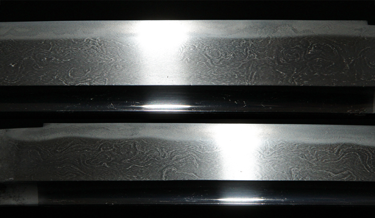

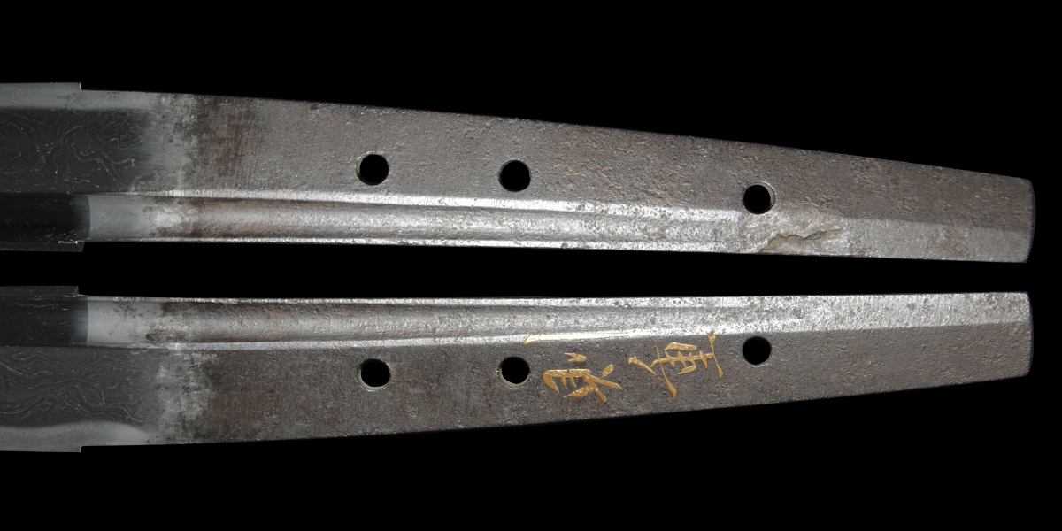

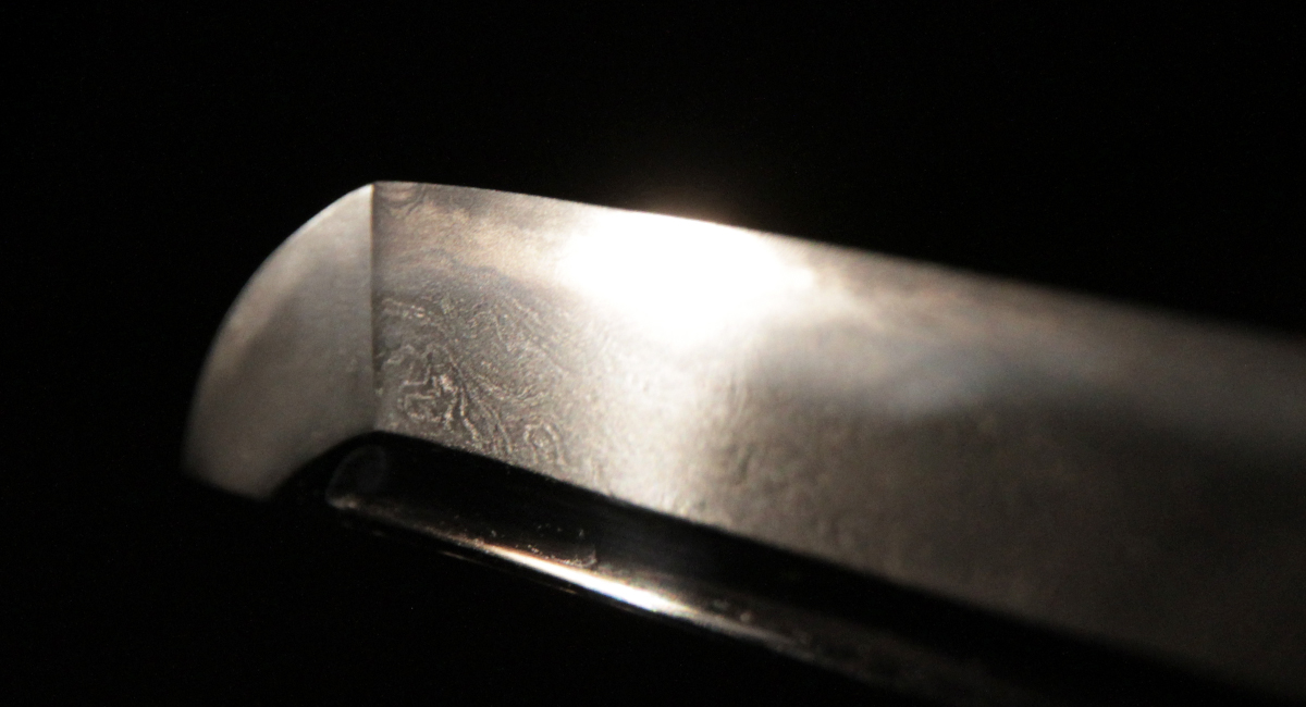

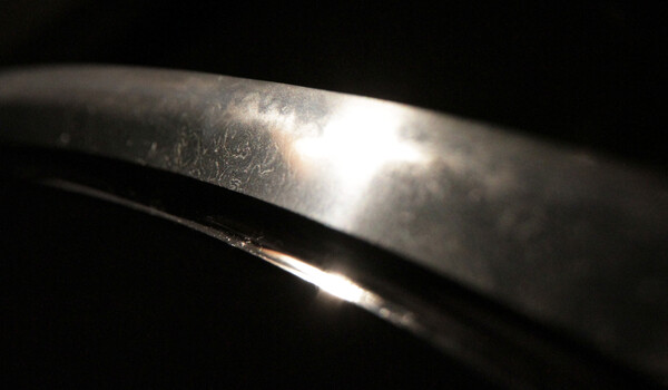

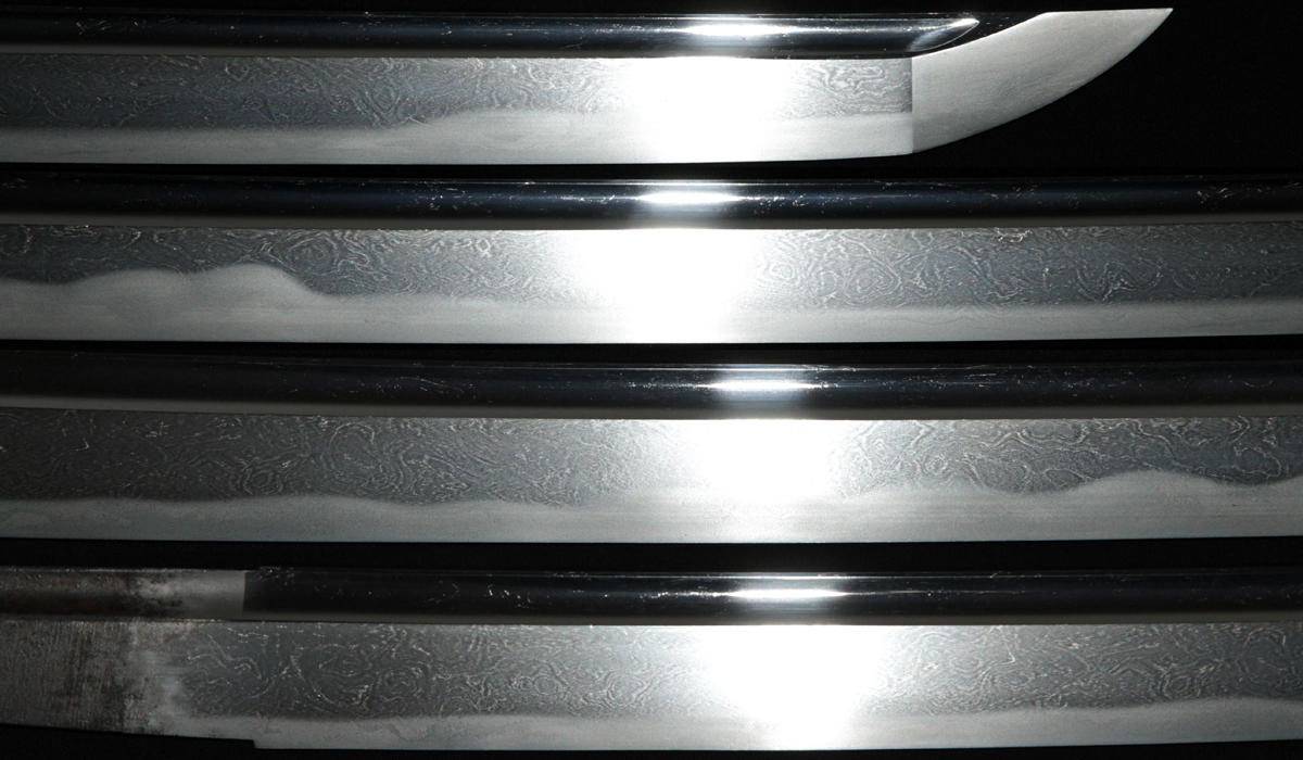

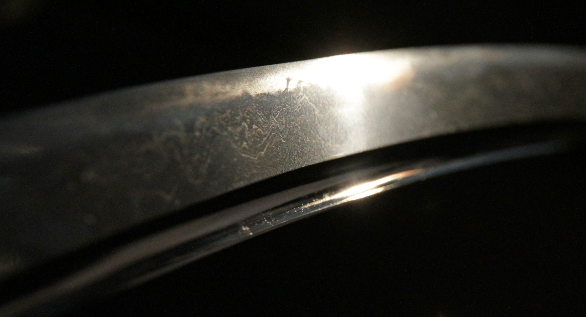

Hi Friends, I've been fortunate to handle a beautiful piece of history even thought it was for a very very short time, it was a tease more than anything. A client of mine was on the hunt for this big name and so with a bit of luck and timing on our side I was able to satisfy his appetite. Norishige who was one of the big Juttetsu and having played such a big role in Soshu-den History I felt that it was unfair for this piece like this to disappear into the dark corner of a private collector and possibly remain unseen for the next couple of decades. A piece like this deserves to be looked at and appreciated, especially for those of us who will never own or touch such an item. And so with the permission of the owner I would like to offer some pictures and leave an open discussion for those who would like to study and comment on this piece, share some knowledge preferably in a constructive way where others can benefit. Attaching other pictures for form of comparison/ study are permitted so I leave this in your hands from this point on. I won't be participating in this discussion as my workload is backlogged. I ask members to keep in mind that the owner may have a peek at this so please don't be too harsh if you have something negative to say. I will ask this thread to be deleted in the future out of respect for the owners wishes so you are welcome to save everything.
The nagasa is just over 73cm with a Kinpun Mei most likely done during Edo period. It does have recent Juyo papers for those who are doubtful of its authenticity. Enjoy and thanks to everyone who took a peek!

I can't see how anyone could have anything negative to say about this piece. Wow. What a stunning blade.
Look at that hada! You can see why he was famous for it.
A stunning, healthy and very old piece with a long nagasa and confirmed kinpun mei? What's not to love? The owner should be very proud.
The style in the daito above is heavily influenced by Ko-Hoki. It's later work of Norishige, towards the end, it's restrained and country flavor, it's broad with the matsukawa hada fully implemented. It's what is carried on by Uda just not as well and in Tametsugu and almost as good. Some ways of looking at Uda are saying a sword done like this but without the class and skill is going to go to Uda. Halfway between, so a lot more skilled than Uda, to Tametsugu.
Be wary of kinzogan and kinpun and be sure that you read all the NBTHK comments on these, especially as the level of the blade goes up. This setsumei should be translated and read. I think when there is no Honami signature it's not so dangerous but when there is the NBTHK may defer on the front page to what it says on the nakago and then in the setsumei explain their point of view. The fine print is what counts.
Hamon with the uchinoke looks old and because it's restrained I feel like this comes right at the end where he has gone through all of the cycles of flamboyance and has settled on something dignified and natural. Sometimes with this style he will light up the ji with a lot of bright yubashiri that track the jihada and make it glow. In the oshigata you an see a little hint of this developing so it may be a bit on other parts of the sword.
