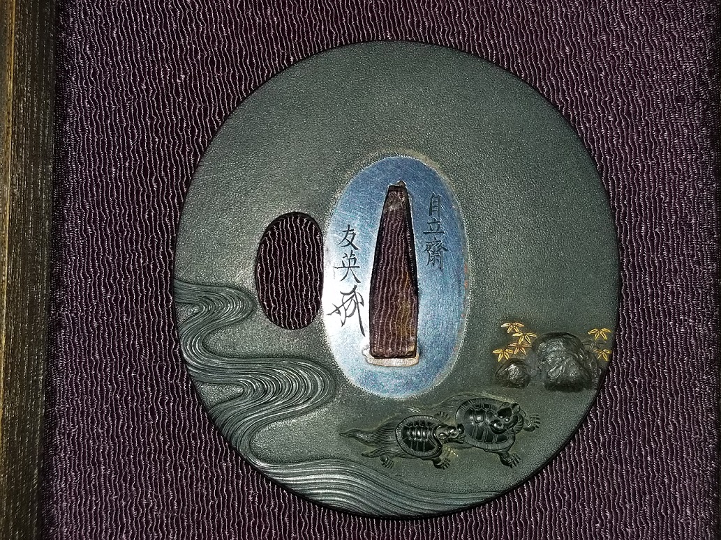

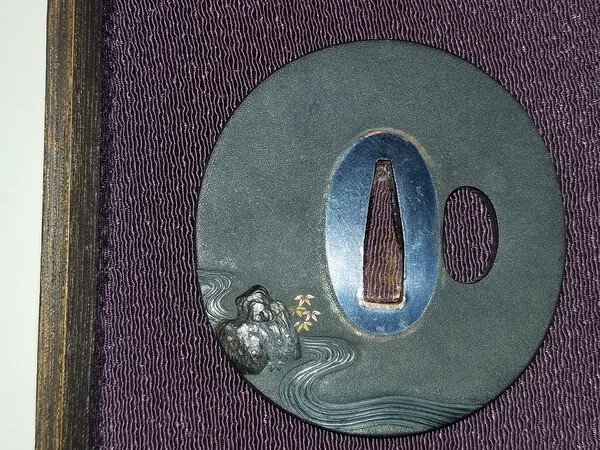

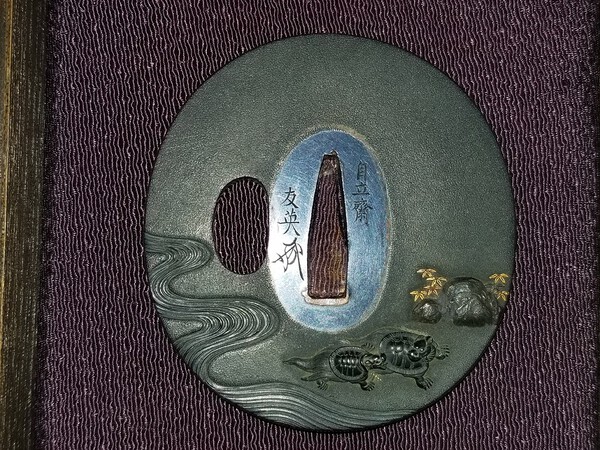

I like stories, legends, and a tsuba that tells one. So of course I fell for this tsuba, even though by decision I shy away from smaller tsuba. Really glad I did. Arrived yesterday, picked up today at Post Office. Had fun all evening so far in study.
A short link to tell the tale of the Minogame in Japanese Culture (most probably know it, but it was new to me):
http://the-turtle-co...se-culture.html
Snippet:
"The minogame is said to live at least a thousand years (with some living up to 10,000 years!) and have a long, hairy tail, which is actually seaweed and algae that have grown on its shell due to its ripe old age! It has very similar to the real-life common tortoise, which can live for hundreds of years. In Japanese culture, the minogame represents longevity and wisdom, and is a long-revered symbol of both. In art, it is often shown with other gods and symbols of longevity, such as the crane, or Taoist deities such as Jurōjin. The minogame is also depicted with the Three Jewels, which represent fortune."
This work is by Miyake Jiryusai Tomohide, son of Miyake Terumitsu, Yokoya School (was some confusion in Haynes index on this point).
NBTHK Hozon in November 2018:
nihiki-minogame no zu tsuba (⼆匹蓑⻲図鐔) ‒ Tsuba depicting two old turtles with seaweed growing on their backs
Signed: Jiryūsai Tomohide + kaō (⾃⽴斎友英「花押」)
Oval shape (tatemaru-gata), of shakudō with ishime ground, takabori relief, sukisagebori engravings, zōgan inlay, iroe accents, angular rim with some roundness (kaku-mimi ko-niku)
Size: 70.6mm X 66mm X 4.7mm
I am super excited about this piece, it's a stunner in hand. Detail work and accents/inlays are wonderful to look at. I don't want to over talk it. Only negative (knew this going in, so was my choice) as it's shakudo, there is some tarnish (verdigris?) in some areas. I am fully prepared to have this restored if it can be done (Ford Hallam) but it's wonderful right now and maybe dehydrate then protect with ren wax could be an option.

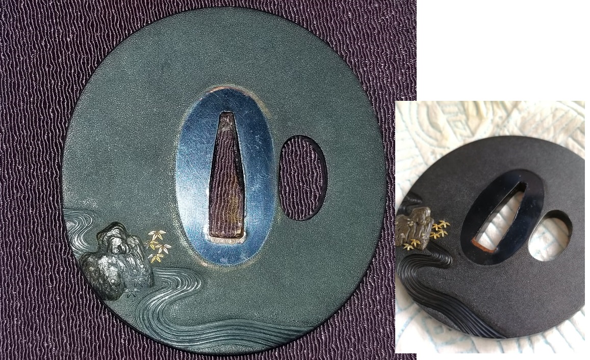

Actually, it's a question I have that the more experienced members maybe can help with.
This tsuba has NBTHK papers and the picture matches the work of course, but shows the blemishes. If I have this restored/cleaned/etc I think as long as I document it, it won't be an issue. Any input?

Posted 15 July 2019 - 12:53 AM
After the outage here on NMB, a bunch of comments for this thread were lost. As Ford Hallam was kind enough to allow us a look at an episode of his Patreon video collection in regards to this tsuba, here it is again:
https://www.youtube....JhIHm3QrGETJYmA
The Tomohide is finished cleaning and repair now. When I have it back in hand will do a proper reveal of the restoration. I can assure Ford is a magician, and you should have zero concerns if you want to work with him.

Ford has completed the Tomohide work, and the results are exceptional. If you are a subscriber on the Patreon page, there is a new video which documents the final work:
https://www.patreon....ordHallam/posts
I am hoping to have the tsuba in hand soon, but why not give a tease look at what was done? Full pics to follow later on. Can't wait to have it back. And something else will be coming as well, something in the works for a long time now.
Before and after; I know lighting is different but you can get an idea. Lighting will be same when I have it in hand. A saved piece that was at risk for verdigris damage, I can't be more thankful as I love the tsuba:
