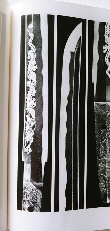

PNSSHOGUN Posted March 17, 2022 Report Posted March 17, 2022 Hi Bryce, here is an example from the Shin Shinto Nihonto Koza: Quote

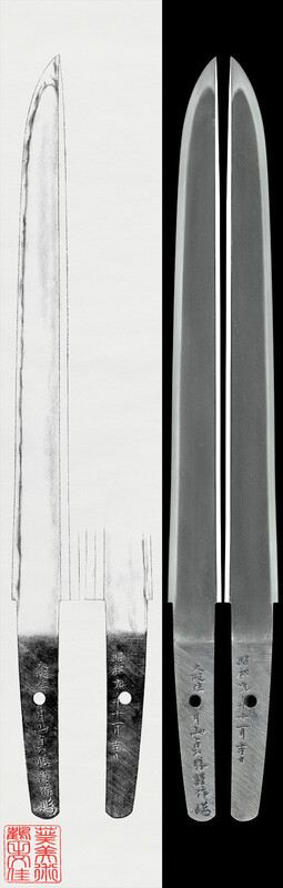

PNSSHOGUN Posted March 24, 2022 Report Posted March 24, 2022 A tanto stating Masamune's technique was used: https://www.aoijapan.com/tantoosaka-ju-gassan-sadakatsu-kinsakukao/ Quote
Manuel Coden Posted March 24, 2022 Report Posted March 24, 2022 15 minutes ago, PNSSHOGUN said: A tanto stating Masamune's technique was used: https://www.aoijapan.com/tantoosaka-ju-gassan-sadakatsu-kinsakukao/ It doesn't say anything about Soshu or Masamune anywhere, on the hakogaki it actually says "Awataguchi" 粟田口 1 Quote
Bryce Posted March 24, 2022 Author Report Posted March 24, 2022 Looks like it may have been a cut and paste error by AOIJapan in their description. The hada does resemble Awataguchi nashiji. Cheers, Bryce Quote
SteveM Posted March 24, 2022 Report Posted March 24, 2022 Yes, it looks like a careless mistake from Aoi Art (again). He does have another Sadakatsu tantō, in a similar box, with a description of "Sōshū Masamune" style. https://www.aoijapan.jp/短刀-大阪住月山貞勝謹作花押/ Quote
Stephen Posted March 24, 2022 Report Posted March 24, 2022 On 3/17/2022 at 7:17 PM, reeder said: Please excuse the poor photography. Don't look poor at all. Fine blade bro. Quote
Bryce Posted March 24, 2022 Author Report Posted March 24, 2022 Thanks Steve, Here are the photos for prosterity. This is another example where the NBTHK has papered it, but the hada looks off and it wasn't signed by Sadakatsu himself. Maybe it was made by his student, but when does it become gimei? Not a great example. Cheers, Bryce Quote
