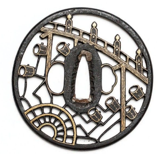

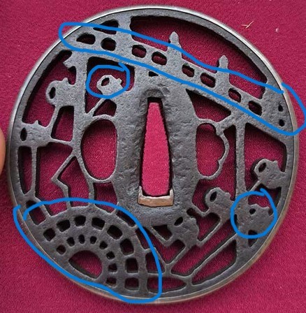

Dan tsuba Posted June 12, 2025 Author Report Posted June 12, 2025 So here are some pictures of some tsuba with the same motif from this forum thread- https://www.militaria.co.za/nmb/topic/52786-silver-ring-in-tsubas/ It looks to me like the first picture shown is a cast iron tsuba and it is not done very welll and shows many inconsistencies (my opinion). Whether the tsuba shown in the first picture here (which I believe is cast iron) was made in the Edo period or not is something that can probably never be determined. But the fact that it has a fukurin on it and sekigane in the nakago-ana is of interest. The other pictures shown are examples from that thread of well made hand forged and hand cut tsuba (also my opinion) with the same motif. Thoughts? Quote
FlorianB Posted June 13, 2025 Report Posted June 13, 2025 I don’t think it’s cast. As I wrote in the other thread my idea is that this Tsuba is just in the state of an intermediate step. The basic form was produced but a final exact execution is missing for what reason ever. Maybe a customer was fond of the blurred design. The second example is of poor quality and the Akasaka-label on the third is nonsense. This Yodo-bridge-design is typical Kyo-Sukashi (or later Daigoro) and the gilding must be a subsequent addition. 3 Quote
Dan tsuba Posted June 13, 2025 Author Report Posted June 13, 2025 Hi Florian, Thanks for your post and your opinions about that tsuba. I get it and understand what you are saying. I quote part of your post below- “I don’t think it’s cast. As I wrote in the other thread my idea is that this Tsuba is just in the state of an intermediate step. The basic form was produced but a final exact execution is missing for what reason ever. Maybe a customer was fond of the blurred design.” I don’t know. It just looks cast iron to me with several discrepancies and inconsistencies (and I am probably wrong). I have included a picture of that tsuba with the discrepancies outlined in blue. Notice the cutouts on the railing of the bridge are of different sizes and shapes. The handles of some of the buckets are of different sizes. The cutouts of the waterwheel are of different sizes and shapes. It just looks to me like this thing was made by pouring cast iron into a mold. If you look at the same motif tsuba included in the other pictures on my previous post (which I believe are hand forged and hand cut), you won’t find those discrepancies. Anyway, I don’t know. This is just my best guess! Quote
Dereks Posted June 13, 2025 Report Posted June 13, 2025 There’s no indication that this is a cast — it’s simply low in quality, that’s all. 1 Quote
Dan tsuba Posted June 13, 2025 Author Report Posted June 13, 2025 Hi Derek! So I believe what you are saying is that this is a low quality tsuba and those discrepancies I noted and outlined in blue in my previous post were hand cut on a hand forged tsuba? Well, I appreciate your opinion. Quote
Brian Posted June 14, 2025 Report Posted June 14, 2025 This is not cast, and your "discrepancies" are nothing to do with casting. Just looking at it carefully will show there are no signs of casting. 1 Quote
FlorianB Posted June 14, 2025 Report Posted June 14, 2025 As I understand the production of sukashi Tsuba the design was at first crudely holed using chisels while in a red hot condition. Drilling was invented not before the 19th cent.. After cooling the plate the holes have had been filed into the final shapes and the plate itself was filed or polished, too. Thus I think this particular tuba is a rare reference material presenting the intermediate as a final result. 1 Quote
Hokke Posted June 14, 2025 Report Posted June 14, 2025 While I am unfamiliar with the casting of iron, I am familiar with casting in general. On the one hand, I can see Dans point of view. He is skeptical that someone would only partially "finish" this tsuba. So many lines on that tsuba are nice and clean, but the holes are clearly crude. The problem with this idea is that if all the other lines of the tsuba are nice and crisp from the casting method, there is no reason why the holes he referenced wouldn't also be nice and clean. One would have to assume that the original mold would have to be poorly cut in order to produce a poor casting. So then the question would be, why would a craftsman go to the trouble of producing such clean lines in some parts of the mold and not others? It seems reasonable to me that what we have here is a an "unfinished" tsuba. Not unfinished as in incomplete, but unfinished with respect to the level of the finishing process. This could have been for a variety of reasons like cost, time, customer request or injury. 1 Quote
ROKUJURO Posted June 14, 2025 Report Posted June 14, 2025 3 hours ago, Hokke said: ...... One would have to assume that the original mold would have to be poorly cut in order to produce a poor casting.... It seems reasonable to me that what we have here is a an "unfinished" tsuba. Not unfinished as in incomplete, but unfinished with respect to the level of the finishing process..... Molds were not cut as it is possible nowadays in die casting. In former times (and in Japan) you needed a model first which was then copied in a mold made from a mixture of clay and fine sand. In a different casting process, a 'positive' wax model was made that remained in a mold. It evaporated as soon as the molten metal was poured into the mold. BELOW: Is this an unfinished painting then? 1 1 Quote
Dan tsuba Posted June 14, 2025 Author Report Posted June 14, 2025 Thanks, Hokke. I agree with you that this tsuba is unfinished. I quote part of your post- “It seems reasonable to me that what we have here is a an "unfinished" tsuba. Not unfinished as in incomplete, but unfinished with respect to the level of the finishing process. This could have been for a variety of reasons like cost, time, customer request or injury.” Although it is my opinion that this is an unfinished cast iron tsuba. Even though there are nice and crisp areas of the cast tsuba that have been filed down, the other areas were not filed or finished. I posted this on Sunday at 12:17 pm (it is on page 19) and is from a dealer in Japan- “When the seam mark was filed off, it is a little difficult to figure out the trick of cast iron tsuba.” For perhaps some of the reasons you mentioned above, the cast iron tsuba was never fully finished. Of course, this is all just my best guess. I don’t think we will ever know for sure if that is a cast iron tsuba or hand forged tsuba. And since you stated in your post that you are unfamiliar with the casting of iron, I found a youtube website that explains how cast iron Japanese kettles are molded and made in the traditional way. It is interesting and is listed below (there are many more videos and websites about this but I just included one)- https://www.youtube.com/watch?v=pqrJC8D3eEs 2 Quote

ROKUJURO Posted June 15, 2025 Report Posted June 15, 2025 Calabrese, of course the ZEN painting is not related to casting techniques! I just referred to the idea of "unfinished". This is possibly only a different concept in our Western brains and does not necessarily correspond to Japanese aesthetics in arts. Leaving things out can make room for thoughts and emotions, while we in the West fill in every corner of an art-work so there remains no space for your own interpretation and imagination (very generally speaking). It is just a different way of seeing and feeling(s), I think. In addition to that, I find it very unreasonable to believe that an 'unfinished' TSUBA was sold/released from a workshop, with clear signs of hammer-work on the SEPPA-DAI (which is a proof that it is not cast!), with mounted SEKI-GANE as a proof of use, would be embellished with a silver FUKURIN. This part of the whole discussion is redundant in my opinion. 2 Quote
Dan tsuba Posted June 15, 2025 Author Report Posted June 15, 2025 Rokujuro, You stated in part of your post that- “In addition to that, I find it very unreasonable to believe that an 'unfinished' TSUBA was sold/released from a workshop, with clear signs of hammer-work on the SEPPA-DAI (which is a proof that it is not cast!),” Well, what you see as hammer marks on the SEPPA-DIA I see as casting flaws created by sand casting. So, your proof that it is not cast may be incorrect. Just a difference of opinions. The only way to know for sure would be to subject the piece to non-invasive metallurgical testing, otherwise everything is just everybody’s best guess. Quote

Dereks Posted June 15, 2025 Report Posted June 15, 2025 5 hours ago, Dan tsuba said: Well, what you see as hammer marks on the SEPPA-DIA I see as casting flaws created by sand casting. So, your proof that it is not cast may be incorrect. You see casting flaws created by sand casting..Seriously? 1 1 Quote
Brian Posted June 15, 2025 Report Posted June 15, 2025 Just go with it....the usual throwing out some wild theory and then saying "prove it isn't" 1 1 1 Quote
Dan tsuba Posted June 15, 2025 Author Report Posted June 15, 2025 Yes Derek, seriously. Let’s review. I have included the picture of what I believe to be a cast iron tsuba. I have also included a picture of a hand forged tsuba with the same motif as the cast iron tsuba (Florian in one of his posts stated it was of poor quality - to me that tsuba appears that it was corroded and maybe a little overcleaned). Now, let us compare the two. The (what I believe to be) a cast iron tsuba shows many tiny pits on the seppa-dai and other places (which I circled in red). You don’t see that same pitting on the hand forged tsuba. I believe those small pits are caused by sand casting. Also, you notice no good or deep tagane-ato punch marks around the nakago-ana of the cast tsuba. That is because if those tagane-ato punch marks were put into the cast iron tsuba (as they are put into the hand forged tsuba) the cast iron tsuba would crack and break. Also notice the area of the water wheel (circled in blue). On the cast iron tsuba the water wheel area (in some places) is not flat. That is because that tsuba was cast. On the hand forged tsuba that area is flat because the entire tsuba was hand hammered flat before carving in the details. Just my opinions. And of course I could be completely wrong. But I have described what I see. Others have their own opinions (and I am certain that they will tell me!). Addendum- If both these tsuba came up for sale (at $150 U.S. or under, which is my limit of spending) I would purchase the tsuba shown in the second picture (the one that there is no question that it is hand forged). 1 Quote
Brian Posted June 15, 2025 Report Posted June 15, 2025 Yeah, you are completely wrong. It's very obvious. Also, you need to learn the difference between hammer marks and "casting pits" which are not present on this tsuba. You also seem to think that designs of tsuba weren't spread across multiple traditions, schools and eras. How are you going to compare a tsuba with a completely different one, like they are supposed to be the same? You also don't seem to know much about tagane and semigane. 2 1 Quote

OceanoNox Posted June 15, 2025 Report Posted June 15, 2025 4 hours ago, Dan tsuba said: On the cast iron tsuba the water wheel area (in some places) is not flat. That is because that tsuba was cast. Dan, the first photo in the original topic about that tsuba shows that area is flat. Why would a non-flat area be indicative of casting? Quote
Dan tsuba Posted June 15, 2025 Author Report Posted June 15, 2025 Hi OceanoNox, Well, as can be seen in the pictures on one of my previous posts that area of the water wheel is not completely flat. Why would a hand forged tsuba not be flat in that area as all the other hand forged tsuba with that motif shown in a previous post are flat? That was another indicator to me that the tsuba could be of cast iron. Anyway, still trying to recover from our Administrator's previous post belittling me. I am not as fast to recover from those insults as I used to be! It is easy for people to state insults. And it is easy to state opinions, but much more difficult to back those opinions up with pictures, references, or weblinks. Only a very few contributors to this thread have ever stated their references and or shown pictures and or weblinks to information. Anyway, personally, for today I have had enough of this forum! Quote
OceanoNox Posted June 16, 2025 Report Posted June 16, 2025 14 hours ago, Dan tsuba said: Well, as can be seen in the pictures on one of my previous posts that area of the water wheel is not completely flat. Why would a hand forged tsuba not be flat in that area as all the other hand forged tsuba with that motif shown in a previous post are flat? That was another indicator to me that the tsuba could be of cast iron. The original picture shows roughness, which is very easily attributed to rough forging, rather than casting. If anything, casting a liquid metal might leave a flatter surface, albeit with maybe a sand-like appearance. But, I may have mentioned this somewhere in the 20 pages here, and I am certainly not the only one: we cannot judge if a tsuba is cast iron from photos alone. 4 Quote
