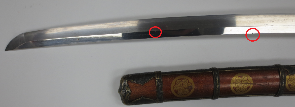

My question concerns Kirikomi.
I have a sword (ito maki no-tachi) (currently in storage at an auction house awaiting delivery) which has  one kirikomi in the mune and one in the shinogi. I've already researched whether this devalues the sword (I think it does) , so my question  is this - can a good sword polisher disguise them?
It might sound like a very basic question to many of you, however the sword is out of polish but to my untrained eye worthy of restoring, if only for my own delight. I like it enough to consider the expense. The blade is signed Bizen No Suke Muentsugu.
My understanding of any polishing process, is that it removes material. I've often seen it stated that a good polisher can remove some nicks to a blades edge, but I don't see how without reprofiling the blade completely. Clearly I have much to learn, hence asking the question.
I understand there are no 'fully qualified' polishers in the uk, however this blade may not be worth a trip to Japan so decisions and discussion will ensue.
The damage:

True kirikomi absolutely do not devalue a blade. They are not a flaw like a ware, for example. They are part of a blade's history. Some collectors simply do not like them all that much for personal / aesthetic reasons. But my personal opinion is that a kirikomi should not be polished out. Doing so would require way too much change to the geometry of the sword. It would be a mistake. It would be better to pass the sword on to a collector that enjoys kirikomi and find a more pristine blade if that's your style.

Kirikomi are generally not polished out, they are regarded as "honorable scars" and part of the swords history, and actually no they don't generally devalue a blade. It is unlikely they would successfully polish out, it would involve removing too much material. With your sword there is very little to worry about. I have just bought a sword with three kirikomi of a similar size to the ones you have illustrated and don't consider them a problem, far from it.

And a good polisher will know how much material will need to be removed to get rid of the kirikomi and advise you accordingly… let their trained advice be your guide.
I saw a blade with a kirikomi that had a piece of the blade that stuck this sword. There is no way that I would remove that kirikomi. I agree with the above comments on keeping them and if you can't live with them pass the blade on to someone who would be happy to have a battle tested blade.

Those that are plausibly from battle (in areas feasible to be used to block) don't reduce value to much, and I would leave them in place. Yours, I would leave as is if it were mine. Rest of the sword looks good.

Pretty much what everyone else has said. Kirikomi don't really devalue a blade and for many collectors having a battle-tested blade enhances the pleasure of ownership. Those on your blade are not out of keeping with being caused by deflecting a blade during a fight and I would think of them as enhancing its collectability rather than the reducing it, though I think it may be possible to have too much of a good thing:

As I already suspected, the geometry of the blade would be altered significantly, therefore they simply stay as they are.
The blade hasn't been well cared for and does require a polish. Now I will be needing the advice of a UK polisher before deciding which route to take.
