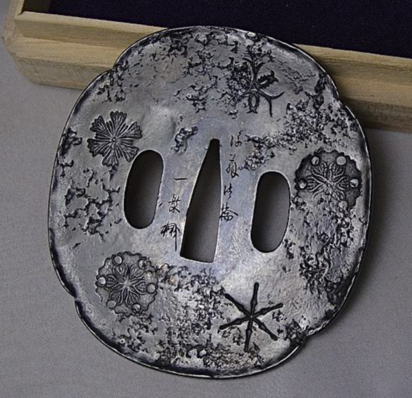

Stephen Posted July 12, 2018 Report Posted July 12, 2018 Great news!! Reread but missed where it was repatinaed...would you tell what im missing? Quote

Timur Posted July 12, 2018 Author Report Posted July 12, 2018 Great news!! Reread but missed where it was repatinaed...would you tell what im missing? Stephen, no repatination involved. Just the first photos were from the seller - the tsuba had silver look, but it was just a trick of shakudo getting light from different angles. Quote

terminus Posted November 2, 2020 Report Posted November 2, 2020 Maybe this has been answered before, are the Ichijo snow flake tsubas stamps? or engravings? And what's the story behinds them? Quote
Ford Hallam Posted November 2, 2020 Report Posted November 2, 2020 Hi Tony The patterns are stamped into the tsuba ground. Not sure what the story might be but there was in the little woodblock book published in 1832 that illustrated the varieties of snowflake patterns. Sekkazusetsu or 'Illustrations of snow flowers' was a record made by a Daimyo (Doi Toshitsura, Daimyo of Hitachi Province), he'd imported a microscope from Holland and spent 20 years sitting in the snow in winter studying snowflakes and recording their shapes. Snowflakes had not been seen so clearly before and their beauty and novelty made them and immediate hit with designers and the culturally trendy of the urban centres. 3 Quote
masakatsu Posted November 2, 2020 Report Posted November 2, 2020 Another example for your viewing pleasure... 4 1 Quote
terminus Posted November 3, 2020 Report Posted November 3, 2020 On 11/2/2020 at 3:49 AM, Ford Hallam said: Hi Tony The patterns are stamped into the tsuba ground. Not sure what the story might be but there was in the little woodblock book published in 1832 that illustrated the varieties of snowflake patterns. Sekkazusetsu or 'Illustrations of snow flowers' was a record made by a Daimyo (Doi Toshitsura, Daimyo of Hitachi Province), he'd imported a microscope from Holland and spent 20 years sitting in the snow in winter studying snowflakes and recording their shapes. Snowflakes had not been seen so clearly before and their beauty and novelty made them and immediate hit with designers and the culturally trendy of the urban centres. Aww, thanks Ford. That makes a lot of sense and I was wondering if these tsubas had any relation to Doi Toshitsura. I remember that example Matt! I especially like yours since the snowflake stamps are imprinted on gold inlay. Quote
