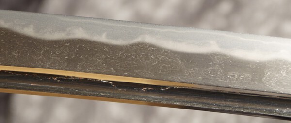

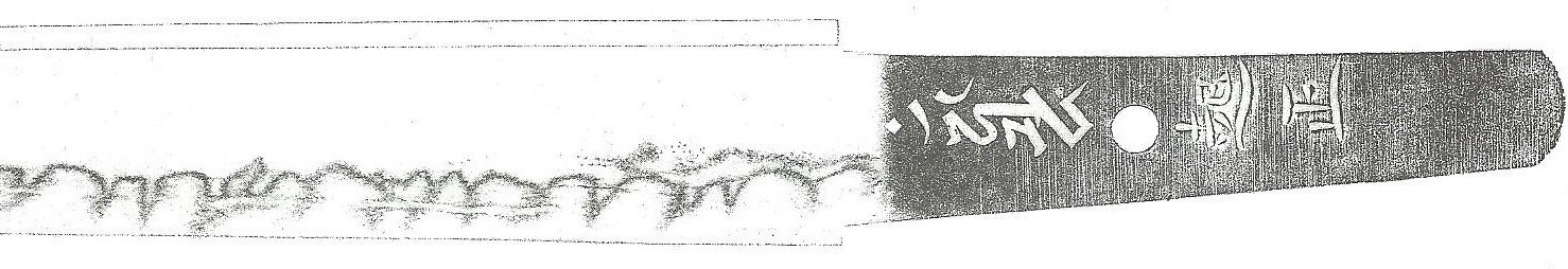

george trotter Posted January 1, 2021 Report Posted January 1, 2021 Hi all, Happy New Year. I know you are all already bored with 2021 so I thought I'd ask a question. Here is a pic of what I have always thought was sunagashi (sand lines)...not kinsuji or inazuma BUT, here is a drawing of almost the same feature but called imozuru (potato vines )- from Markus Sesko: Kantei & Hamon & Boshi #1. After all these years I must confess I am now not sure what to call it...I have probably been wrong for years (wouldn't be the first time)...would any of our learned members like to comment on: 1. Sunagashi 2 .Kinsuji 3. Inazuma 4.Imozuru Thanks... Quote

george trotter Posted January 1, 2021 Author Report Posted January 1, 2021 Thanks for your comments all. The line shown here in my hamon is "white". It is by Tsukamoto Masakazu 1942 who learned from his brother Tsukamoto Okimasa (who also made these lines called sunagashi in oshigata shown) who was the student of Kasama Shigetsugu who also made these lines (not named in oshigata shown). both oshi from Tokuno "Nihonto Zukan" pp.167, 171. My hamon lines here are about 5 inches long and another "milder" section appears up the blade in the mono-uchi. To me, and I agree with what Paul says, these just have always been sunagashi, but when I see virtually identical features in books/sites being called by other names it makes me "wonder" how accurate I am. I hope I'm not speaking too soon, but I think I will stay with sunagashi...but always willing to hear new ideas. Regards, 1 Quote

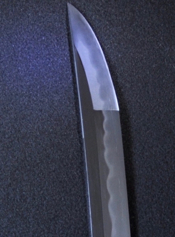

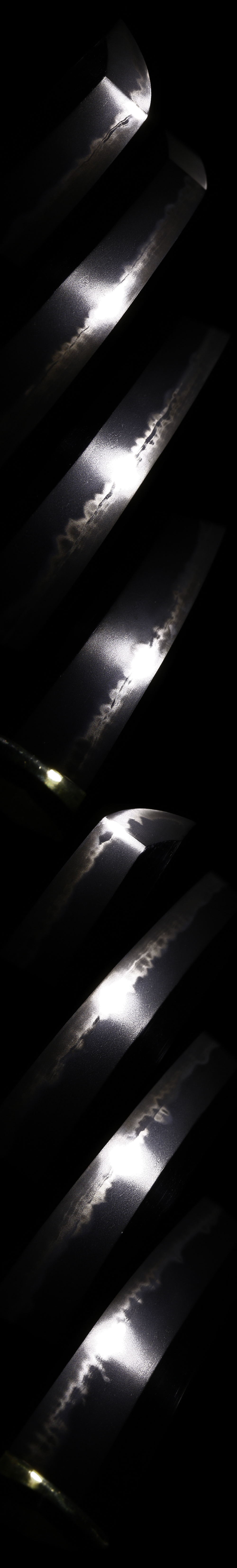

Bryce Posted January 1, 2021 Report Posted January 1, 2021 G'day Guys, What about these examples? The first I would call sunagashi, but the second which occurs in more discrete lines I would call kinsuji, even though there are several running parallel to each other? Cheers, Bryce 2 Quote
16k Posted January 2, 2021 Report Posted January 2, 2021 I would call them like you. However, if we follow Michael's rules, the second would be sunagashi. As I said earlier, for me, sunagashi are like sand dunes or ripples near a shore. They are white, There are several of them usually close together (though a single white line is a sunagashi for me too). On the second sword, they are further apart and black. They would be Kinsuji for me. The same type of line starting in the ji and crossing through the Hamon would be an inazuma for me. ohhh! Potato, poteitoo, my head hurts! 1 Quote

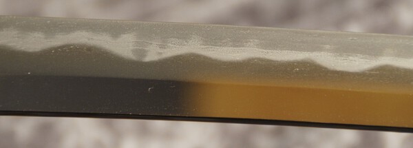

Andi B. Posted January 2, 2021 Report Posted January 2, 2021 Ok, that's what I think is sunagashi: 1 Quote
16k Posted January 2, 2021 Report Posted January 2, 2021 1 hour ago, Andi B. said: Ok, that's what I think is sunagashi: That’s what I call it too. I also see chikei and ji nie 1 Quote

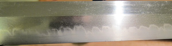

sabiji Posted January 11, 2021 Report Posted January 11, 2021 Tanto in Sanmai-Konstruction. Looks quite natural. Image is from USAGIYA. 1 Quote
16k Posted January 11, 2021 Report Posted January 11, 2021 It is something you can see a lot in modern sanmai Chinese replica. Quote
DoTanuki yokai Posted January 11, 2021 Report Posted January 11, 2021 Ok, this Blade is sanmei and I think the hamon feels like there is a border inside where the parts connect. 2 Quote
