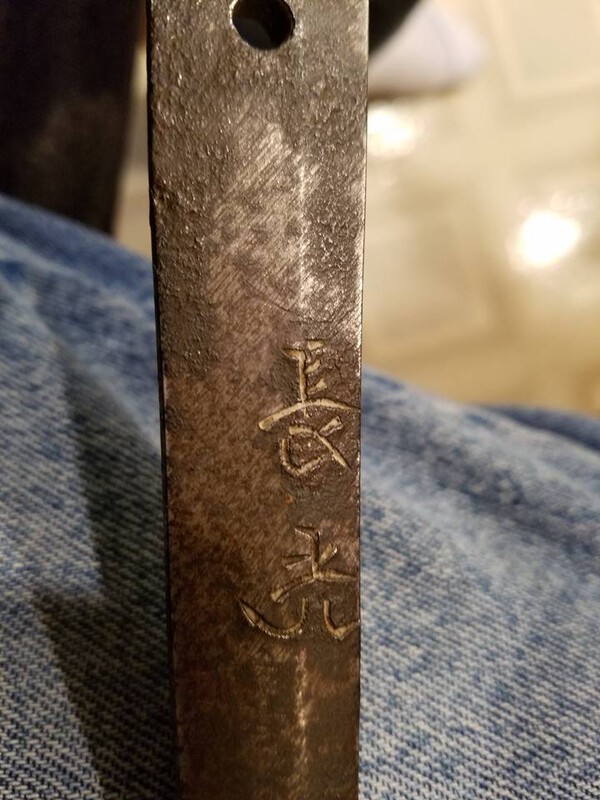

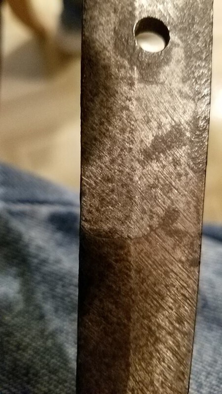

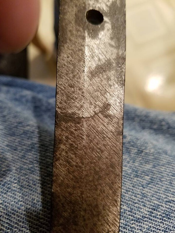

lonely panet Posted September 8, 2017 Report Posted September 8, 2017 look hard at he nakago guys, this is a low end nagamitsu, as it appears to have a lower quality metal attached below the mekugi ana (cant recall the correct term as I am living on no sleep). this is a cost saving measure to save tamahagane during the wartime. Joe is correct with every point. just look at the kissaki!! its shape is horrible. iv seen high end showa seki blades that would almost surpass in every aspect, evan in the hada hahahahha 2 Quote

lonely panet Posted September 20, 2017 Report Posted September 20, 2017 heres another nagamitsu from the past with the same style cost saving of materials in the nakago Quote
