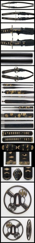

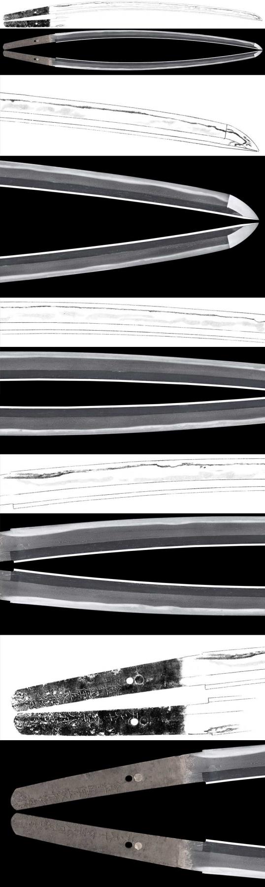

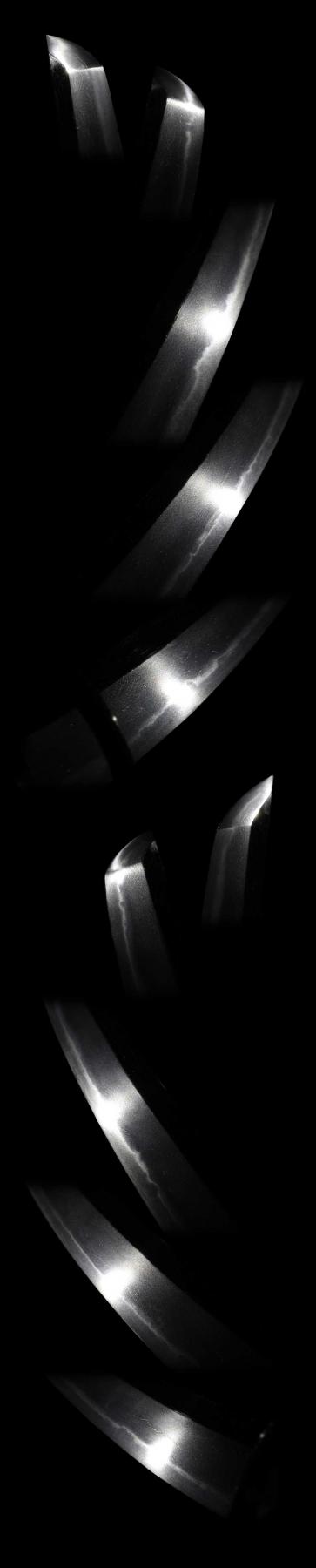

Marius G Posted July 29, 2016 Report Posted July 29, 2016 Hello, I am a novice collector and recently purchased the Katana in the photos attached below. I would like to know if it is a mass produced sword or it has much more merit?! Signature : Bizen koku Ju Osafune Sukesada SakuTenbun 16 nen 8 gatsu kijijitsu (August 1547) Blade length : 65.2 cm or 25.67 inches.Sori : 2.4 cm or 0.94 inches.Width at the hamachi : 2.93 cm or 1.15 inches.Width at the Kissaki : 1.77 cm or 0.70 inches.Kasane : 0.63 cm or 0.25 inches. Regards, Marius Quote
christianmalterre Posted July 29, 2016 Report Posted July 29, 2016 you definitely did buy you a nice Tsuba here in this set! ! Christian 1 Quote
Brian Posted July 29, 2016 Report Posted July 29, 2016 You want to know if it is a kazuuchimono? It has papers, it is from a decent dealer, it is in good polish, the workmanship looks decent. No major flaws. It has nice koshirae. I wouldn't worry too much 1 Quote
Ray Singer Posted July 29, 2016 Report Posted July 29, 2016 Although Nakahara does not buy into the idea that the length of signature in Sue-Bizen has a relationship to whether it is a kazuuchimono or not, my experience is that in daito from mid-to-later 1500s a long signature like yours [bizen (no) Kuni Ju Osafune Sukesada Saku + Date] indicates a better quality sword. Best regards, Ray 2 Quote
Marius G Posted July 29, 2016 Author Report Posted July 29, 2016 Thank you for your comments! I actually love this blade as it has a deep sori and looks almost like a smaller Tachi (at least in my eyes). And the Koshirae is very nice as well. I assume it is a katate-uchi Katana (or katate-Uchigatana), right?! 1 Quote

Marius G Posted July 29, 2016 Author Report Posted July 29, 2016 Oh and PS: I think you did fine on this sword depending on how much it cost obviously. It's a nice sword. Thank you very much for your message and photo! Yes, I got my sword from Aoi Art, and I recognize the gentleman in the photo from the photos I have seen on Aoi website. I somehow guessed he is the owner/ manager of the shop, but I didn't know what is name was. Now I know! And, yes, I am pretty sure it is a nice sword, and now I know it is not a mass produced sword but a very carefully produced one. Quote

lonely panet Posted July 29, 2016 Report Posted July 29, 2016 hi Marius, with out jumping the line, there are some easy pointer to IDing bundle swords. they normally arnt dated, takes to much time the mei is short, either bishu or bishu ju and the pics arnt good, but look at the work, is the hada course with openings or evan and visable I should edit that abit, this is strickly within the sengoku period, due to the need for arming ashigaru, swords were made quickly and cheaply compared to other periods. but they are still fine weapons. Hey Joe, IS his shop small and crowed or what. he can really fit some stuff in a small place 1 Quote
Marius G Posted July 29, 2016 Author Report Posted July 29, 2016 hi Marius, with out jumping the line, there are some easy pointer to IDing bundle swords. they normally arnt dated, takes to much time the mei is short, either bishu or bishu ju and the pics arnt good, but look at the work, is the hada course with openings or evan and visable Hey Joe, IS his shop small and crowed or what. he can really fit some stuff in a small place Thank you very much! Now I begin to understand! Of course if one is concerned only about producing more swords, won't want to waste too much time inscribing a long and detailed signature, then waste even more time inscribing a date... And yes, the hada is very, very fine on my sword. Hardly visible with the naked eye. Surely it took a lot of time and many foldings to come up like this. Thank you again for this short, concise and very welcomed lesson! Have a nice weekend! Quote

Chango Posted July 30, 2016 Report Posted July 30, 2016 I assume it is a katate-uchi Katana (or katate-Uchigatana), right?! A bit too late and too big for a "katate-uchi"; such swords fell out of favor by the early 1530s and had shorter nagasa and nakago/tsuka for strictly 1-handed use Just plain "uchigatana"... not a bad sword though! 1 Quote

mywei Posted July 30, 2016 Report Posted July 30, 2016 Yes - his shop is ridiculously small and very cluttered. Must be one of the highest areas of nihonto density per square metre in the world! Nice package overall. I quite like the kogai and kozuka as well. 1 Quote
Greg F Posted July 30, 2016 Report Posted July 30, 2016 Congratulations on the new sword, especially if it's your first. Koshirae looks good. I like the tsuba. Cheers. Greg 1 Quote

Alex A Posted July 30, 2016 Report Posted July 30, 2016 . And yes, the hada is very, very fine on my sword. Hardly visible with the naked eye. You have answered your own question, according to Connoisseurs, look for rough masame hada in kazuuchi-mono. 1 Quote
Marius G Posted July 30, 2016 Author Report Posted July 30, 2016 You have answered your own question, according to Connoisseurs, look for rough masame hada in kazuuchi-mono. Yes, I think I got the idea! Thank you! Quote

Marius G Posted July 31, 2016 Author Report Posted July 31, 2016 What I can tell you is that the sword is sufficiently light to be comfortably handled with one hand, that's why I thought it may be a katate-uchi. Quote
Alex A Posted July 31, 2016 Report Posted July 31, 2016 We can look at the sword and maybe speculate a little, its possible it was used one handed. There would have been times on a battlefield when two hands on a sword are better than one, blocking an heavy blow for instance, or when fatigue begins to kick in, hence why your sword may have a long nakago and why during those times many nakago of katate-uchigatana were machi-okuri (blade slightly shortened to increase tsuka length). Its been mentioned before, but there is a notion that these days stuff like this gets overthought Quote
Jussi Ekholm Posted July 31, 2016 Report Posted July 31, 2016 I wouldn't get too caught up on terminology. Couple cm either way does not change the sword much and there are no exactly set limits what seems to be called katate-uchi and what is bit over that limit. Longer swords for two handed use (morote-uchi) usually started coming back and trending during Eiroku -> onwards but of course there can be longer examples even at the heart of katate-uchi era. Spears & rifles were just so much more useful than swords in warfare. Tenbun is mentioned usually as an era when swords gradually started getting slightly bigger again. Sources for that information are NBTHK and Tokyo National Museum. Quote
lonely panet Posted July 31, 2016 Report Posted July 31, 2016 my understanding was/is that most bizen katate-uhi are saki-zori, this looks more tori-zori. Like Jussi mentioned by or after tenbun (1530s) size started to move to a larger nagasa. But iv noticed that quality on the whole dropped off as a average. does any agree? This piece looks(poor photos) to be well above the standard for the time and for the normal Sukesada. regards h Quote
