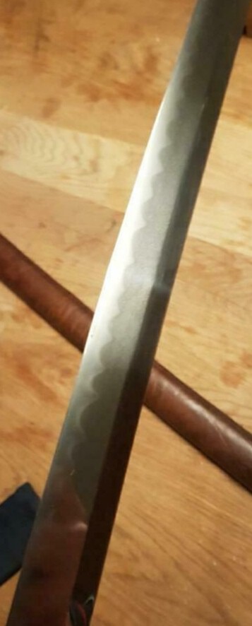

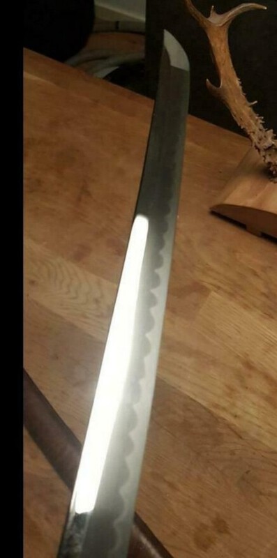

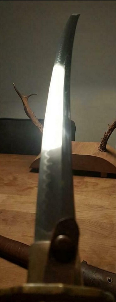

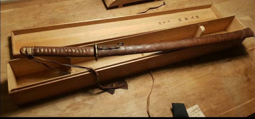

Hello, can you please tell me if this is an original sword? And if it is possible help to translate what is written on the box and two pieces of rag? Did Mantetsu have such a hamon?

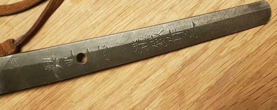

Alex, get both the serial number on the back and a photo of the date. If they don’t lineup correctly we know it’s a fake. However, I’ve seen two of these and they had an appropriate serial number for the year. So if they are fakes, they’re smart enough to know how to date them to match the serial number. But let’s try to find out shall we?

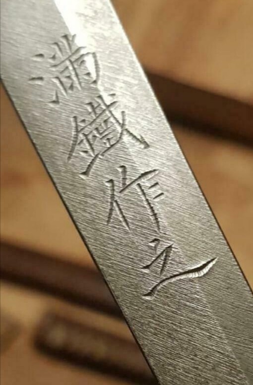

This is the fourth one I’ve seen now, but it is a bit unique with the “Ren” stamp.  I will have to check my records but I’m pretty darn sure that there are no Ren stamps on Koa Isshin blades.  I am on the road, but will check when I get home. They may have finally made a fatal mistake. Plus, the Ren stamp looks hand chiseled and not a stamp at all. It should be a stamp.
日本刀一振南満州鉄道株式会社
所有主 阿部文雄
Nihontō hitofuri Minami Manshū Tetsudō Kabushikikaisha
Shoyūnushi Abe Fumio
Japanese sword (one) South Manchurian Railway Corporation
Owner: Fumio ABE
The cloth tags also belong to Fumio Abe, and give his address and the name of a neighborhood association (presumably near where he lived). The address is Motobuto in Urawa (close to Tokyo). Urawa is a fairly major town. The section of Motobuto is still there, but the address system changed, so you'd have to find an old map to pinpoint the location.

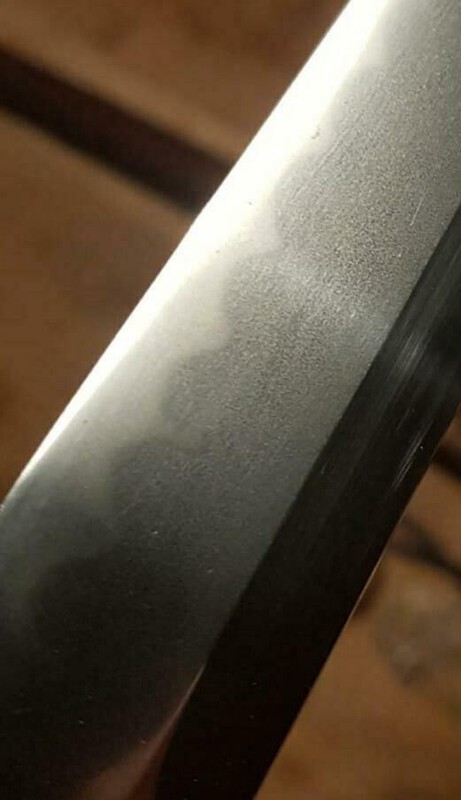

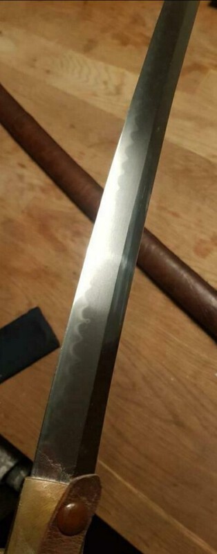

Please tell whoever it is with the sword to wipe the blade where he is holding it in your 2nd to last picture.  Acid in his sweat is slowly but surely etching his fingerprints into the surface.  Never touch the polished portion of the blade.
Good afternoon Bruce. The katana is signed on one side of the nakago. There are no marks on the back on top of the blade. And this already separates the subject from the original
The owner says that the sword was bought at an auction in Japan. I had doubts about the originality of this sword. If it is a fake, then it is of very good quality.
There is no doubt in my mind this is a fake. This group takes original Gunto and adds various Mei of valuable smiths and makers, they come up for auction on Yahoo.jp very often.

A very well made fake Mantetsu. As i looked on it i thought wow. But the mukden stamp is missing and mukden was engraved. If you look on the place and signature engraving  the place and size is not correct. And the whole shape of the sword is not that a mantetsu should look like. I see this now after reading the topic! And this is what i learned.

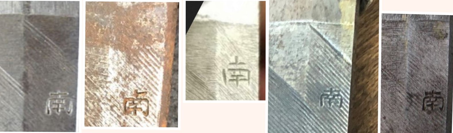

Yeah, I have to back-track on my statement about them normally being stamped.  I've surveyed the 22 Nan's and while they are done so well that from a glance, they look stamped, the are actually chiseled (or whatever tool they do that with) in.  Here is a comparison.  The fake is in the center.  Can't say and "always" on this, but the legit ones seem to cut the side lines bottom-up so the pointy end joins at the "shoulder" giving it a rounded look.  The fake started at the top of the shoulders.
Also, the file lines on the legit blades seem fatter.
I have 5 of these (6 now) on file, all dated: 1940, 1941x2, 1942, 1944.  The '44 has no serial number either.  One has a Colonel attribution, and one a Lt Gen.  We've previously done a "kantei" on these fakes and are bothered by the mei differences (though all quite close).  And like I mentioned earlier, NONE of our Nan-stamped blades are Koa Isshin.  I'm adding this one to the file.  Who knows, someday we may find a document or letter describing their custom Mantetsu.  But until then, the scales tilt toward fakery.
I'm not 100% comfortable calling this fake. We know there are good fakes of everything out there. But we don't have any decent proof of this one.
Still...the hamon is odd, and likely not made as he others were. That hamon says Showato to me. So really not sure either way.
I wish we had someone that knew these boxes.  Might run the box and cloth by Nick to see what he thinks.  The cloth, to me, looks like it has age.  He's commented on authenticity of items like this before.
It is a real WWII Showato.....with a fake Mei.

I've posted the box and cloth over on Warrelics.  Let's see if anyone has any thoughts on them, either way.

and IMHO quite a nice item in itself. So I would like to ask why bother going to all that trouble and expense to add the box (Which I think is also nice), the cloths and the Mei.
