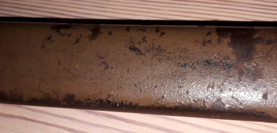

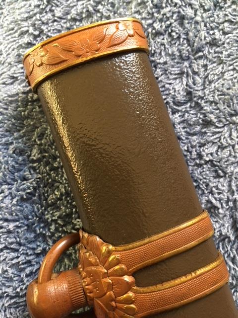

post-3496-0-24839700-1544917336_thumb.jpg post-3496-0-74116900-1544914769_thumb.jpgpost-3496-0-71142400-1544914784_thumb.jpg

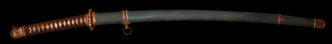

This photo i made some hours ago with flash. It looks better in real light.

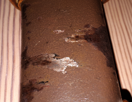

post-3496-0-67366400-1544914472_thumb.jpg post-3496-0-81885900-1544917015_thumb.jpg
