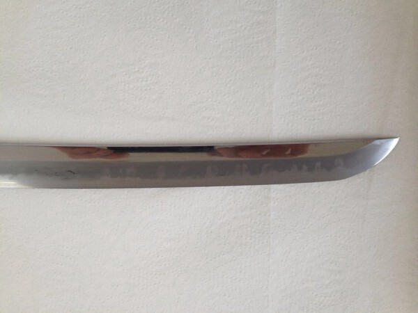

Hello everybody i am from Holland and hoped that somebody could give me some info about a short antique wakizashi?
I like to get some info if it is possible about who made the sword?
And when is it made?
And what kind of crazywild hamon is this?
A while ago i bought an old short wakizashi with a nice old and signed tang onthe sword.
The total length is 51 cm.
The cuttig edge is 38,5 cm
The edge thicknes is 0,6 cm.
And the edge widenes is 2,7 cm.

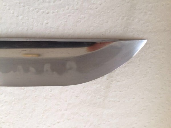

My friend is polishing swords for some years now and i brought him the blade to show his polishing skills.
After a week he phoned me up and told me that it might be a n important blade because he had never seen such a wild and misty kristal hamon in his life.
He did not know what kind of hamon this was.
So maybe someone can tell me something about this mystery blade?
The seller thought it might be made around 1500 and he called it a Magoroku blade or signature.
I did not understand it very well that's why i am asking the expert here.
Thanks for everyone who wants to help me out!!
The pictures may be a bit different from each other because you see some different polishing stages.
And it is not finished yet.
I will post the final pictures when i have received my waki from him.
Can't wait hehe

Hello sir i have contact my polisher today and told him your opinion.
He agreed with it and has stopped the polishing project.
He did not remove a lot of the sword sir.
He was polishing with the uchigumori do stone.
And he made some slurry with this stone together with the mikawa nagura stone.
He made the slurry very very fine so there didn't come any scratches in the blade at all sir.
But now you can clearly see the hamon on the blade sir.
And there is a lot more to see like an almost silver foggy temperline sir.
And on the tops of the peaks you see very nice kristals everywhere.
But it is almost not possible to take a picture and show it sir.
Because what you see is not 50% of the beauty of the blade sir.
Thank you for your opinion and inwill let an expert look at it sir.
I have got some extra pictures of my polishing friend to show you the blade.
I'll hope this will help trying to find out who made it.
Thanks everybody for helping me.
Geoffry.

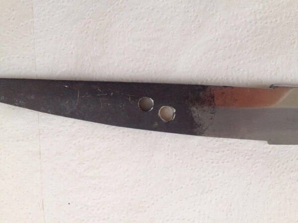

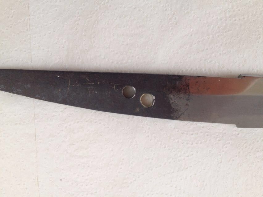

Magoroku (孫六) usually refers to a smith whose "family" or professional name was Kanemoto (兼元) from the old province of Mino, in the town of Seki.
There is something that looks like "roku" (六) at the bottom of the tang, so I can see why your friend might think of Magoroku. Unfortunately the signature is too obscured to say with any certainty whether this is Magoroku or not. Personally, I have my doubts. I don't know if there are any Kanemoto/Magoroku swords in existence with just a three-signature name on them, and the kanji on this sword seem very lightly etched into the steel rather than carved. What you really want to do, though, is look at the sword itself and see if the sword's traits match with those of Kanemoto/Magoroku. There are some reference materials on this site to browse through, and if you get creative with your search engine you should be able to find samples of Magoroku swords on the internet.
http://nihontoclub.com/view/smiths/meisearch?type=swordsmith_record&mei_op=contains&mei=Magoroku
Note: There is today a commercial manufacturer of high-grade knives in Japan called "Seki Magoroku" 関孫六, so any search inevitably pulls up a lot of references to this modern factory.

Stephen there is no crack in the blade at all.
It looks like a crack but it is something like a black vain or something.

Hello Geoffry, I thought there was a crack or something strange as well, is there any line or anything on other side of nakago? I hope you show us the blade when its polished I think it has good potential. Its good your friend ceased work on the blade and didnt disagree on a professional taking over. All the best.
Greg
