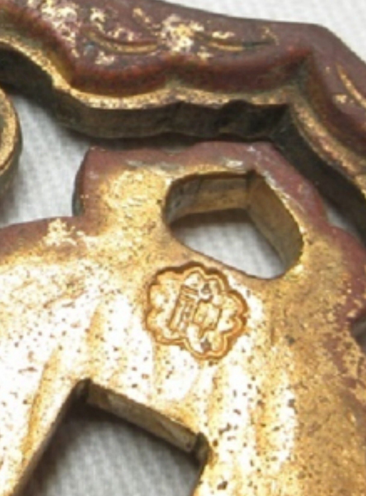

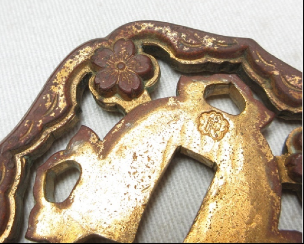

Bruce,
I think that is the first kanji of the name KOBE. There was a sword merchant shop in Yotsuya, Tokyo, owned by Kobe Kazuyuki (not sure of the personal name reading). The kanji KO is the same as the kanji inside your stamp.
I'm sorry that my scanner isn't working or I'd copy their article/advert from the 1942 book "Dai Nihon Token Shoko Meikan" pp.86-87. The shop advert does not show your stamp as a logo, but who knows.
If someone has this book maybe they can post it here for you, with a few words of explanation. While the shop name's first kanji is the same as your stamp, it does not guarantee that your stamp is their trademark, but maybe yes....
Regards.

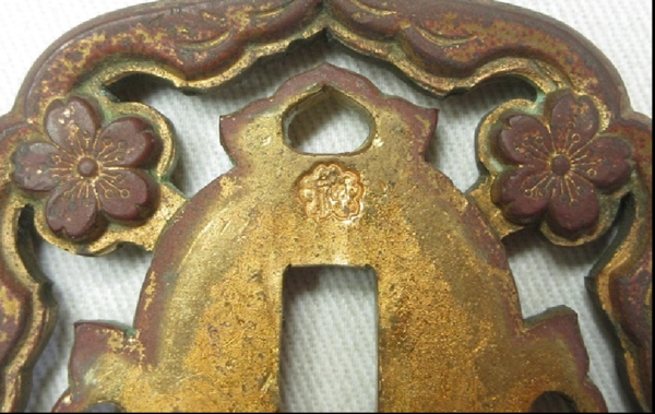

On 12/11/2022 at 1:18 PM, BANGBANGSAN said:
That's one version mark of 神户商店(Kobe Shoten),yes ,the one making Type 95 fitting. Here are some photos of the mark they used on Gunto.
Trystan,
I'm working up a section in the Stamps Doc for these Kobe stamps.  So, to be clear, you believe all 3 of these to be from Kobe Shoten?  Adding to my problem, in my head, is the "K" in sakura and, what we believe, the "Ichi" in sakura.  Are we saying that these 2 are also of Kobe Shoten?  And my final issue is of the "S" in diamond of Kobe Steel Works ...... same company?  If all the same, or related, I'll put them all together in their own section.

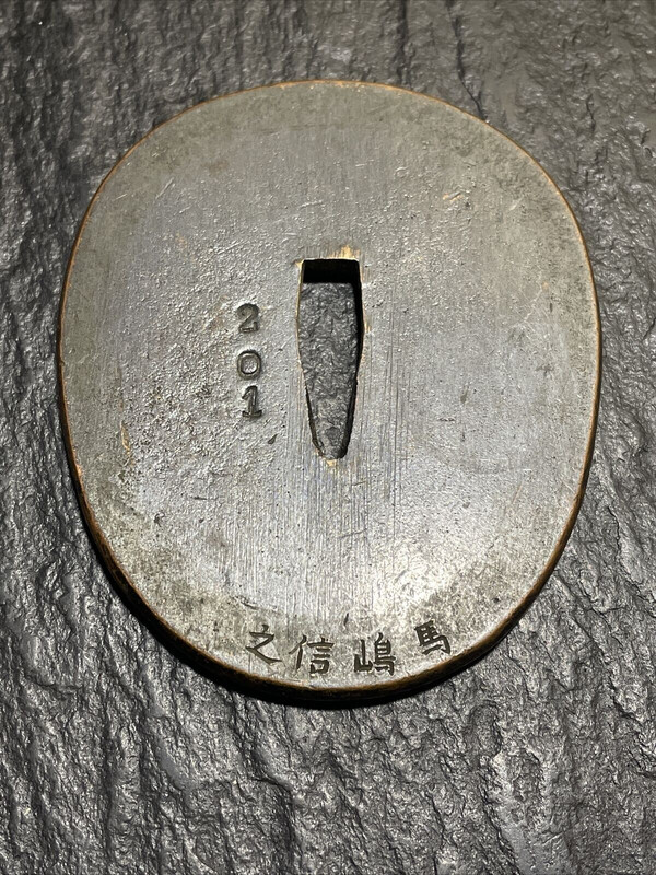

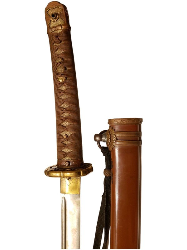

Here's another strange one, i assume it was respectfully made by (a Navy Koshirae maker??)
Does it read from right to left??
It doesn't look like it would be for a Rinji Spec sword (Type 100 / 0 / 3 / Pattern 44 / NLF  etc etc), as there is no provision for a locking latch. More likely for a Type 97 IMO.
I can't read it and am hoping one of you guys could give a translation.
Thanks!
3 hours ago, Bruce Pennington said:
Trystan,
Kobe Seikōsho still there today. https://ja.m.wikipedia.org/wiki/神戸製鋼所
Kobe and IKKO
神戸一幸 as it says on Trystan’s ad.
I see enough of “K, S and I” there already to tie these together. Would need double-checking though. :)
10 hours ago, Stegel said:
Does it read from right to left? I can't read it and am hoping one of you guys could give a translation.
The characters 馬嶋信之 read from right to left.  This very same tsuba came up recently via @John C.  Just a thought, based upon the placement of the characters, it could be the owner's name.
Tsuba mei translation
Tactfully done, Thomas.  You could have said “Bruce, please stop trying to translate things!” Ha!

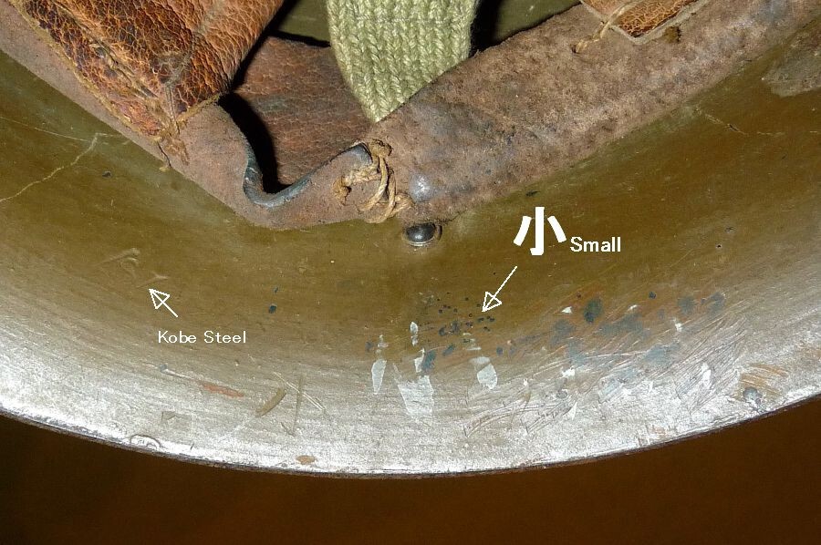

14 hours ago, Bruce Pennington said:
Trystan,
神户製鋼所 is one of the factory who make Type 90 helmets

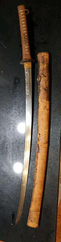

Just wanted to add my Nagamitsu RJT Type 3 for the records! (If anyone can translate the wooden tag that would be fantastic!)
#2352
Ichi-Ryu-Shi-Saku Mei
26 & 1/4”inches Guard to Tip
38 & 1/2” inches overall w/ Scabbard
7mm Thick Mune
30.22mm Wide at the base, 23.78mm wide at center, 20.32mm at the Yokote.
45mm from the Tip to Yokote.
Previously I thought the stamp was Noshu Nihonto Tanrenio, but I realize now it is not.

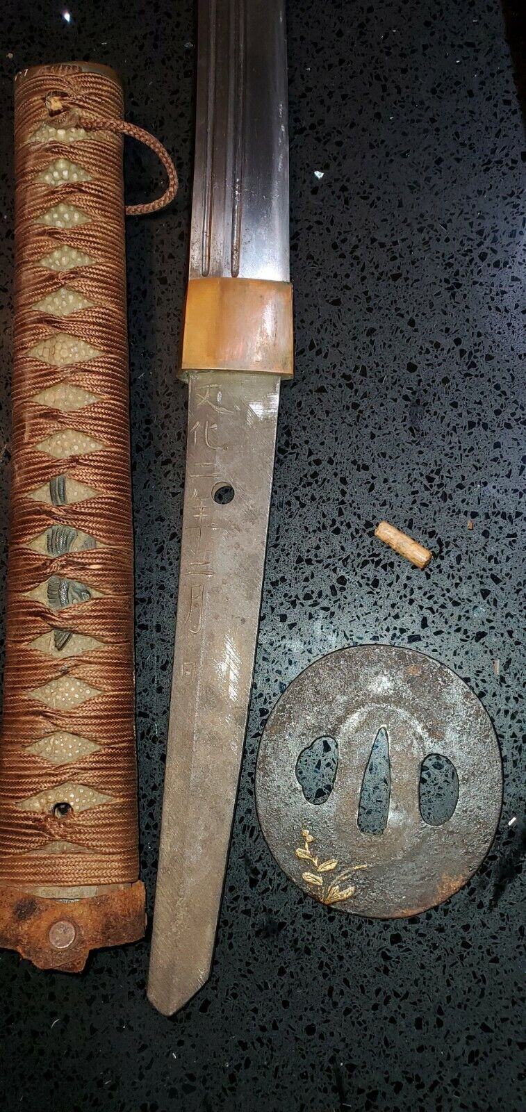

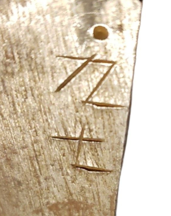

On 11/16/2022 at 8:15 PM, robinalexander said:
Hi Thomas, blade number 4042.  No other marking on tang or mune.
十五 so you think it could be 15 ?
I have no idea at all but I will throw this is  just in case it means something to someone .... 10 + No/Yuki ?
Rob
On 11/16/2022 at 10:21 PM, Stegel said:
It's a shame the mounting hole is so close, so as to make ID harder.
I have an early type 95 with these stamps instead of the W,  and also, some similar scratched numbers on the tang.
