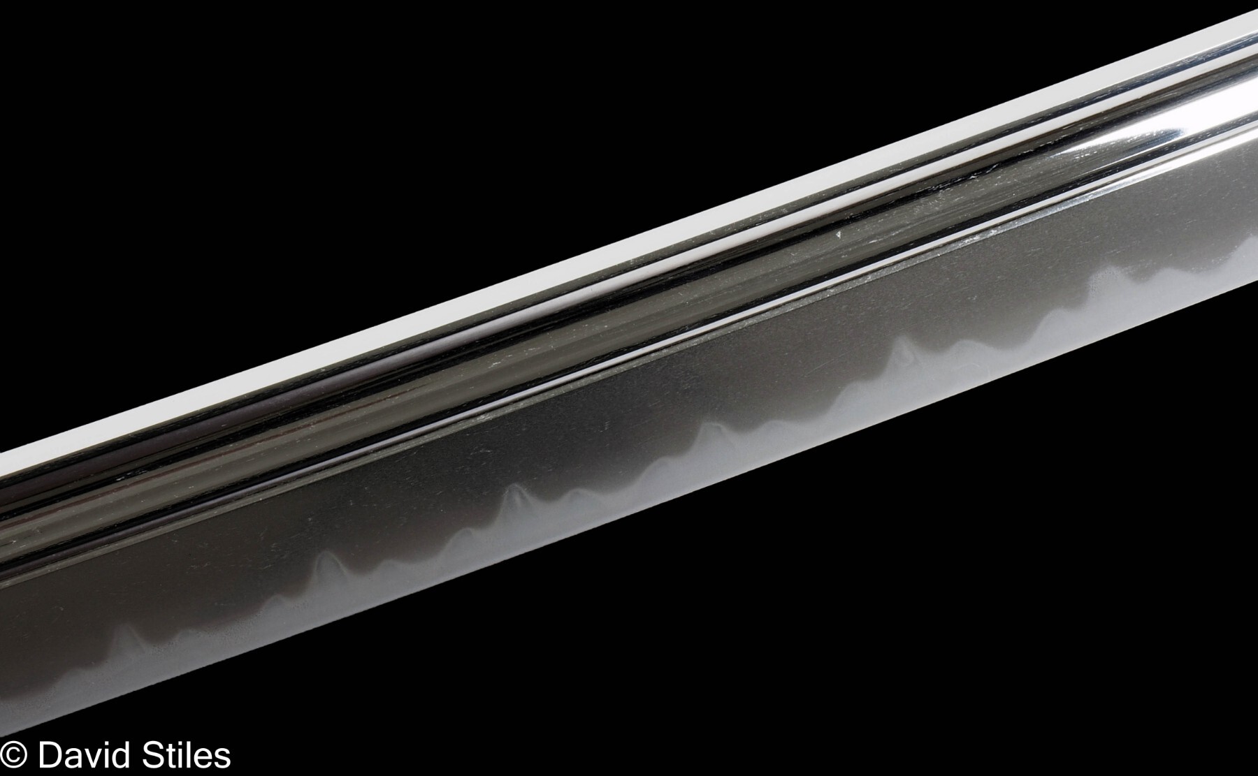

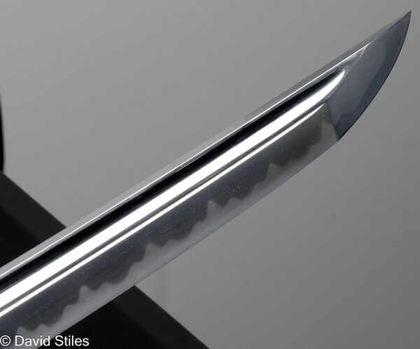

I wanted to update this quite old thread from 2021. @John A Stuart and @Rich S made some good points above. I had a new art polished done on this sword (see photo below). It will be entering the NTHK shinsa on Saturday afternoon at the Orlando Show. Wish me luck. :glee:
  • Like 6
  • Love 3
Good Luck!!
Please share the results!!!
Here is the worksheet result of the NTHK shinsa and the sword passed. This is the unofficial attribution a later generation of Kanemoto of Mino Provience (後代兼元 美濃) circa Tenshō (天正) Era from July 1573 through December 1592. This would mean the sword was likely the work of the 3rd Kanemoto also known as the 2rd Magoroku master. What is official is what will be written on the final Kanteisho. He would have been the student of this swordsmith artist: Kanemoto - KAN1570 | Nihonto Club.  I talked to @Ray Singer before and after the shinsa and he was accurate on his call that it would pass and the details of the attribution.
