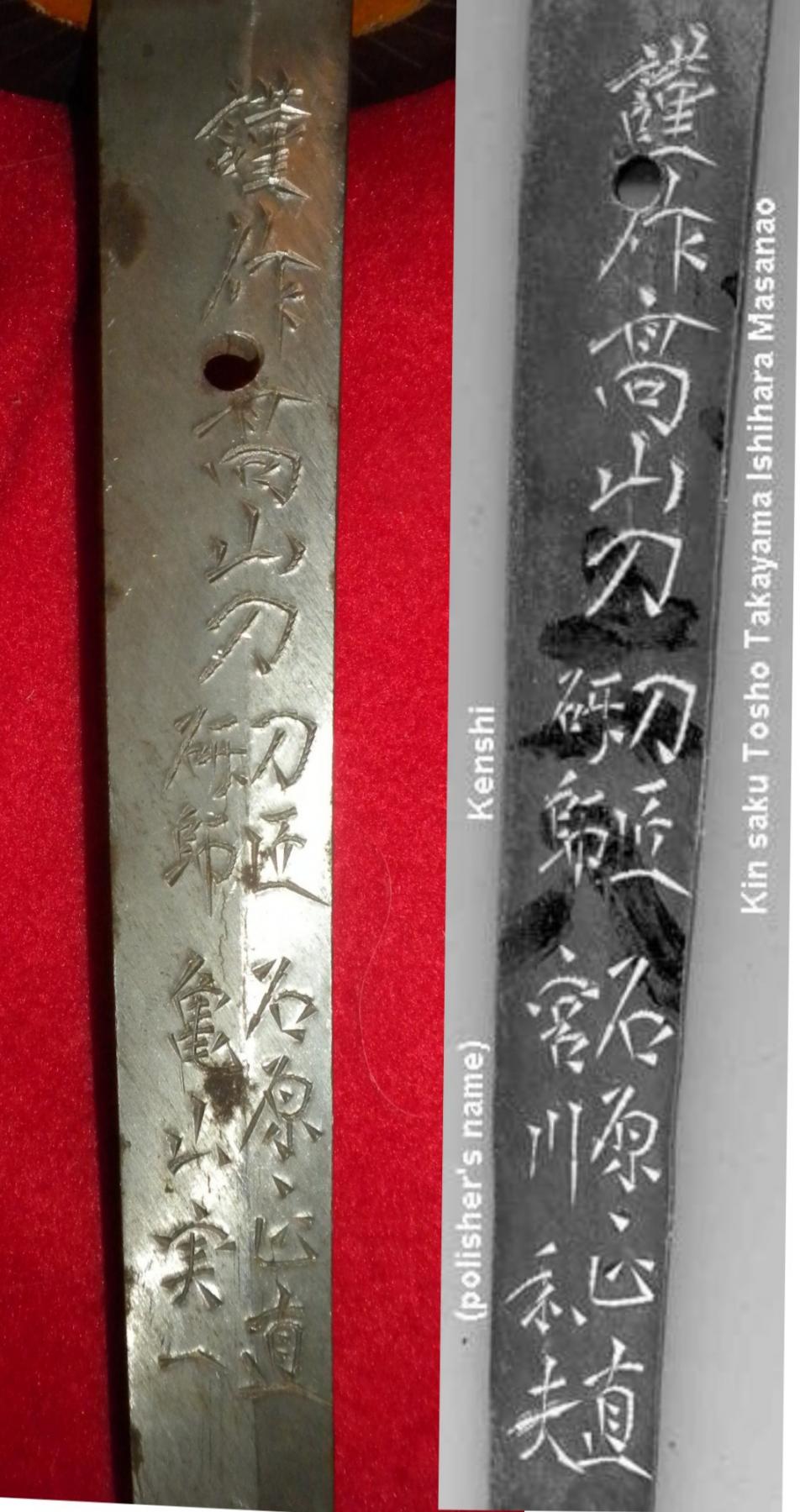

Bruce Pennington Posted June 17, 2020 Report Posted June 17, 2020 I don't know if this helps, but here is a picture of two blades with double mei. You can see the polisher mei is just his name at the end. If that is the pattern/practice, then it could mean this one is just a name, not "made by." Quote
BANGBANGSAN Posted June 17, 2020 Report Posted June 17, 2020 I don't know if this helps, but here is a picture of two blades with double mei. You can see the polisher mei is just his name at the end. If that is the pattern/practice, then it could mean this one is just a name, not "made by." Both 研師-Polisher and 刀匠-Swordsmith has the title and full name written down. I think my idea-調之 adjusted this make sense. Quote

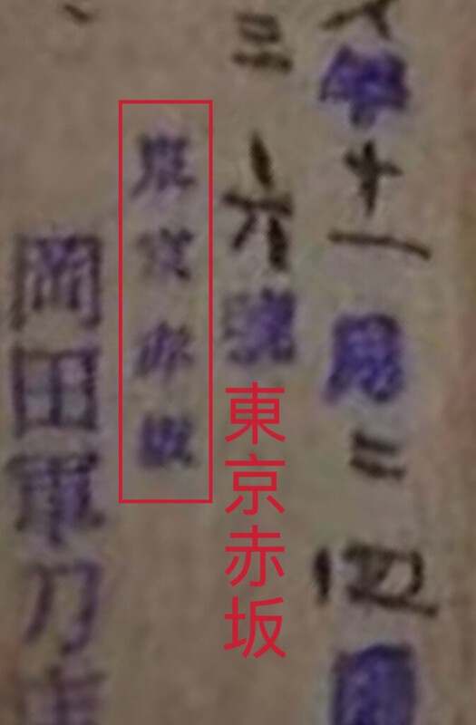

BANGBANGSAN Posted Saturday at 07:08 PM Report Posted Saturday at 07:08 PM (edited) @Kiipu @Bruce Pennington @IJASWORDS Please take a look at and refer to the inscription on this wood liner: “岡田軍刀店調製.” Here, 調製 likely refers to adjusting or modifying a client-provided blade/fittings so that they fit properly. It carries a meaning similar to 調之, essentially meaning “adjusted/adapted for this.” Edited Saturday at 07:10 PM by BANGBANGSAN Quote
Kiipu Posted Saturday at 07:58 PM Report Posted Saturday at 07:58 PM I only have one 1941 advertisement on file for this company. Looks like they were located in Akasaka Ward 赤坂區, Tōkyō 東京. 1 Quote
Kiipu Posted Saturday at 08:05 PM Report Posted Saturday at 08:05 PM 54 minutes ago, BANGBANGSAN said: Please take a look at and refer to the inscription on this wood liner: “岡田軍刀店調製.” In Japanese, the characters 調製 could be the division/department within the company that performed the work? @SteveM Quote
BANGBANGSAN Posted Saturday at 08:40 PM Report Posted Saturday at 08:40 PM 39 minutes ago, Kiipu said: I only have one 1941 advertisement on file for this company. Looks like they were located in Akasaka Ward 赤坂區, Tōkyō 東京. Indeed They were located in 東京赤坂 1 Quote
SteveM Posted yesterday at 03:26 AM Report Posted yesterday at 03:26 AM 7 hours ago, Kiipu said: In Japanese, the characters 調製 could be the division/department within the company that performed the work? I don't think this is a division within Okada. Just a general stamp indicating (or advertising?) that Okada performed the adjustments. 1 Quote
BANGBANGSAN Posted yesterday at 04:55 PM Report Posted yesterday at 04:55 PM 13 hours ago, SteveM said: I don't think this is a division within Okada. Just a general stamp indicating (or advertising?) that Okada performed the adjustments. Steve, thank you for your reply. This is exactly what I wanted to point out: the “調之” ( adjusted it)in the mei of that earlier sword has the same meaning as the “調製” (adjusted) from Okada Guntō Shop on this wood liner. That sword’s mei should read “石德 調之” (Ishitoku adjusted it), rather than interpreting “石德調之” as if Ishitoku Shigeyoki were the full name of the swordsmith. 3 Quote
