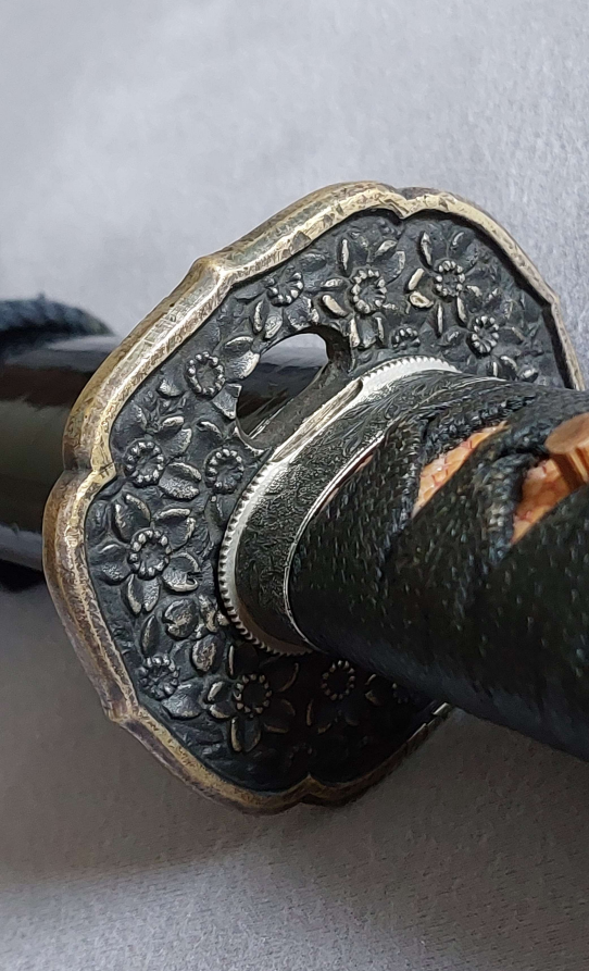

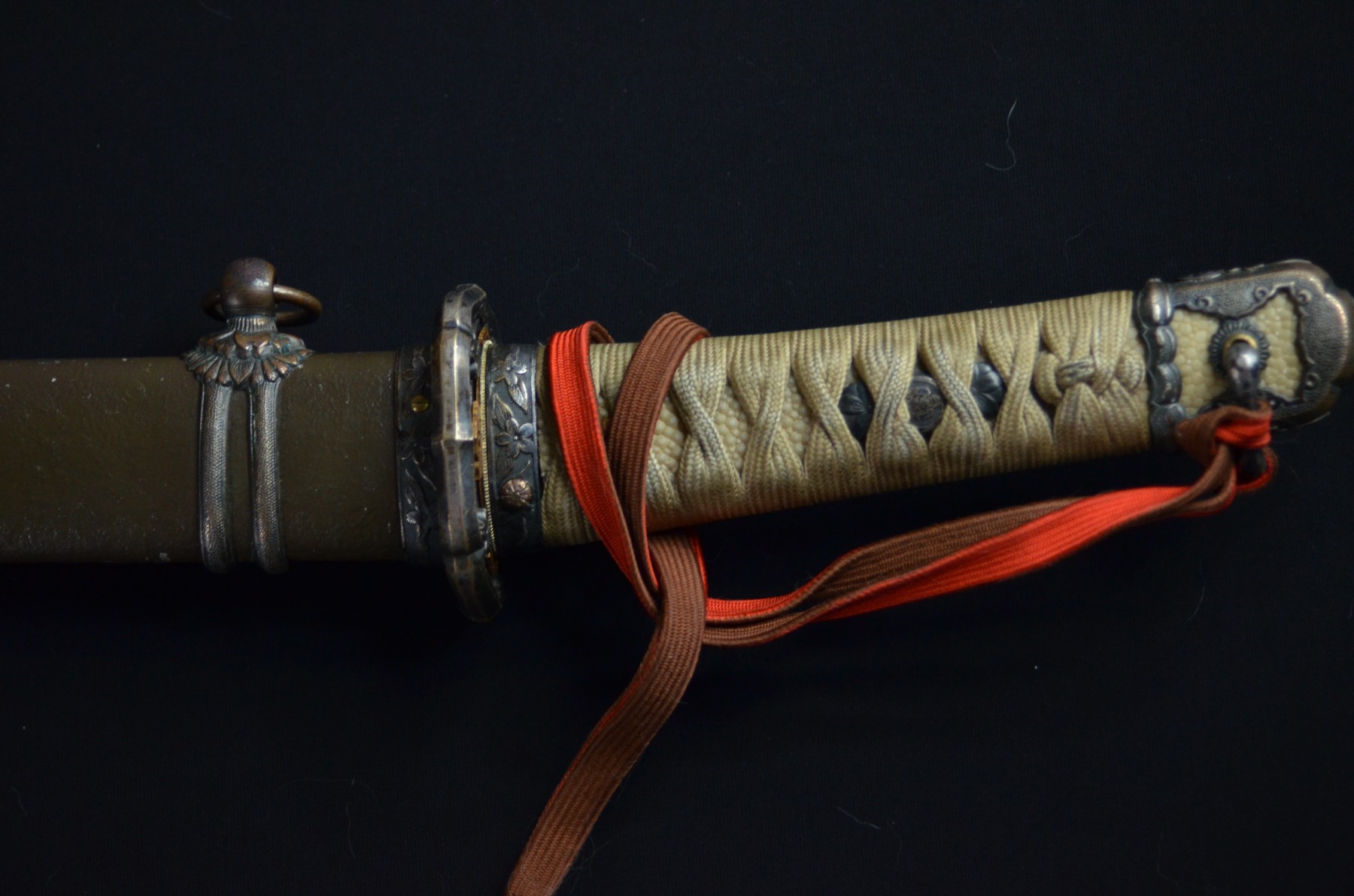

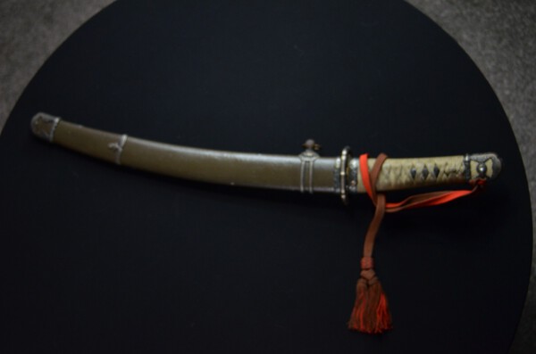

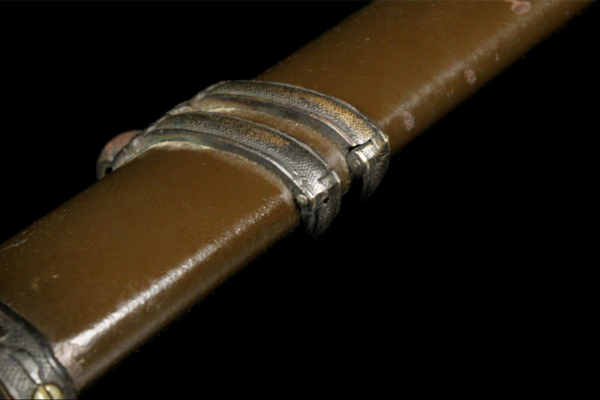

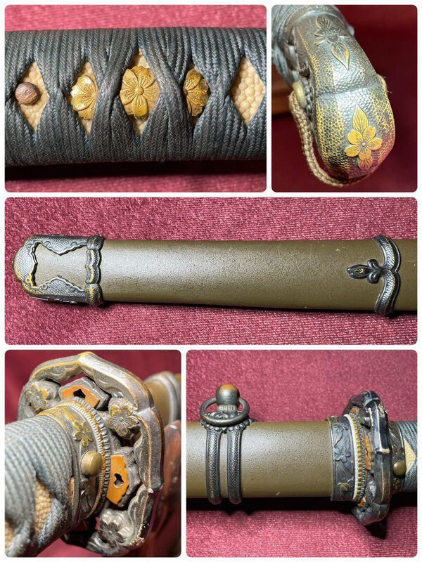

Here are some pictures of my Short Gunto with silver plated fittings. The Tsuba is pierced. This one has an inscription on the wood lining of the saya stating "for Major Kawada, ASAP" This is by far the shortest Gunto in nice fittings I have come across. It's a real treat.

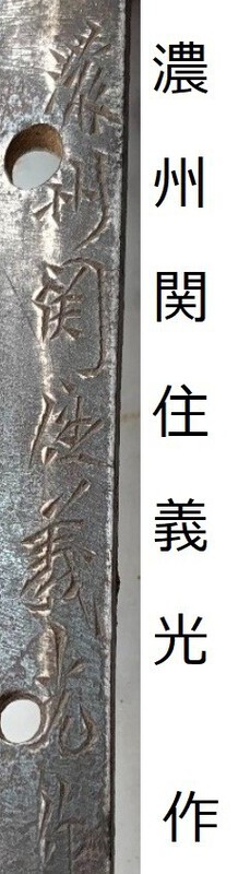

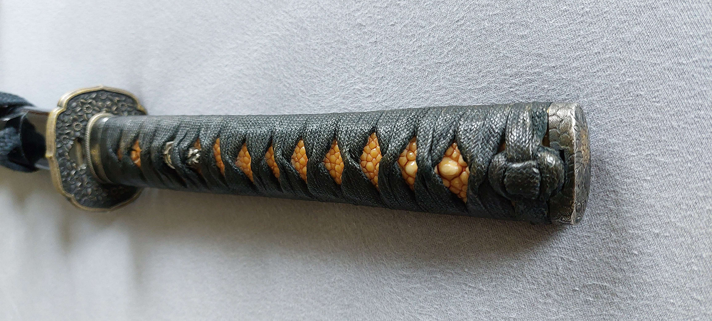

Very recently I found this shin-gunto with silver plated mounts and fittings.
It's a well worn sword, but I bought it because of its unusual look with the silvered parts.
The tang is nicely signed, I would appreciate if there is any information available about the smith who signed it.
Thanks and best regards,
Herman

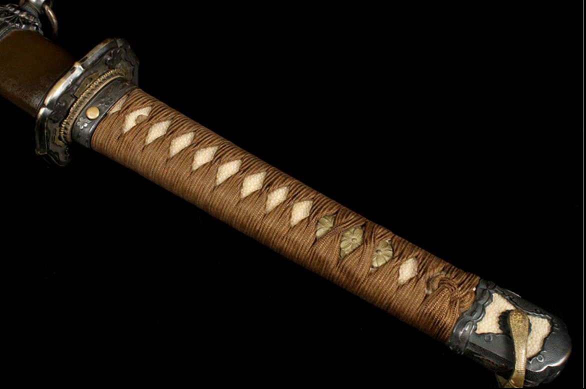

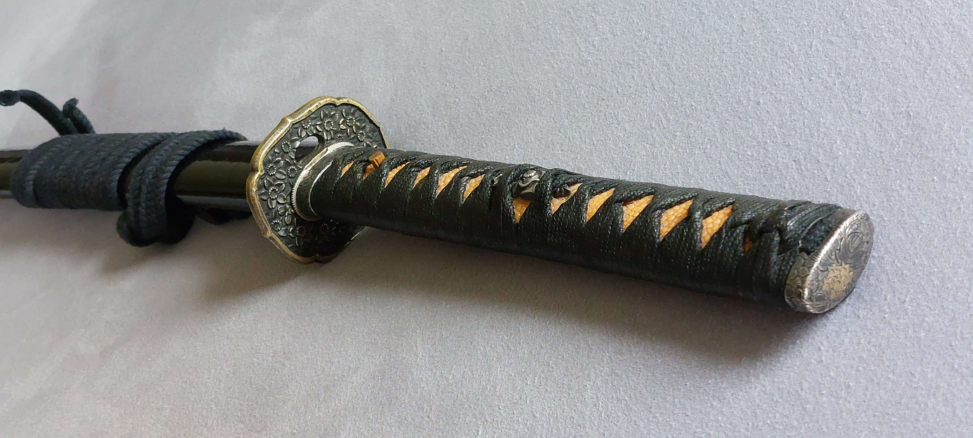

Here’s another Army sword with Silver-plated fittings.  This sword happens to have been made by Amahide as well (earlier in the thread I provided photos of another Amahide with Silver-played fittings—though this sword has a lacquered wood saya).
A few photos below, but here is the link to see the rest of the photos:
https://stcroixblades.com/shop/products/Japanese-wwii-army-sword-ww2-samurai-gendai-amahide-tamahagane-hot-stamp-th/
—Matthew Brice

@SteveM may correct me, but I think your blade was made by Yoshimitsu of Seki.  I think it's dated 1942.  Fascinating writing under the normal mei and date, though.  Maybe Steve can make those out for us?
Looks like the inscription below the date is another date expressed in Chinese zodiac terms (庚寅), which would be 1950. Doesn't really make sense to me since its a different date than what was written by the smith (1942).
And under the signature is also a mystery: 泰安 直? Taian Naotane. If I were to guess I'd say its just the scratchings of someone who was bored.
And yes, its Yoshimitsu of Seki. Nōshū Seki-jū Yoshimitsu saku.
Dang!  Mark this down in the history books - I got one right! Ha!  I agree, the writing on the end of the nakago looks period, but added.  Unusual.
I really appreciate your time and inputs, gentlemen.
But now I am totally confused, because this is what another source has told me about the tang marks:
- smith: Kanehiro (see pics)
- year of production: showa 19 (1944)
Who is wrong?
Unfortunately I cannot judge myself...
Best regards,
Herman
