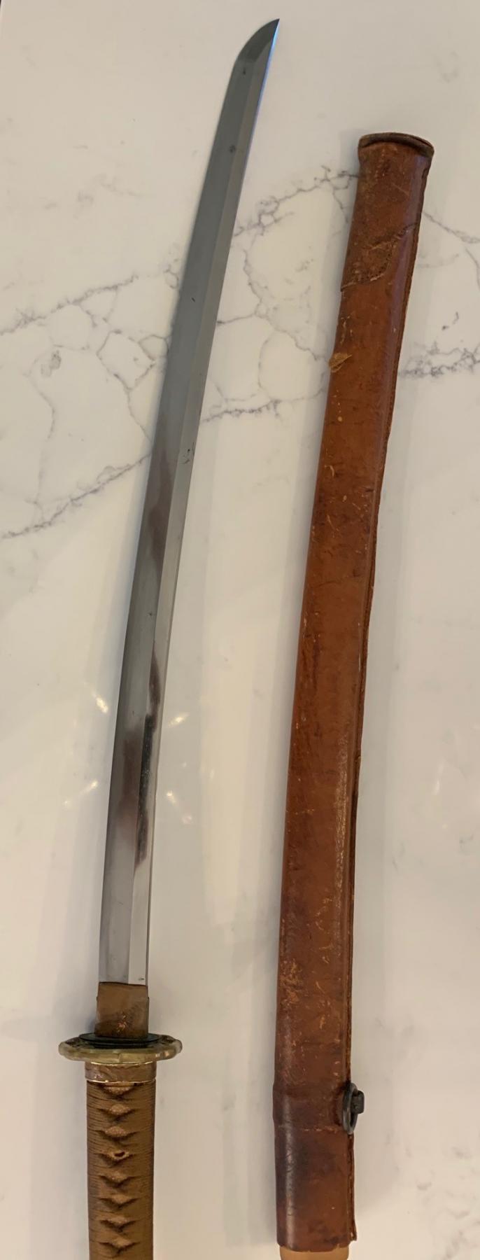

My Dad brought this Japanese sword back from WWII.  I was curious to know any information about it.  He got it on Okinawa, from pile of captured swords.

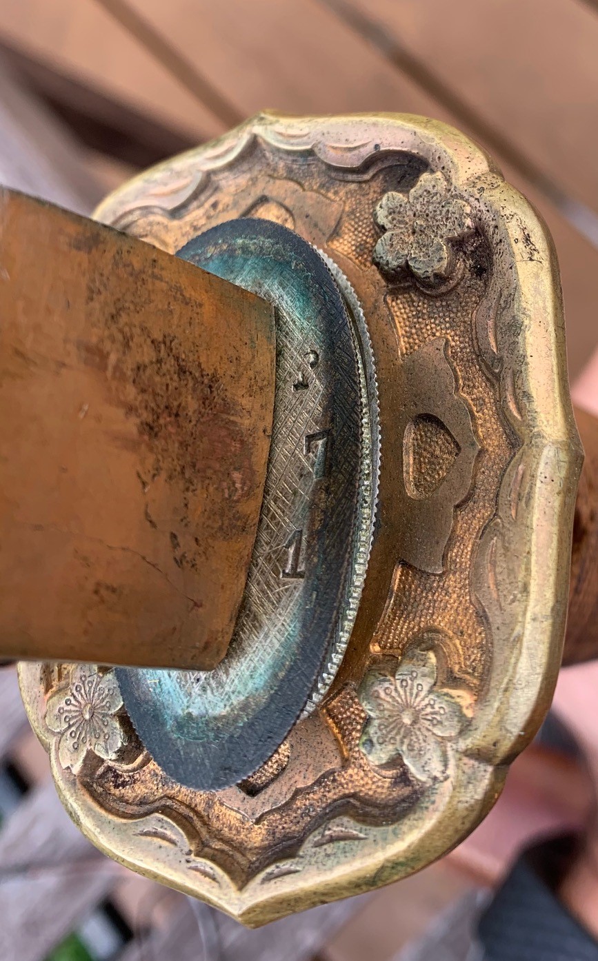

There's no markings, numbers or letters of any kind on the blade although I have not disassembled it. Maybe there's something under the tsuka.  The only markings I see are on the tsuba. There's one indistinguishable number or letter, over a 7 and a 1.

Type 98 Japanese officer's sword in combat saya (scabbard). The combat saya often means there is an older blade in there. No way to know until you take out that bamboo peg holding the tsuka on the blade. Once that is pushed out, the handle and tsuba/seppa will all come off. Then you can get some good pics of the nakago (tang), blade pointed up.
The fittings are nice, so there might be something cool under that tsuka!

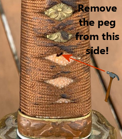

Well, I tried tapping it out but it taps in but doesn't come out. The tapping just seemed to crush the peg and it's not coming out the other end. I suppose that bamboo peg was rotten possibly.  Any suggestions?

If the peg is rotten it needs to be replaced so don't worry about damaging it; get it out.  The care & etiquette should help you get the handle off.  If it is too stuck to move, 1st check for a 2nd peg further down the handle and then try placing a small block of soft wood next to the habaki (collar) and butting against the seppa (washer).  Gently tap on the block with a hammer till the handle pops loose.  Get us clear pictures of each side of the nakago (tang).  Care & etiquette will help you replace the handle and insert a new pin.

The peg should be thinner on one side versus the other, as in one side of the peg will not fit into the hole if you try but the other side should so you push on the smaller end of the peg and it should come out.
If this is not the case and the peg is already damaged you can try with some more force, like a blunt nail or screw with light hammering on the small end of the peg. Remember if the peg is faulty to get something similar as a temporary solution, very important the sword is not left with just friction from the tsuka holding it in.

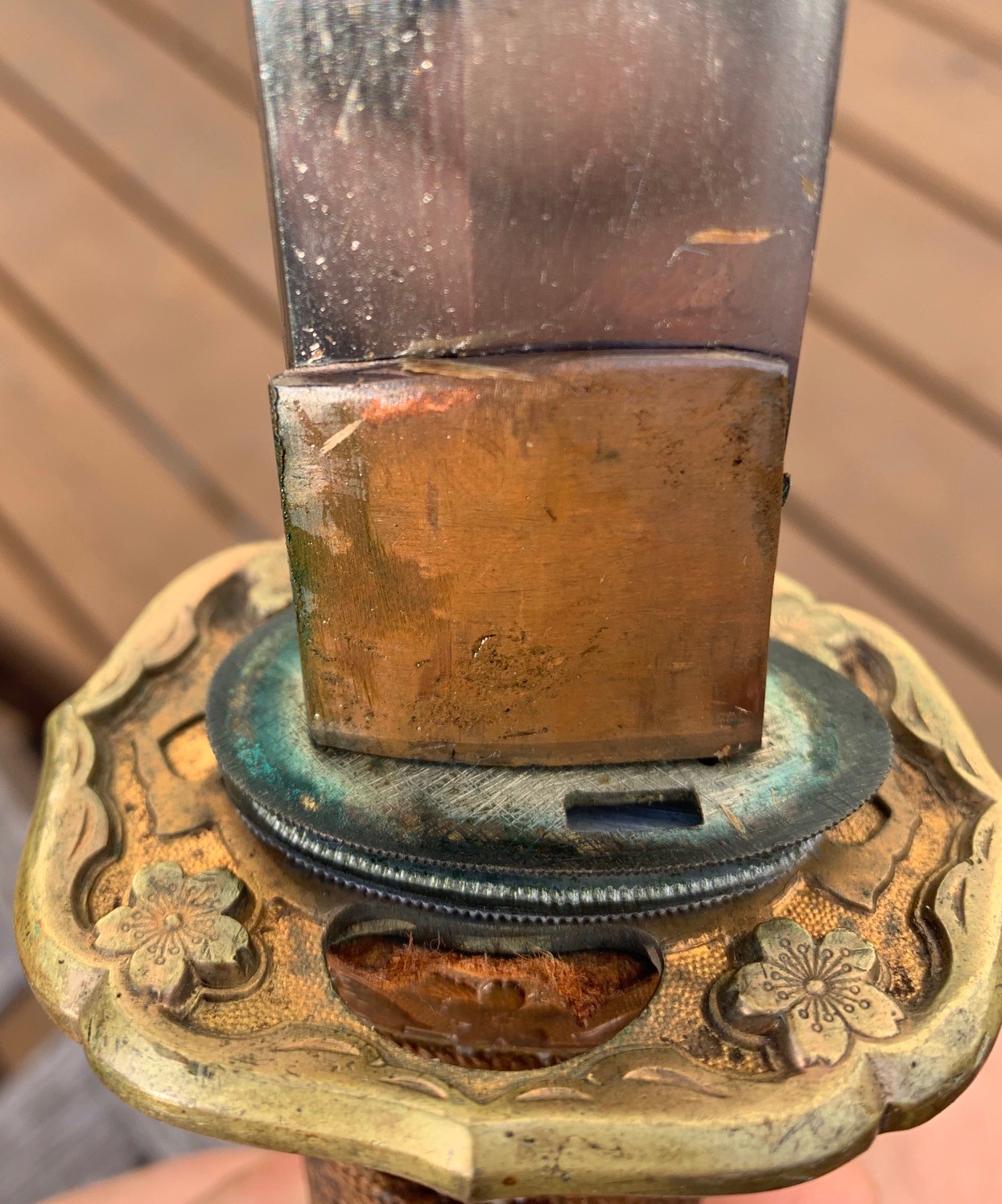

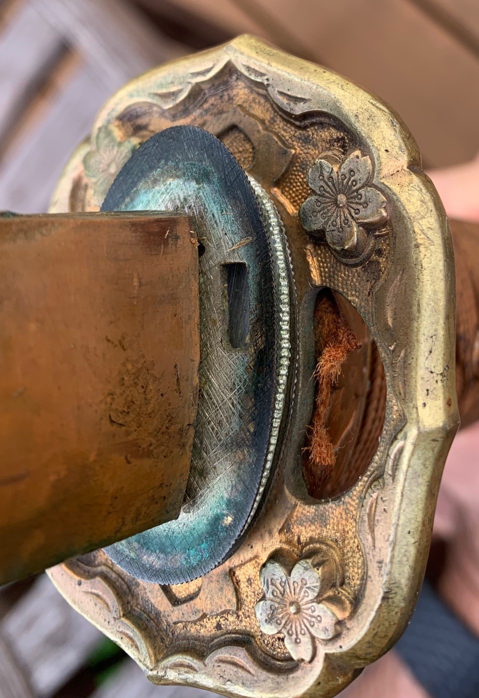

The Seppa/spacer looks replacement/
 Not the first time I have seen reused and mixed fittings on a legit' Gunto. There was a war on, and in the field you would use what was available, cannibalising other swords when necessary. So many damaged swords in the China campaign that the IJA sent out a repair team, who ended up having their tour extended because there were so many to deal with..... These do look to have been reassembled in the wrong order though.
Seems that the leather retention strap seppa has disintegrated at some point and swapped with others.
Yes, it's gone completely unfortunately

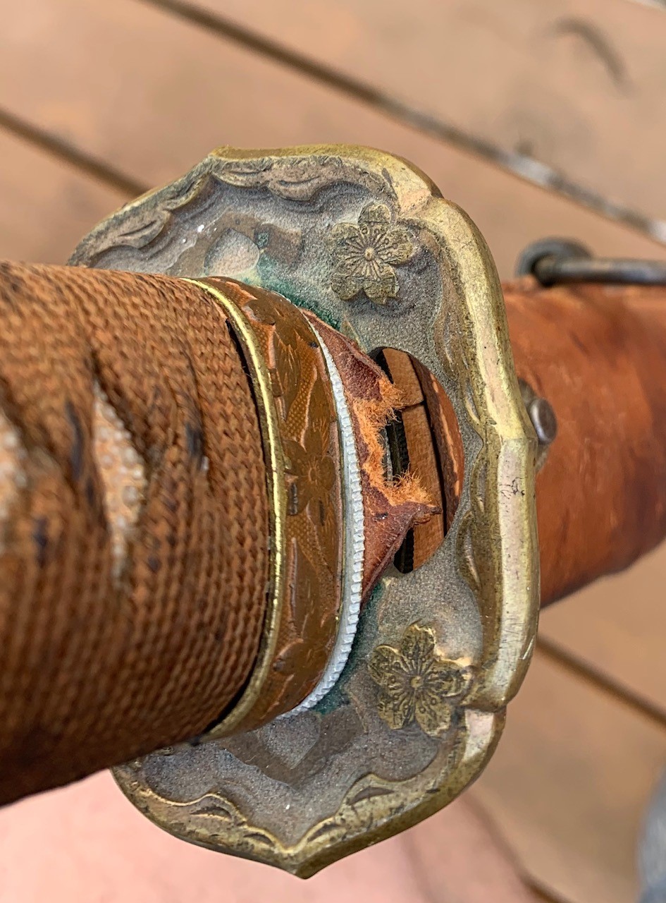

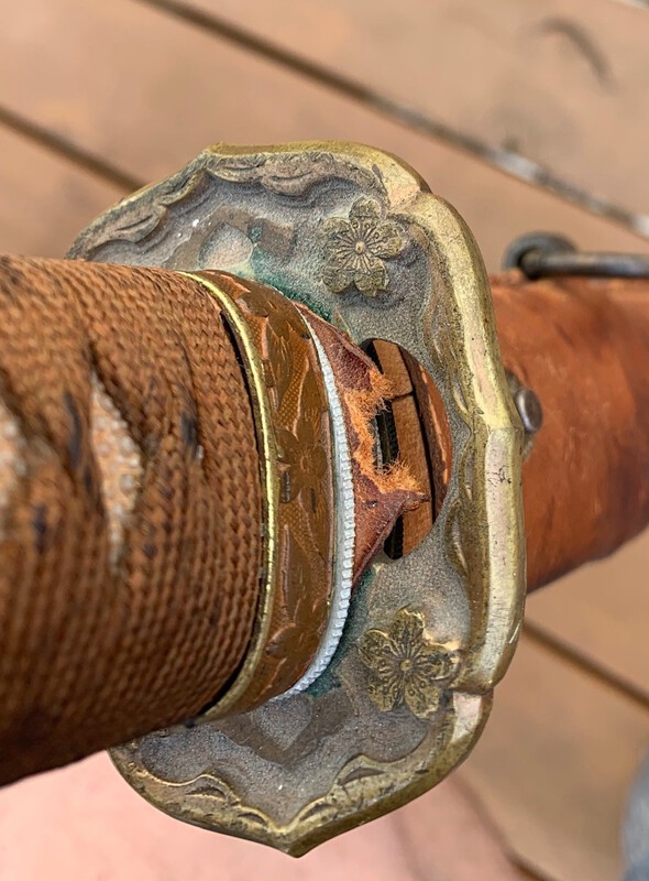

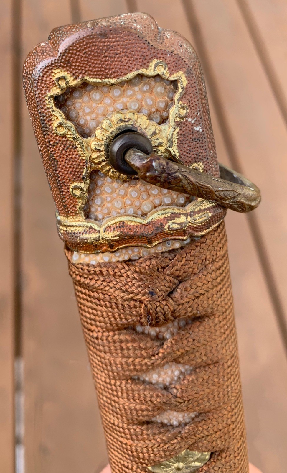

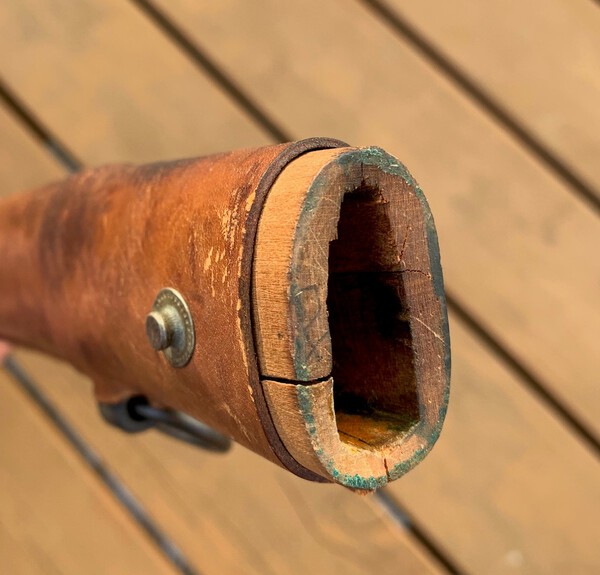

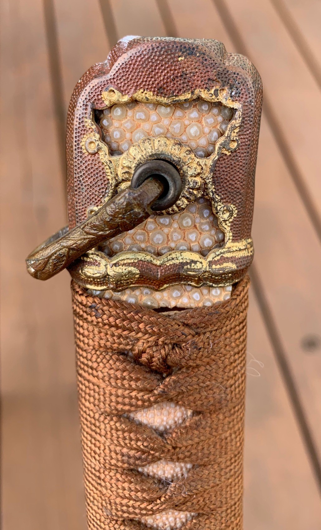

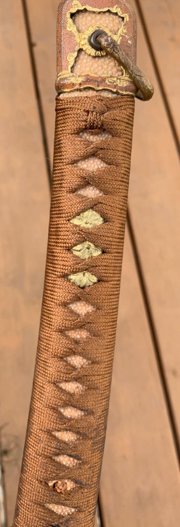

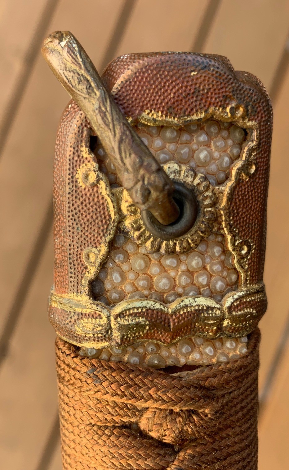

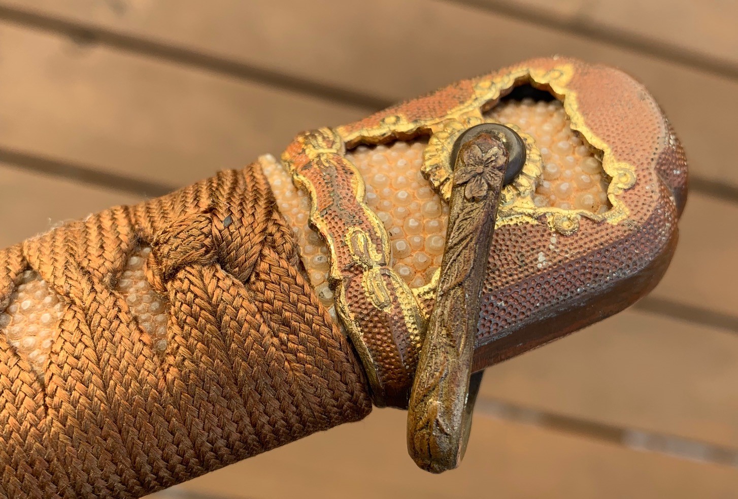

Well, here's an interesting dilemma.  I tried to get the peg out again but no luck.  I didn't want to strike too hard on it. I finally got a small flat head screwdriver and just dug the pieces out. There's just bare metal at the bottom of each hole.  It's not lined up with a hole in the blade.
The peg was apparently 2 pieces or maybe it was one piece at one time and it shifted and broke it in two. Not sure where to proceed from here. I don't want to damage it. See the pictures.  You can see the metal at the bottom of each hole.
All the seppa parts are loose. Maybe this explains it.
Dear Tom,
It looks like the mekugi (bamboo peg) had been sheared off on each side and there is probably a small bit still in the nakago ana (tang hole) that has the tsuka (handle) jammed in place.  You should work very slowly and carefully.  It also appears that the tsuka has slipped within the wrap (based on the look of where the binding meets the kashira.  I think that you should start by gently moving the sword back into the tsuka (instead of out of it) so that you can realign the holes in the tsuka with the hole in the nakago (tang). Once they are realigned, you can push out the small piece of remaining bamboo peg.  In other words, I think the tang hole is above the hole in the handle if you hold the sword with the tip point up.  It may be counterintuitive to force the sword deeper into the handle when you are trying to get it off, but I think that's what you need to do in this case.  You can move the sword deeper into the tsuka by holding the tsuka in one hand with the tip of the sword point up (vertical).  Tap the bottom of the tsuka (kashira or pommel) with the palm of your other hand.  Inertia will cause the heavy sword to slowly move deeper into the tsuka (handle).  Start lightly but you may have to tap it pretty hard.  Keep checking to see if the holes are realigning.  If they do, then get the remaining mekugi (bamboo pin) out.  If not, then you'll have to try the block of wood tapping against the tsuba method (mentioned above) to remove the handle (but if it does have a small amount of mekugi remaining, it may jam and tear up the tsuka).
Quite peculiar! Two options:
1. Grab the tsuba on both sides with both hands and rock the tsuba . I have dislodged stuck tsukas that way.
2. The barrel screw at the top unscrews. If it is through a hole in the nakago, removing it will free the tsuka. You will have to bend the sarute enough to get it off first. To have a hole that high is unusual for this type blade, common in Type 3, or contengency, blades. I would try it though.
