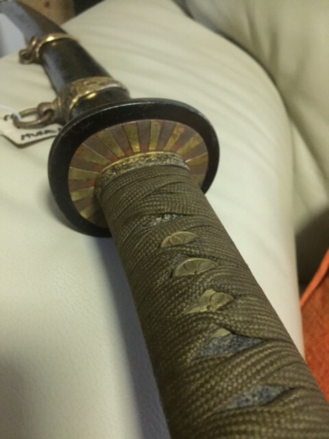

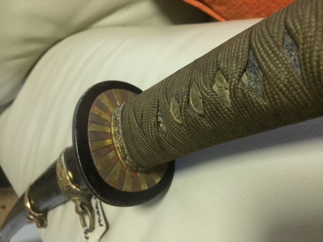

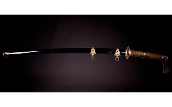

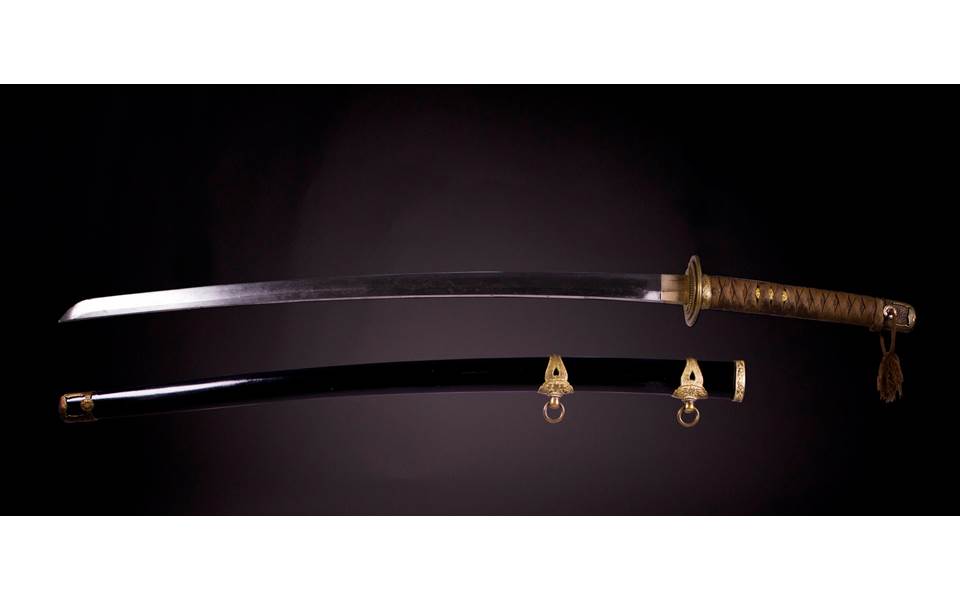

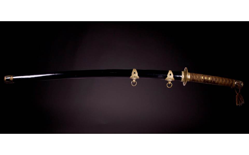

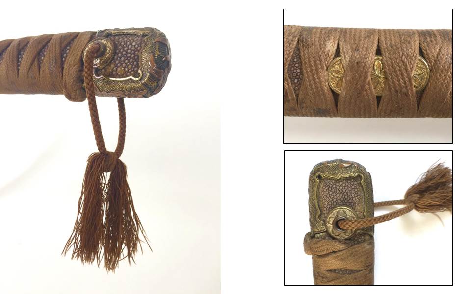

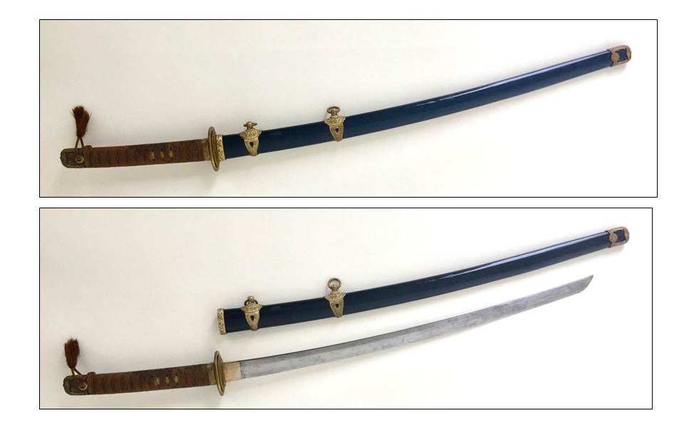

Erwin Posted September 17, 2017 Report Posted September 17, 2017 Hi all, This post is only to share my excitment with respect to one of the latest purchases, a Kai Gunto made by Nagata Sukenori. I have done most of the research already so no particular questions although I cannot find too much information around this smid. What I found I added to the photoshoot in the pictures attached. Although the Katana is in a great condition overal, I think the blade has not been treated well. The hammon is only very slightly visible unfortunately andfor sure a polish would bring it back alive. Anyhow, just though it would be nice to show. Best regards Erwin 4 Quote
IJASWORDS Posted September 17, 2017 Report Posted September 17, 2017 Hi Erwin, nice KAI GUNTO. Hold off on the polish is my advice, and enjoy the originality of the sword. The fittings look good, and makes a nice package to study. I couldn't find out any more info on smith, if you find more please update us all. Congratulations. Neil. 1 Quote

Stephen Posted September 17, 2017 Report Posted September 17, 2017 Really cant see the blade to tell much. Fav Kai gunto tsuba set up, well done! Quote
Erwin Posted September 18, 2017 Author Report Posted September 18, 2017 Thank you for your comments and was my understanding as well that the term: with the aid of machines, does more right to the work and craftmanship going into producing the blade. Of course, with the Seki stamp applied, it is certainly not traditionally made but believe the overal set-up is nice and indeed, the sun ray Tsuba assembly is also my fav set-up and love the details. With best regards and have a lovely day Erwin Quote

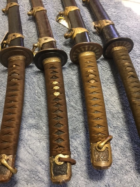

vajo Posted September 18, 2017 Report Posted September 18, 2017 Erwin i had 2 Kai Gunto in my collection well signed Nakago and sold them further. I think that the saya of yours i sprayed black. I dont know what you have paid for the Kai Gunto but it is not worth to spend more money in that Sword. Belive me. Look for a mint Kai Gunto with a good looking same saya and fittings in better condition and a good blade. I sold mine very cheap and it takes one year to sell it. Chris 1 Quote

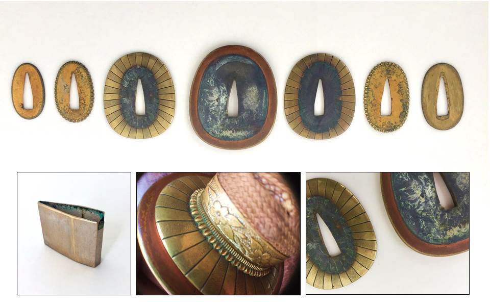

IJASWORDS Posted September 18, 2017 Report Posted September 18, 2017 Hi Erwin, the KAI GUNTO is a beautiful WW2 sword, and I don't think they get the recognition they deserve. One of the reasons is that a large number were made with stainless steel blades, and the nihonto purist shunned them. I happen to love all KAIs, and collect them (not in stainless steel). The Seppa range in finish from plain brass to highlighted gold plating. The rising sun Seppa is a beautiful thing to behold. Don't be put off yours, it is a good example to keep and study. Neil 4 Quote

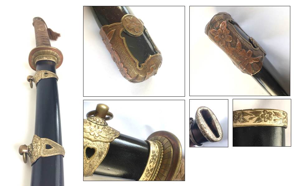

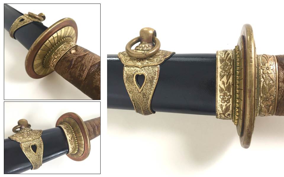

Stephen Posted September 21, 2017 Report Posted September 21, 2017 The copper mimi is a upgrade the guy had some coin, never say never in Gunto koshrai Quote
vajo Posted September 21, 2017 Report Posted September 21, 2017 No Stephen i don't think so. The Koshirae is rubbed in my opinion. Look at the kashira the blossoms are all pure copper. Normal it was gold plated, like the ashi, the fuchi, kabutogane and the ishizuke. I saw this rubbed parts at my two Kai Gunto too. When you look with a very good magnifying glass you see maybe goldplating there. But, maybe you are right and this is a downgrade? Do you remember my crew gunto i showed here. The first thing Brian said the copper tsuba is rubbed. I thought that was an individual upgrade. But Brian was right. Maybe the officers on board cleaned often thier swords? Quote
Bruce Pennington Posted September 21, 2017 Report Posted September 21, 2017 I see what you me - even the black of the tsuba is gone where it is exposed (still there where the seppa covers it). I have seen many kaigunto with the gold-giliding gone from the saya fittings, but I've never seen the tsuba black gone. This does seem intentional. It looks good that way, but not original. Quote
Stephen Posted September 21, 2017 Report Posted September 21, 2017 SO they rubbed it then gilded the mimi? Quote
vajo Posted September 21, 2017 Report Posted September 21, 2017 Look at Ohmuras site. The black of many Tsuba has gone at the mimi. They all was complete deep with black Seppa and Tsuba. But the black has gone and i think that the rubbed then to shining metal for a better look. Thats my personal opinion - not more and i did not say I'm right. Quote

Ian B3HR2UH Posted September 22, 2017 Report Posted September 22, 2017 I agree with Chris the O seppa and the visible part of the tsuba have clearly been overcleaned . The mimi ( or rim ) looks an even lighter colour as it has been cleaned back to brass. Ian Brooks 1 Quote
Stephen Posted September 22, 2017 Report Posted September 22, 2017 so now you got this going from copper to brass? Quote
vajo Posted September 22, 2017 Report Posted September 22, 2017 From Ohmuras Website. Type Tachi Metal fittings (pommel, ferrule, throat, the first - the second suspension mount, semegane, chape) The product made from a brass casting. Compared with an army, there was few work absolutely, and the production company was also restricted. Therefore, except for a landing force or the great war last stage, the quality and the gap of a shape like an army Guntō are not. Guard: Product made from a brass casting. Stephen i don't think that this one is a copper tsuba. But who know's? No, i've never seen a regular copper tsuba on a Kai Gunto. And this one is a regular tsuba, i bet. Quote
Stephen Posted September 22, 2017 Report Posted September 22, 2017 Erwin you have a nice sword there, it will cut! 1 Quote
PNSSHOGUN Posted September 22, 2017 Report Posted September 22, 2017 I believe post war meddling on the tsuba and seppa. Quote
Brian Posted September 22, 2017 Report Posted September 22, 2017 Whether or not, doesn't detract too much from what is a very nice sword. Congrats Erwin 1 Quote
