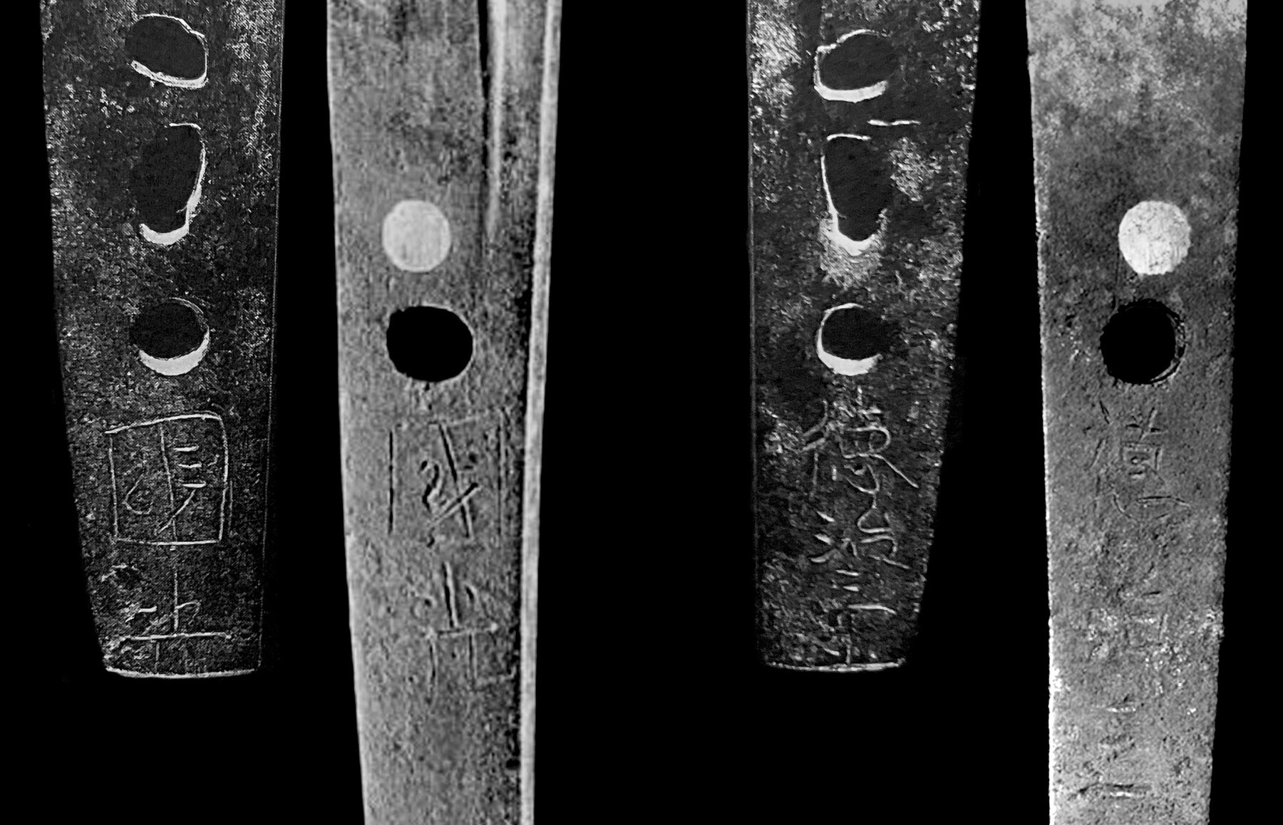

I attach an extract from the Token Bijutsu magazine describing a famous JuBu, ex count Kanroji denrai and dated 1320. In the narrative, Tanobe sensei clearly demonstrates that he thinks this is by the master himself as he talks of this being one of his last works and bearing the typical (Shintogo’s) mei.
Next, I also attach a blade dated 1324 in an interesting manner with unusual kanji for 4 (twice 2). The blade passed Juyo in the 1970s and therefore there is not too much detail in the Zufu apart from some generic text about Shintogo being the Soshu founder but having a more powerful expression than Awataguchi and also that the carving might have been made by Daishinbo. It seems to direct the reader to the master himself as opposed to students, etc.
That latter tanto is a curious case. But at least the former one is not and indicates a later date of death than mentioned in this thread so far.

Thank you very much!
Very impressive to recognize once again how the field's understanding advanced with digital. The volumes from 1960s and 1970s just don't cover it as modern tables like the ones Jussi produces do.

My pleasure.
Jussi is outstanding in data collation. He is incredibly studious and industrious when it comes to that and indeed his very useful database shows the aforementioned tanto as the one that has the latest date (1324).
It must be a curious example to study frankly. I do not think it has been elevated to TokuJu, at least as far as my limited understanding stretches, and I do not have any photos of it to try to assess some of the workmanship from partial photos (always fraught with risk, as Jacques will undoubtedly say).
But also that nakago seems so punctured that even kanji assessment is unreliable.
Jussi’s database also mentions the Juyo-69 tanto dated 1322. I need to do further digging and get hold of the Juyo Zufu when available / possible so that we can read what is said of it. However, I can attest that I have seen it exhibited in the Juyo exhibition and in fact was owned/managed by a friend. A very nice and stout, healthy blade.

Some very useful points of reference.
According the the Nihonto Club Kunimitsu was active 1293-1312.

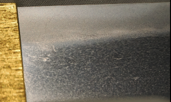

It's interesting that Tanobe gives a longer active life for Shintogo on the basis of the quality of a particular blade ie the 1320 tanto.
From the Koto Meizukushi Taizan. Shintogo is said to have been born in 1250 and according to this reference dies in his 63rd year, ie 1313. Question is, which source is the most reliable. Dating works from this period are notoriously difficult with many contradictions even within the old texts.
Given photos are even less useful for observing certain features compared to oshigata, this tanto dated 1324 shows many of the signature Shintogo features, such as extensive chikei, fine kinsuji and yakikomi. Signed Shintogo Kunihiro.
https://emuseum.nich.go.jp/detail?langId=en&webView=&content_base_id=100486&content_part_id=0&content_pict_id=0
The 1318 Kunihiro signed tanto also has yakikomi. Beyond that the poor quality B&W image gives up little to be able to pass judgement on the jiba. What doesn't make sense is why Kunihiro would be signing in his own right if his father was still alive and working.
Another feature of the kuni kanji that's different to the Masters is the horizontal strike above the mirrored S. I've seen it several times on published Kunihiro Mei but not Shintogo's. I think I can make out a similar strike on my blade.

Let me quote from Markus Sesko’s book on Masamune:
When it comes to dated works by Kunimitsu we are talking about a time from the first year of Einin (永仁, 1293) to the fourth year of Genkō (元享, 1324).
The Kotō Mei Zukushi Taizen (古刀銘尽大全) quotes Kunimitsu´s year of birth as Kenchō two (建長, 1250) and his year of death as Shōwa one (正和, 1312), which does not match with his known dated
signatures.
Well, the information from the Kotō Mei Zukushi Taizen, especially the dates, must be taken with a grain of salt because it gives for each and every smith his year of birth and death. Such a comprehensive
data was not known in earlier times and it is odd that the creator of this work suddenly “knew” all this at the time the publication was published for the first time, in the fourth year of Kansei (寛政, 1792).
I think it eloquently describes why the veracity of that source is dubious.
And when it comes to Stan’s database, I do not think he has updated it recently. I believe that knowledge and understanding have moved substantially in the last 10-15 years since the database was put together. That is completely normal, as new blades emerge (well at least new / unknown to us) and the NBTHK keeps documenting new examples.

Since there is a tanto by Shintogo Kunimitsu (Juyo Bunkazai in the Atsuta Jingu) with a Toku-Ji san-nen nengo as well, it should be compared first to the blade in question.
Much has been said about the kanji for "Kunimitsu".
I see inconsistencies to Kunimtsu's traits in both kanji; too many for me to explain it with student's work.
The first, horizontal part of the 2nd stroke of the kanji "Kuni" is "hanging" down.
As mentioned before, the 4th stroke should be close to vertical and be in line with the first stroke of "Mitsu"
The hokkan-style of the upper part of "Mitsu" is missing.
Student's work...maybe, but I'm sceptical-
What really bothers me is the writing of the nengo.
It looks completely different in style and proportions compared to the Bunkazai.
