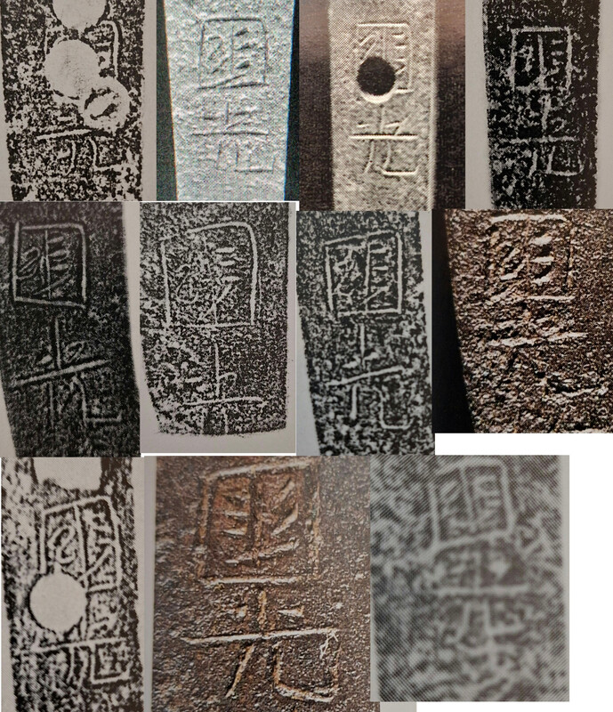

As I am at home in a fever, I did this just for fun. Here are the Kunimitsu kanji for 11 dated Shintōgo Kunimitsu tantō. And I did scramble the mei so they are not in any ascending or descending dates.
  • Love 1
Another Norishige signed tanto with large, finely chiselled Mei, characteristic of his early work and exagerated slant to the 2nd shige kanji. From the Compton collection.
Kunihiro, when he signed Kunimitsu, has a different style 'mitsu' than his father, again with a slight tilt.
image.png.75a9a116e655658ede95a1e1630d431d.png  image.png.85bb3497ed9833ca1dc4309fdfece3ea.png
And Kunihiro signing as an independent smith in his own name with sloping kuni stroke.

Have you done a side by side comparison of the mei? Please attach here as I am curious.  As discussed before, there are a lot of school daisuke/daimei and one needs to find the right match.
1306Kunimitsu.jpg.6111211ad99706ec5e65655921319375.jpg1308Kunimitsu.jpg.11245db0daa23267a86a90d71bfbfe6a.jpgneutrallighting.jpg.c76f4e75ef21983dc7beb132d467755a.jpg2nd1308.jpg.076889f50c7587558c07e3f5f9e221c1.jpg1309Tanto.jpg.27e79b0b0bc5f7798f82cba991289dfa.jpg
                  1306                                                                                      1308                                       2nd 1308 tanto.                             1309
            Juyo (1970)                                                                                                                                Juyo Bunkazai                       Juyo (2009)
Different hands carved these 3 Mei IMO, based on the style of 'mitsu' Mei. The 1306 and 2nd 1308 tanto have the stylised date carving as noted by Tanobe.  The 1309 could be a 4th hand or perhaps the same author who carved the 2nd 1308 tanto mei.
Very different…. Not just the Mitsu but also Kuni…Chisel thickness is also rather different. And smiths tended to prefer one type of chisel even if their handwriting changed over their long careers.

So to summarise. As Ray suggested this appears to be an apprentice blade made daimei or more likely daimei-daisaku. The more I learn the more this makes sense. I would argue the smith is Norishige at the age of 18 working as an apprentice under Shintogo Kunimitsu. What evidence do I have to support this hypothesis?
1) Its universally accepted now that Norishige initially apprenticed under Shintogo Kunimitsu.
2) He had a long career starting 1308 (exactly the date this blade was made) and in this year he would have been 18.
3) His early Mei was large using a thin chisel, with the 2nd kanji slightly at an oblique angle. And from what I can tell it's quite an angular style too.
4) He dated many of his blades which was unusual for the time. Those that exist from up to 2 years either side of 1308 and also dated were carved by different hands that used a stylised writing style for the date, suggesting he was one of several apprentices in the Shintogo workshop.
5) The fact that the 1306 and 1308 blades are almost identical in sugata, length, identical koshi-bi etc would make sense if a Shintogo wanted to evaluate his students capabilities, by minimising the variables. Apprentice pieces follow this practice even today.
6) If it is an apprentice piece it likely took a lot more time to make thus explaining why there is no reference to a specific month in the date.
7) Norishige continued the Shintogo tradition of carving usual features into his Mei (like the horizontal half-moon on 'shige') throughout his career with only small changes in style.
8. The format of the date is consistent for Norishige who uses phrases like "on this lucky day...."
9) Daimei and Daimei-Daisaku is accepted for Shintogo Kunimitsu towards the end of his life. And in 1308 he only had 4 more years to live.
10) Norishige continued to make tanto in this archetypical Shintogo style for many years after his Master's death.
11) Unlikely to be Yukimitsu or Masamune as their Mei is too different. Kunihiro is a certainly a realistic possibility, but was he old enough if Tanobe says the sons were too young in the preceding Kagen era ( 1303-5) and Shintogo's oldest son Kunishige died in 1303. Here is an example of a dated (1324?) Juyo Bunkazai Kunihiro tanto, but without the adjective kanji Norishige uses. Just "on the 1st month, 3rd day......"
Does anyone take exception to any or all of this hypothesising?

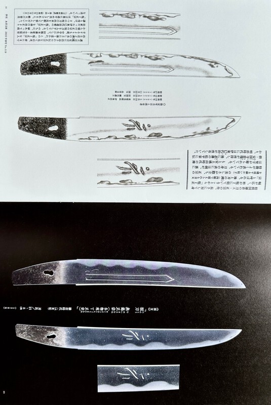

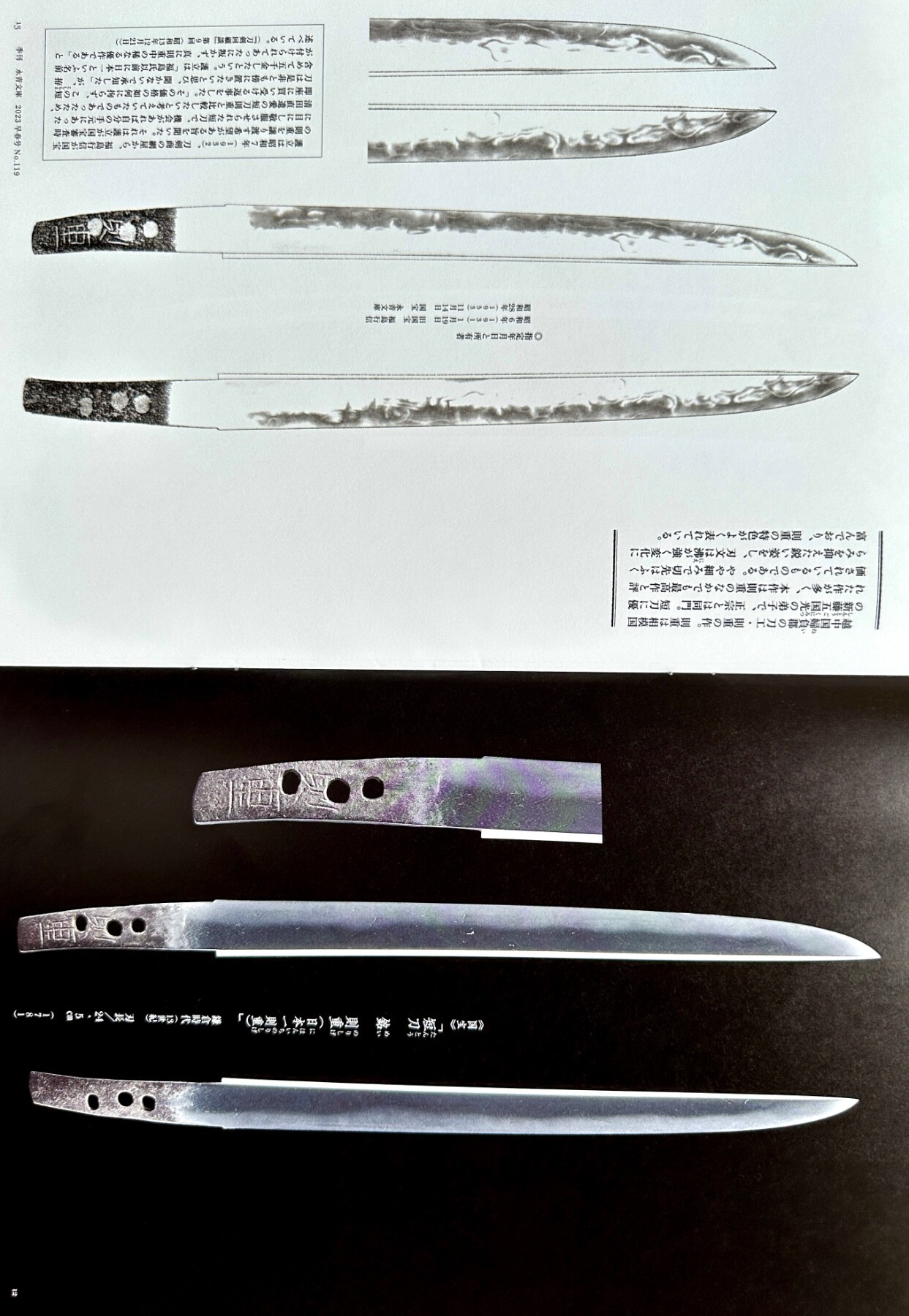

I remember rather well that Kokuho Norishige tanto. It was displayed side by side with the Masamune in the Eisei Bunko museum and completely put the Masamune to shame.
That day was great for me as in a tiny space I could see these two above plus the gorgeous Ikoma Mitsutada and an incredible JuBi Hatakeda Moriie (perhaps his best or one of the best).
Anyway, some images from the booklet I brought home since the guardians watched over me like hawks and photography was not permitted.
As I am not proficient in Sōshū, and I only have few books on Masamune, my few questions would be.
Which reference gives the 1312 as the date of death for Shintōgo Kunimitsu?
What reference mentions Norishige used commonly 吉 in his signatures. (as I have so far encountered only 1 signed Norishige that has that character).
