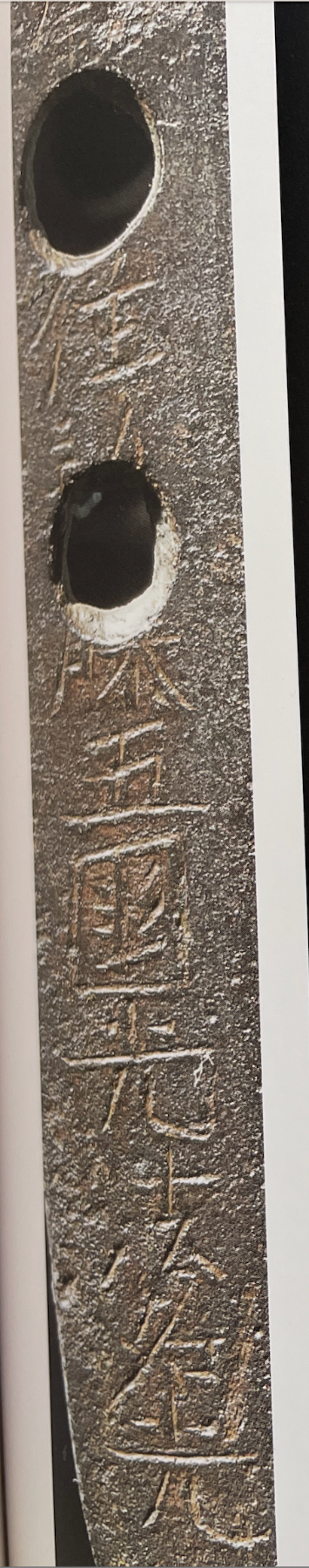

Lewis B Posted September 28, 2025 Author Report Posted September 28, 2025 Consistency of koshi-bi horimono carving's on dated Shintogo tanto 1293 tanto (earliest dated blade by a Kamakura blacksmith and reason why Shintogo Kunimitsu is considered the founder of Kamakura blacksmithing). Image from the Sano museum Masamune: the genius of Japanese swords and his lineage exhibition catalogue. Length of koshi-bi is 37.4% of nagasa 1306 tanto which could be daimei-daisaku work by Yukimitsu Length of kochi-bi is 40.6% of nagasa 1308 tanto Length of koshi-bi is 37.3% of nagasa Quote

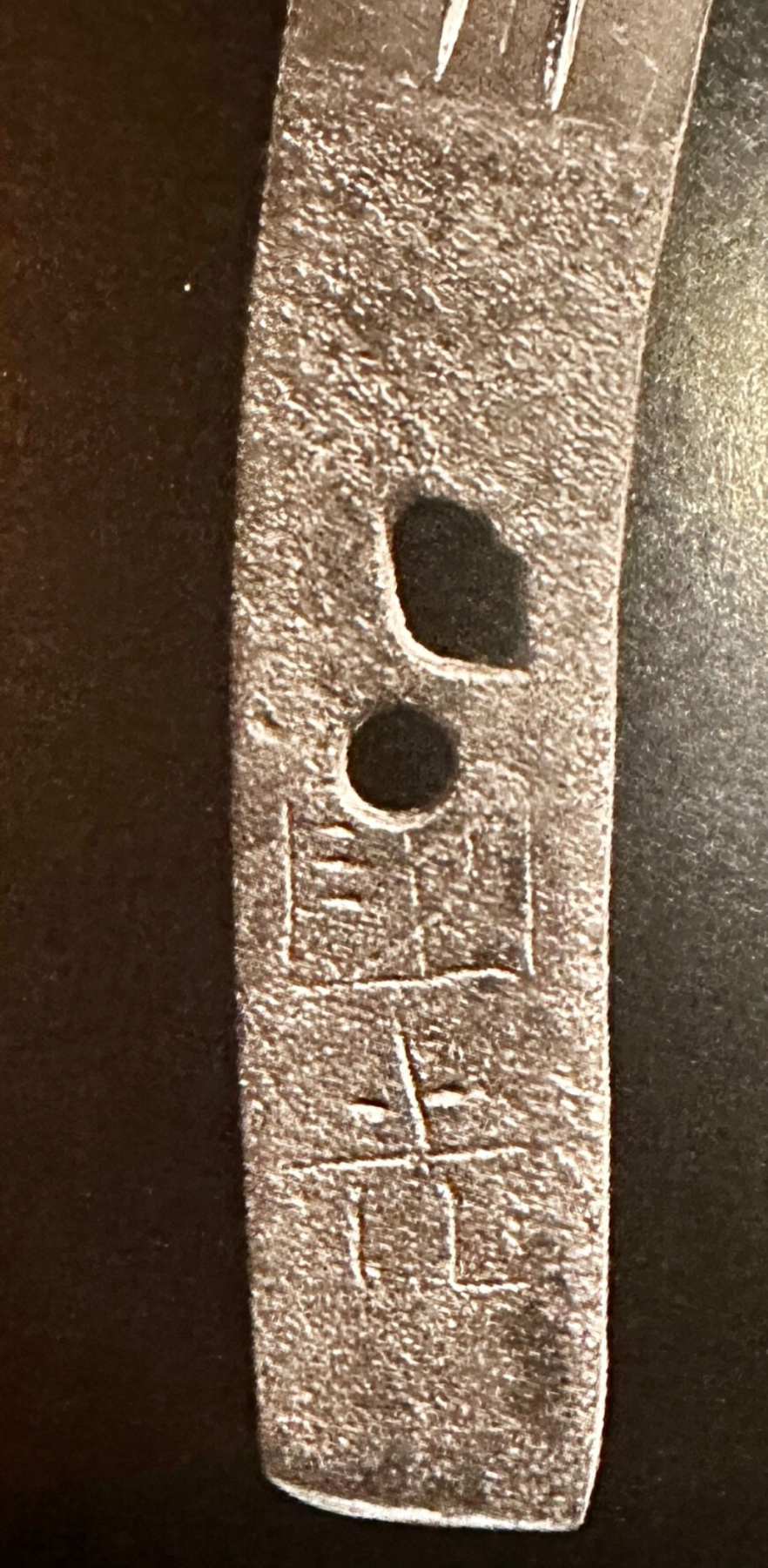

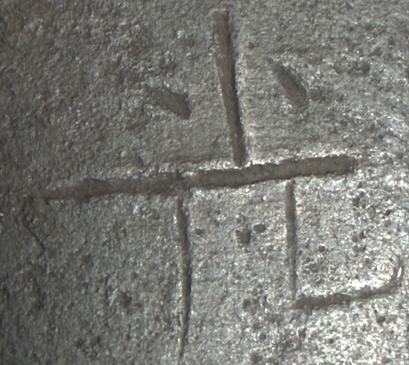

Lewis B Posted October 18, 2025 Author Report Posted October 18, 2025 Bringing this over from another thread. Many thanks to @Gakusee for providing better images from the hardcopy 2025 DTI catalogue. This has to be the most atypical Mei with NBTHK TH attribution to Shintogo I've come across to date. There are at least 4 or 5 departures from his normal style of signature, some glaringly different. Next question is which year did it pass TH. Quote
Zoglet Posted October 19, 2025 Report Posted October 19, 2025 16 hours ago, Lewis B said: Bringing this over from another thread. Many thanks to @Gakusee for providing better images from the hardcopy 2025 DTI catalogue. This has to be the most atypical Mei with NBTHK TH attribution to Shintogo I've come across to date. There are at least 4 or 5 departures from his normal style of signature, some glaringly different. Next question is which year did it pass TH. If I may butt in, the mei on this blade has a remarkable similarity to that of Awataguchi Sahyoe-no-jo Kunimitsu, from the lack of an s-like line in Kuni, to the wider, thinly cut square, and a slightly rounded lower right radical in the "Mitsu" kanji. Additionally, although the hamon is narrower in the Shintogo listed above, the blade does bear a resemblance to (especially in the jigane) this Awataguchi Kunimitsu signed tanto. I hope I'm not treading too far into unfamiliar waters. Just wanted to share some observations I saw looking at the mei and workmanship. Best Regards, Nicholas Quote

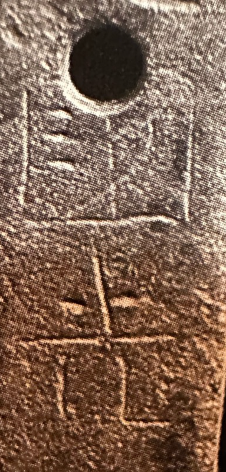

Lewis B Posted October 19, 2025 Author Report Posted October 19, 2025 Hi Nicholas, I completely agree. Something is not adding up. My immediate thought was the Kuni Mei was more in the style of Awataguchi school and Rai Kunimitsu than Shintogo. But then I looked at a few examples and thought they were too different eg the curved right element never intersects the vertical strike and he signed with 3 kanji. Daimei Kunitoshi Daimei Awataguchi Rai Kunimitsu Another option as you pointed out is this could be an earlier generation Awataguchi Kunimitsu. The Setsumei for the tanto you posted states This piece is tanto that should be judged as being by AWATAGUCHI KUNIMITSU, and has a date of manufacture of 1st Day of the 5th Month of 1288. He (the maker) was a toko that was said to be the son of Norikuni and the younger brother of Kuniyoshi, confirmed examples of work he left behind are rare, and besides this, there are but two Juyo Bunkazai tachi, and a ken which has SABEIJO (SABEJO) above his name, As for the portion of this tanto with the niji-mei KUNIMITSU, commonalities with the Juyo Bunkazai can be seen. I wonder if we are looking at a rare Awataguchi Kunimitsu tanto with Mei that is remarkably similar to the tachi you posted and mentioned in the text above. The suguha hamon is remarkably Shintogo-esque, although the Tachi demonstrate AK was capable of similar control of the hamon. What would be the preferred attribution? Rare Awataguchi Kunimitsu or Shintogo Kunimitsu? Could the attribution change at Juyo? Quote
Gakusee Posted October 19, 2025 Report Posted October 19, 2025 1 hour ago, Lewis B said: Hi Nicholas, I completely agree. Something is not adding up. My immediate thought was the Kuni Mei was more in the style of Awataguchi school and Rai Kunimitsu than Shintogo. But then I looked at a few examples and thought they were too different eg the curved right element never intersects the vertical strike and he signed with 3 kanji. Daimei Kunitoshi Daimei Awataguchi Rai Kunimitsu Another option as you pointed out is this could be an earlier generation Awataguchi Kunimitsu. The Setsumei for the tanto you posted states This piece is tanto that should be judged as being by AWATAGUCHI KUNIMITSU, and has a date of manufacture of 1st Day of the 5th Month of 1288. He (the maker) was a toko that was said to be the son of Norikuni and the younger brother of Kuniyoshi, confirmed examples of work he left behind are rare, and besides this, there are but two Juyo Bunkazai tachi, and a ken which has SABEIJO (SABEJO) above his name, As for the portion of this tanto with the niji-mei KUNIMITSU, commonalities with the Juyo Bunkazai can be seen. I wonder if we are looking at a rare Awataguchi Kunimitsu tanto with Mei that is remarkably similar to the tachi you posted and mentioned in the text above. The suguha hamon is remarkably Shintogo-esque, although the Tachi demonstrate AK was capable of similar control of the hamon. What would be the preferred attribution? Rare Awataguchi Kunimitsu or Shintogo Kunimitsu? Could the attribution change at Juyo? Both are desirable attributions. Given that I personally prefer rarity, I would value the Awataguchi one more. But Shintogo is extremely highly rated and commercially a source of great profits for dealers. So if the TH certificate does not specify anything besides the signature, a dealer could insert their own interpretation that this is “Shintogo”. So, you either have a daimei work here or indeed you are veering towards Awataguchi / Rai. But one needs to explore “Mitsu” too as you have focused entirely on the “Kuni” above. Look at the direction of the horizontal strokes and the overall crown in “Mitsu”. 1 Quote
Lewis B Posted October 19, 2025 Author Report Posted October 19, 2025 The mitsu character is very similar (horizontal crown strikes), although not a perfect copy of the dated Awataguchi Kunimitsu tanto (no upward strike on lower right radical) and also divergent from the exemplar Shintogo signatures. I will ask if the dealer is willing to send a copy of the TH papers. I'd already sent emails regarding a couple of his other offerings but yet to get a reply. This Shintogo Kunimitsu tanto dated 1315 and part of the Masamune Sano Exhibition also contains many of these anomalous features. Not the usual left-handed kuni character, but more similar to kuni by Kunitsuna and Kunimune. Absence of Mitsu north crown feature. Suggests daimei by someone connected with the atelier (Kunihiro ?). Quote
Zoglet Posted October 19, 2025 Report Posted October 19, 2025 5 hours ago, Lewis B said: The mitsu character is very similar (horizontal crown strikes), although not a perfect copy of the dated Awataguchi Kunimitsu tanto (no upward strike on lower right radical) and also divergent from the exemplar Shintogo signatures. I will ask if the dealer is willing to send a copy of the TH papers. I'd already sent emails regarding a couple of his other offerings but yet to get a reply. This Shintogo Kunimitsu tanto dated 1315 and part of the Masamune Sano Exhibition also contains many of these anomalous features. Not the usual left-handed kuni character, but more similar to kuni by Kunitsuna and Kunimune. Absence of Mitsu north crown feature. Suggests daimei by someone connected with the atelier (Kunihiro ?). I agree with a protential daimei being possible in that instance, but to this day I've not seen a Kunihiro sign using anything except the typical left-handed "Kuni" mei. Even looking at this work, the same curve in the lower right radical, alongside the horizontal crown in the "Mitsu" kanji. Looking at handwriting, it almost makes me wonder whether A.Kunimitsu and S.Kunimitsu had a closer relationship than just originating from the Awataguchi School (perhaps made dai-mei for one another). Of course, this could be merely a smith I'm unfamiliar with from the Shintogo/Ko-Soshu atelier, but I can't help but admit this resemblance in writing has me a bit perplexed. Good luck to everyone in determining this blade! Nicholas Quote
Zoglet Posted October 19, 2025 Report Posted October 19, 2025 6 hours ago, Gakusee said: Both are desirable attributions. Given that I personally prefer rarity, I would value the Awataguchi one more. But Shintogo is extremely highly rated and commercially a source of great profits for dealers. So if the TH certificate does not specify anything besides the signature, a dealer could insert their own interpretation that this is “Shintogo”. So, you either have a daimei work here or indeed you are veering towards Awataguchi / Rai. But one needs to explore “Mitsu” too as you have focused entirely on the “Kuni” above. Look at the direction of the horizontal strokes and the overall crown in “Mitsu”. I agree that seeing the TH papers for this blade would go a long way into helping us determine the legitimacy of the appraisal, alongside determining whether the "Shintogo" element is official from the NBTHK or added by the dealer. Going into another direction, I don't believe the blade is feasible for Rai. Looking at a color photo I found of the DTI Shintogo tanto, We see a very tight ko-itame hada with what appears to be minimal burls of mokume and primarily what appears to be masame. The appearance is also generally "wet" like Kunimitsu's peers in the Awataguchi School. The koshi-hi on the tanto-ura also screams Awataguchi to me, since we see that style in some tanto by Kuniyoshi and Norikuni (daito too, but in this case, we are discussing tanto). Additionally, the mei is extremely atypical for Rai-mei, as has been discussed above. I agree with you, Michael, that blades of greater rarity are of more value to me, so this work generally piques my interest, especially as an item that requires more research. Whoever ends up with this work has their work cut out for them. All the best, Nicholas 2 Quote

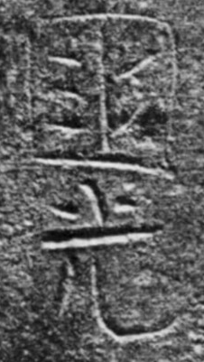

Zoglet Posted October 19, 2025 Report Posted October 19, 2025 As an added reference, was also able to locate a mei of a ken signed "Sahyoe no Jo Fujiwara Kunimitsu" and dated to either Showa 1 or Showa 10 (mei is corroded at the date) with the similar features to the atypical Shintogo Kunimitsu mei. Photo is displayed below. Quote

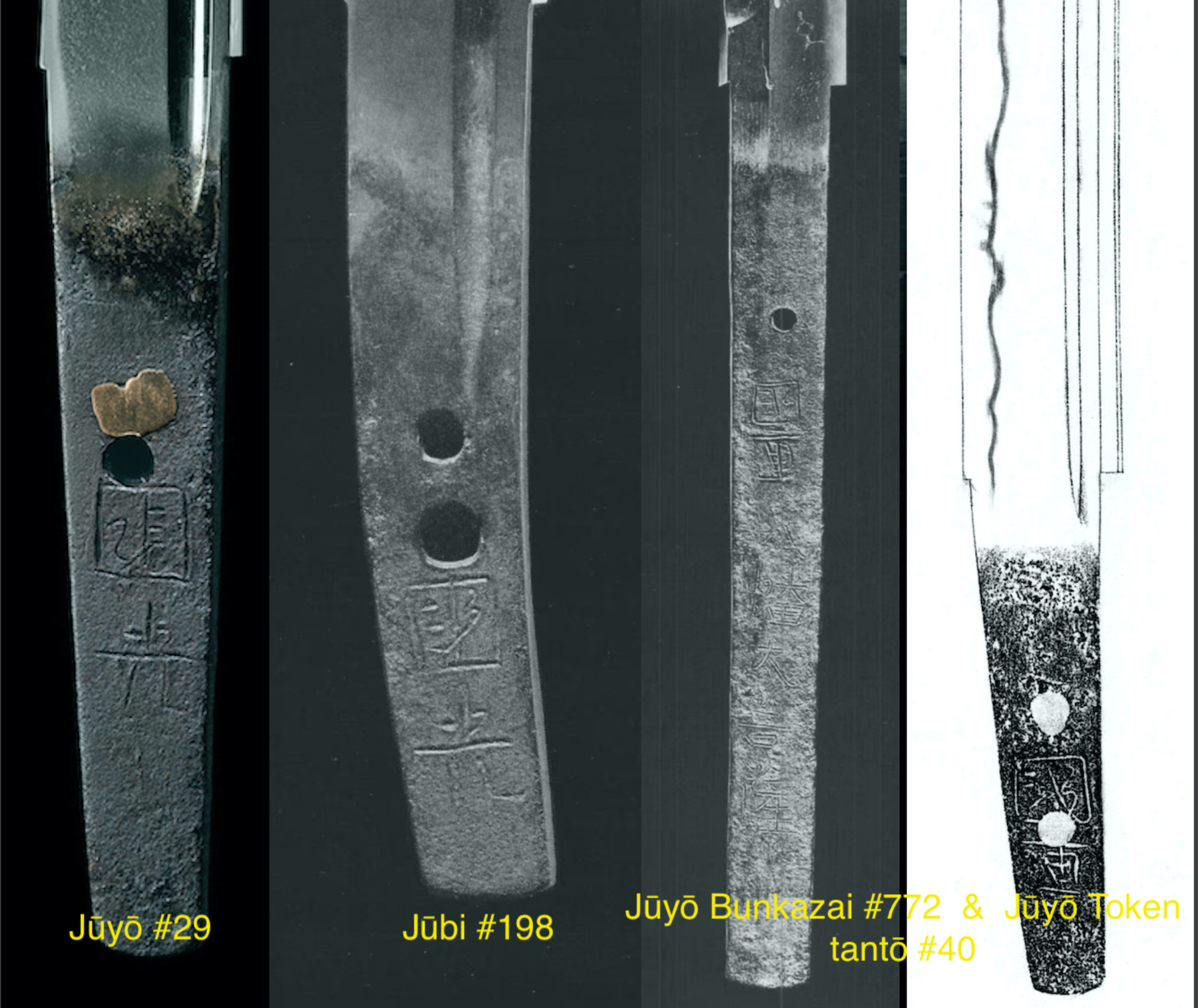

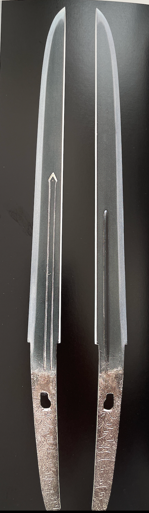

Gakusee Posted October 20, 2025 Report Posted October 20, 2025 So get back on track… 1. Attached is the famous (and sublime) Awataguchi Kunimitsu JuBu. Different chisel strokes and style. 2. The DTI tanto is actually the one in the Fujishiro Koto volume. So, it must have some additional history and probably documented provenance etc but this does not mean it is not daimei by one of the students. The more I look into it the more daimei it seems. 3 Quote

Lewis B Posted October 20, 2025 Author Report Posted October 20, 2025 If you're correct about masame in the DTI blade Nicholas, it could be by Hasebe Kunishige (Markus indicates a connection with Shintaro Kunimitsu, same smith?). The data is inconclusive although the masame points to Yamato influence. The 'wet' appearance of the steel also fits. KUNISHIGE (国重), 1st gen., Kenmu (建武, 1334-1338), Yamashiro – “Hasebe Kunishige” (長谷部国重), real name Hasebe Chōbei (長谷部長兵衛), it is said that he came originally from Yamato province where his ancestors lived in Nara´s Hatsuse (初瀬), there exists the tradition that the family name Hasebe was, over “Hase,” a modification of the pronunciation of “Hatsuse,” another theory says that he was the son of Senju´in Shigenobu (千手院重信), so it is assumed that his roots were in the Senju´in or in the Taima school, some sources state that he moved to Kamakura to study as late student under Shintōgo Kunimitsu (新藤五国光) before he finally settled in Kyōto/Yamashiro, this is supported by the tradition that Kunimitsu too bore the family name Hasebe, some even assume that Kunishige was the son of Shintōgo Kunimitsu, however, he moved around Kenmu to Inokuma (猪熊) in the Bōmon district (坊門) in the vicinity of Kyōto´s Gojō axis (五条), he is listed as one of the “Ten Students of Masamune,” unfortunately no signed works are extant by the 1st generation Hasebe Kunishige, his most famous work is the meibutsu Heshikiri-Hasebe (圧し切り長谷部) which was once the favourite sword of Oda Nobunaga, this and other ō-suriage-mumei blades have a wide mihaba, a thin kasane, a shallow sori, and an elongated kissaki, the mune is iori or maru, the jigane is a dense ko-itame which tends to masame towards the ha and the mune, the hamon is a notare mixed with gunome with plenty of hataraki within the ha like ashi, yō, sunagashi and kinsuji, towards the upper blade section also tobiyaki appear which can turn into a hitatsura, the bōshi is midare-komi with hakikake and a somewhat pointed kaeri, unsigned blades of the 1st and 2nd gen. are hard to differentiate, the jigane of the 1st gen. looks more “wet” and “sticky” whereas the ha is more bright, jōjō-saku ⦿ 1 Quote
