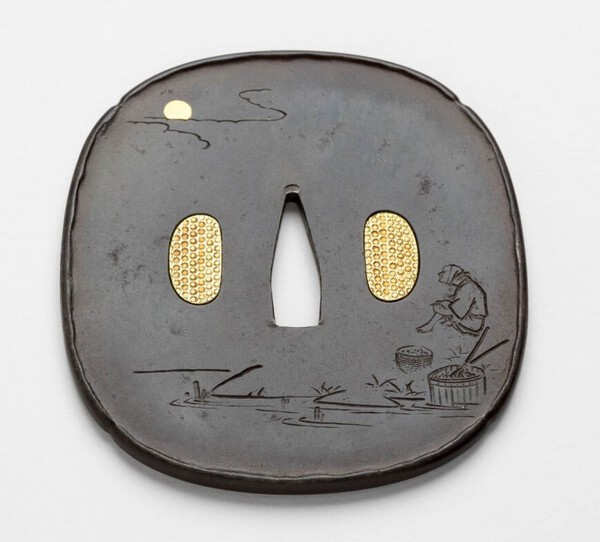

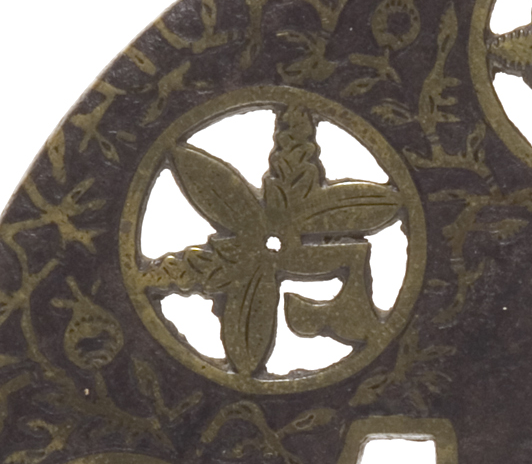

Spartancrest Posted July 26, 2024 Report Posted July 26, 2024 The Spencer Museum of Art in the University of Kansas has a nice modest collection of tsuba - around 250 https://spencerartap...#/search/works/tsuba But I don't know who is describing the collection or how much they know about the more common schools of artists. Kinai School Description: Tsuba, radish and leaves pierce work. [ Not even close!] https://spencerartap...-search#/object/4756 https://spencerartap...-search#/object/4888 A cast copy [very common] see https://www.ebay.com.au/itm/226138221756 https://spencerartap...-search#/object/4836 Description: Tsuba, two leaves (blood stain corrosion) [clearly Kinai school design, "Blood stain corrosion" - how do they make that conclusion?] https://spencerartap...-search#/object/4818 Description: Tsuba, shibuichi nanako - kiri and passion flowers and leaves. Then they go on to say made of Iron - obviously Sanmai construction. Wrong descriptions are not restricted to just this museum of course - you need to be vigilant and keep your eyes open though. 4 1 2 Quote
kissakai Posted July 26, 2024 Report Posted July 26, 2024 In the Birmingham museum some of the labels/descriptions had got mixed up "All the right notes but not necessarily in the right order" 4 Quote

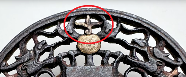

Steves87 Posted July 26, 2024 Report Posted July 26, 2024 On a slight bend of the topic, that first yoshiro mon Tsuba is the first I have seen where a mon has a (Kiri?) Stalk. 1 Quote
Spartancrest Posted July 26, 2024 Author Report Posted July 26, 2024 1 hour ago, Steves87 said: a (Kiri?) Stalk. That is what I thought - never seen that before, not sure I like it much as a design - looks like something went wrong [That's what happens when you mix Yoshiro with Kinai ] 2 1 Quote

Spartancrest Posted August 2, 2024 Author Report Posted August 2, 2024 I just noticed a very small detail on an image sent to me by Steves87 on a namban guard. It struck me as being similar to the Mon from the Yoshiro guard [described as 'Kinai' by the museum] with the addition of two flower racemes. Just a coincidence? 1 Quote

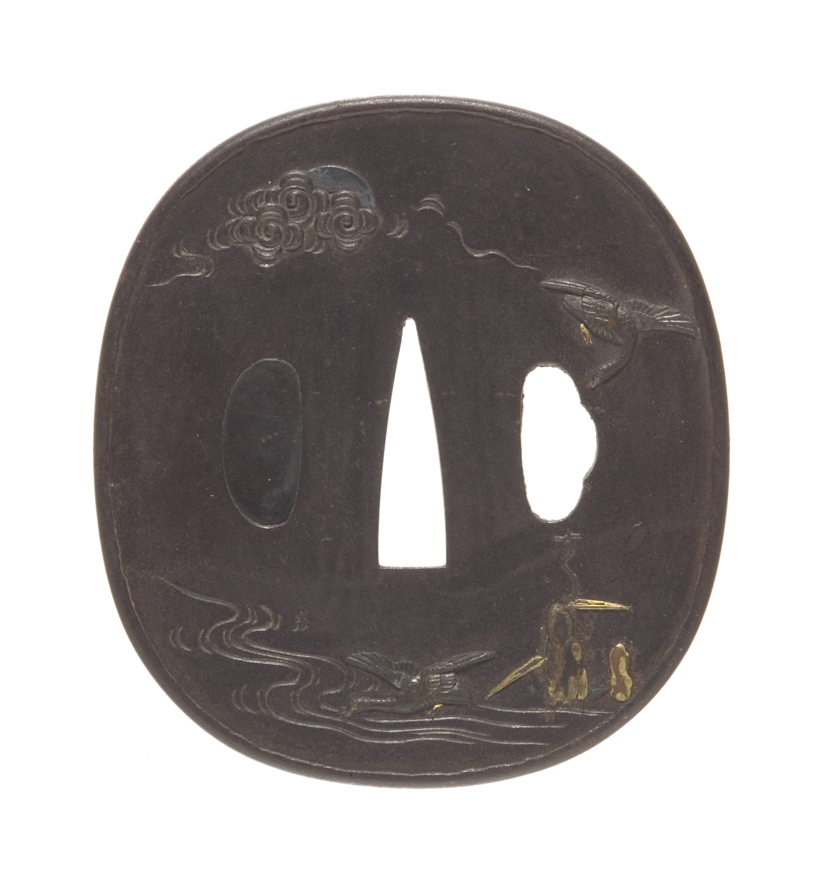

Spartancrest Posted August 3, 2024 Author Report Posted August 3, 2024 Sorry but this must be the most out there description I have seen from a museum. https://spencerartap...-search#/object/4922 Description: Tsuba, foolish crow tries to dive like duck, drowning verso. No one is "drowning" and the jury is still out on the crow thinking it was a duck! Apparently birds are not allowed to just sit on a tree stump in this particular marshland - perhaps there is a parking meter or it was in a handicap zone? [Parking meter - that would explain the suicide attempt!] Hold that thought - maybe this is the most out there description! Description: Tsuba, man washing potatoes with two sticks. Exactly where are the potatoes? A man or a woman? Looks like laundry day to me - no real idea but like I say "where are the potatoes?" Those two sticks wouldn't wash a potato they would more likely mash them! Also that is the strangest colour of iron I have seen. Anyone with a spare set of glasses for the museum staff? https://spencerartap...-search#/object/4903 1 4 Quote

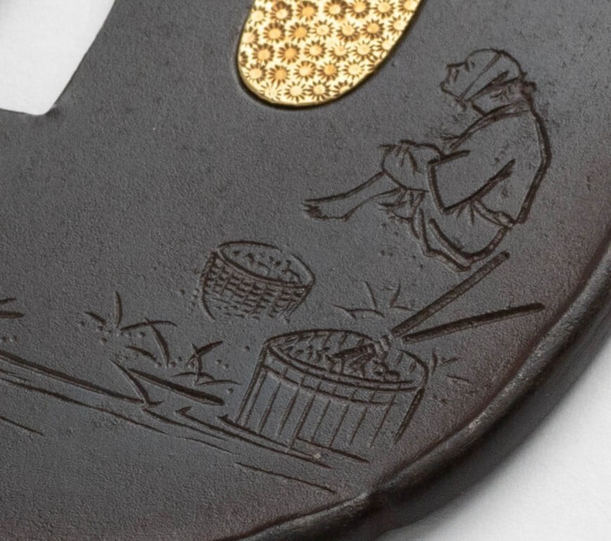

Kanenaga Posted September 18, 2024 Report Posted September 18, 2024 Concerning Dale's tsuba from the Spencer Museum supposedly showing a man washing potatoes, but no potatoes to be seen -- well, here's another with the same theme, including the 2 sticks. This one is by Goto Ichijo, and the potatoes are presumably in the basket. So maybe this is a real theme? Title: Tsuba with a picture of sweet potato washing under the moon 2 Quote
Toryu2020 Posted September 18, 2024 Report Posted September 18, 2024 芋洗い Most likely Sato-imo - Google imo-arai and check images it is indeed a real thing... Quote
Brian Posted September 19, 2024 Report Posted September 19, 2024 Amazing how much can be depicted with just a few strokes of a chisel. You can see why the truly talented guys are so highly regarded. 1 1 Quote
