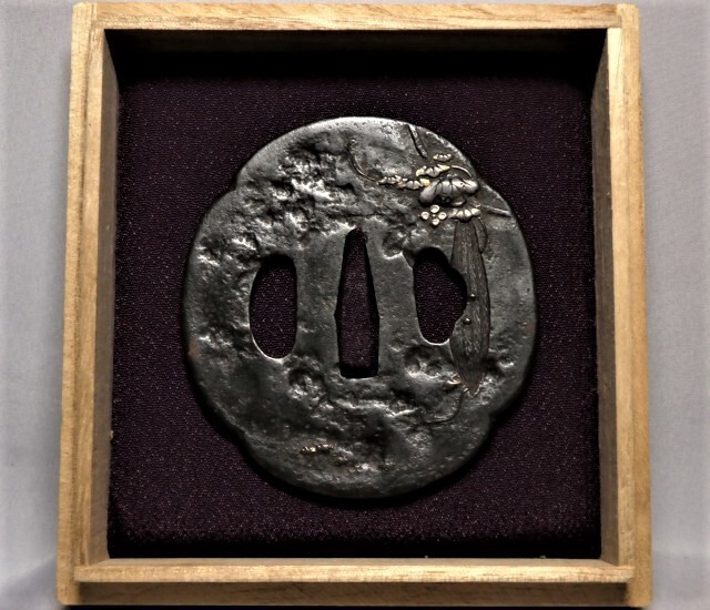

cluckdaddy76 Posted March 28 Report Share Posted March 28 I am attempting to sort out and save a collection of blades and fittings of which I am now the new owner. I have mostly been reading books on swords as recommended, but I enjoy the fittings as much as the swords. Here is one of the tsuba as an example. I guess first, I would hope someone with knowledge can tell me that this tsuba is not a modern fake. If we get past that part and it is real, is this something that could and should get papered? I am the type of collector who will want only better-quality items, and ideally, I would like to authenticate and paper anything I can, but this is also just a bit of personal preference. If anyone can translate mei, that would be an extra bonus, I appreciate any help I can get. Also. not thrilled with the quality of my pictures, for example in hand the golden dragon's carving looks much more detailed. 1 1 Quote Link to comment Share on other sites More sharing options...
Spartancrest Posted March 29 Report Share Posted March 29 I can't help much with the mei could it be 奈良利奇 Nara Togi ki [?], but it is not modern. A very nice guard but not top of the range, have you noticed the staff of the monk is a little bent? A little oxidation on his forehead? Inlay name plate of silver(?) Typical style of the Nara school. https://tw.daigobang...html?aID=m1096643842 https://tsuba.jyuluc....com/NaraSchool.html Quote Link to comment Share on other sites More sharing options...
cluckdaddy76 Posted March 29 Author Report Share Posted March 29 48 minutes ago, Spartancrest said: I can't help much with the mei could it be 奈良利奇 Nara Togi ki [?], but it is not modern. A very nice guard but not top of the range, have you noticed the staff of the monk is a little bent? A little oxidation on his forehead? Inlay name plate of silver(?) Typical style of the Nara school. https://tw.daigobang...html?aID=m1096643842 https://tsuba.jyuluc....com/NaraSchool.html Quote Link to comment Share on other sites More sharing options...
cluckdaddy76 Posted March 29 Author Report Share Posted March 29 I was curious on the forehead and other's opinions. I thought it looked like oxidization; had a long shot someone would tell me it was a mask. It seems a lot of people like these style tsuba, for some reason I am really attracted to different styles of iron tsuba more than softer metals such as this one, Don't get me wrong, I still think this is a decent piece, thanks for your response. 1 1 Quote Link to comment Share on other sites More sharing options...
SteveM Posted March 29 Report Share Posted March 29 奈良利壽 Nara Toshinaga Not an authentic signature. 2 Quote Link to comment Share on other sites More sharing options...
Gunome Posted March 29 Report Share Posted March 29 Hello, This is a nice tsuba. It is a genuine Japanese and not a chinese fake. I cannot tell if mei is good or not but I like it. 1 Quote Link to comment Share on other sites More sharing options...
Steves87 Posted March 29 Report Share Posted March 29 I have seen a few (probably 4) Nara guards in the past with a zogan covered mei, it appears to be something they did. I have one myself, and if I'll take a semi-educated guess, I'd say your guard was similar to mine, and the zogan (however it was fixed) has fallen off. I imagine the base plate has the mei (as with your example) and then the zogan material is depressed into the mei characters. I have asked here on the forum about this practice with the mei, it was a few years ago, but I don't think there were any definite answers. 3 Quote Link to comment Share on other sites More sharing options...

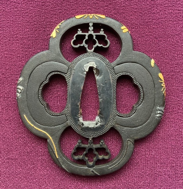

Infinite_Wisdumb Posted March 29 Report Share Posted March 29 I would not paper anything that you have a good idea of the provenance of. I have learned over the last few years of my study that papers are just educated guesses on the attribution of the piece and are relatively worthless as a value added addition to an item. Many times, different appraisers provide different attributions, thusly nullifying the effort and burning your $$. An example below. I know this is Owari Kinko. If i send it to get papered, it will come back and Tokubetsu Hozon to Owari Kinko. Now the question is, why would i spend $250 to paper it? 5 2 1 Quote Link to comment Share on other sites More sharing options...
Infinite_Wisdumb Posted March 29 Report Share Posted March 29 Another example. Papered to "Shoami". Shocker! 2 Quote Link to comment Share on other sites More sharing options...
Infinite_Wisdumb Posted March 29 Report Share Posted March 29 I’ve tried to sell the above Shoami for the cost of the papers ($250) and nary a nibble. Tread cautiously grasshopper! 2 Quote Link to comment Share on other sites More sharing options...
