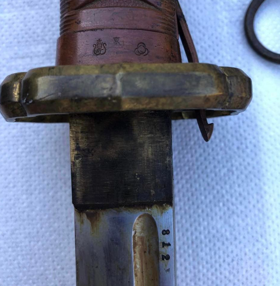

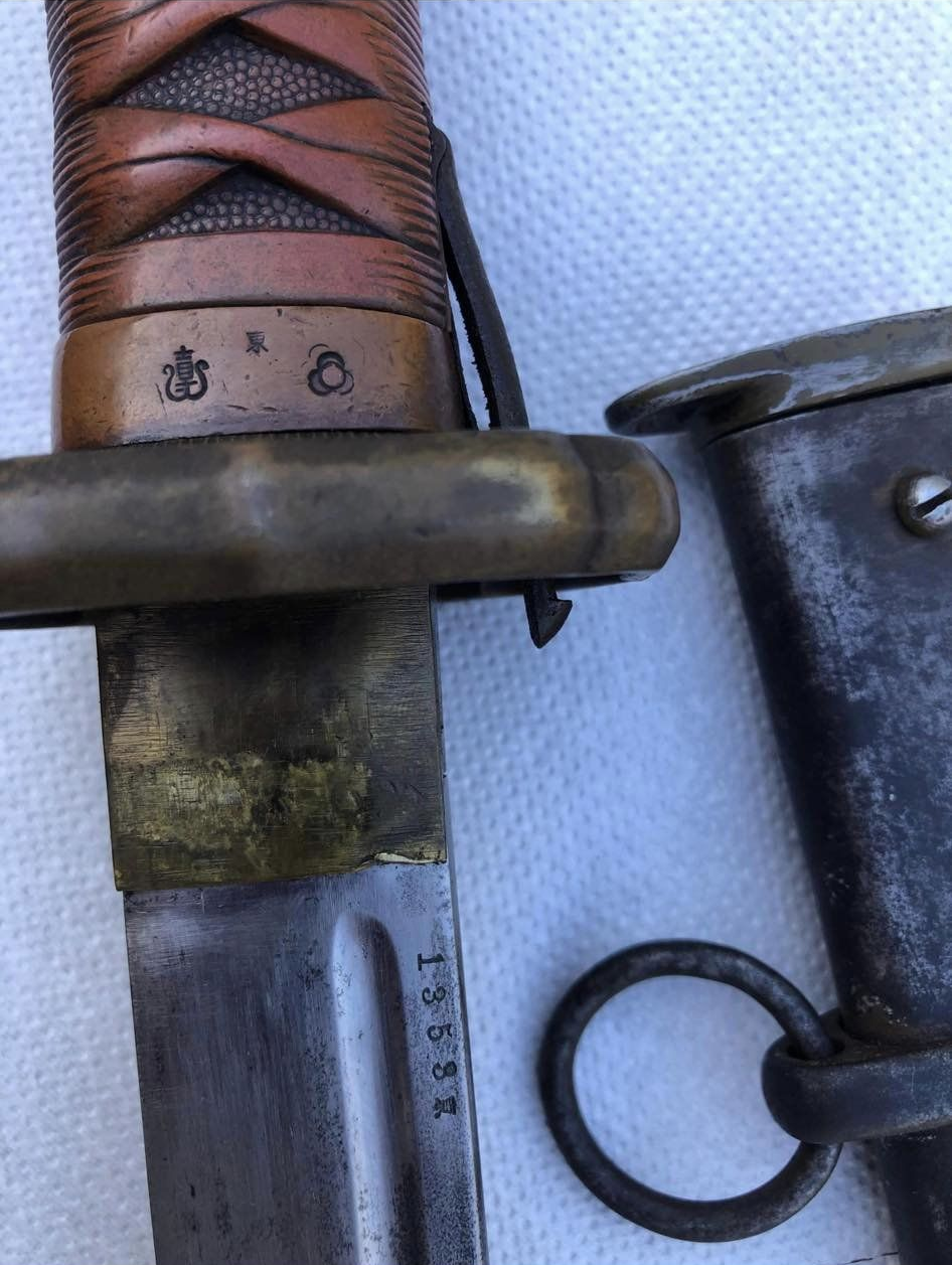

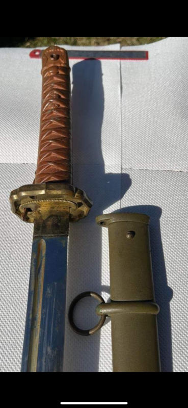

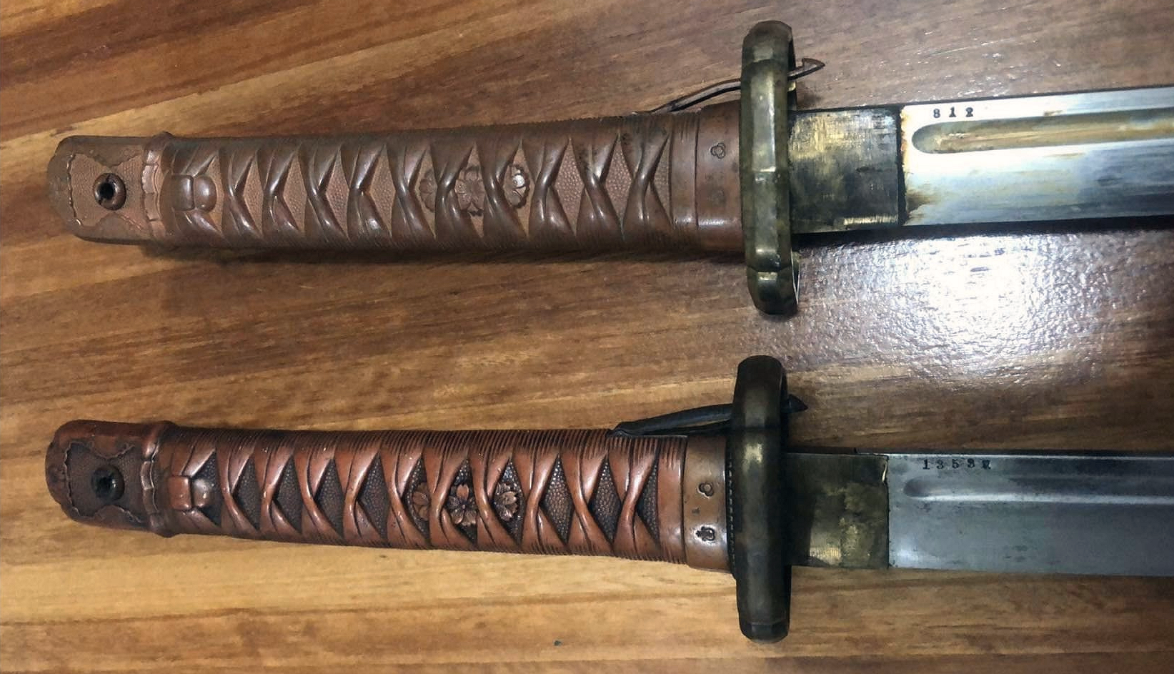

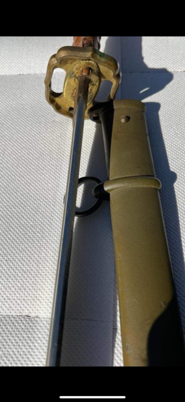

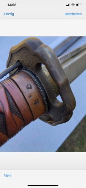

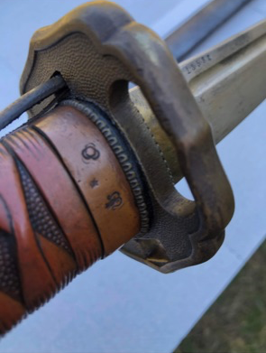

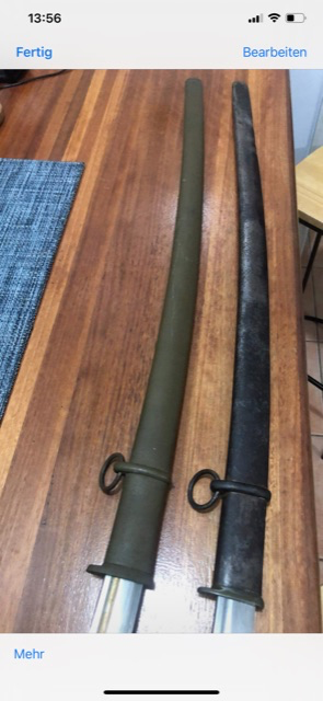

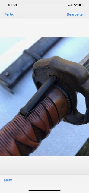

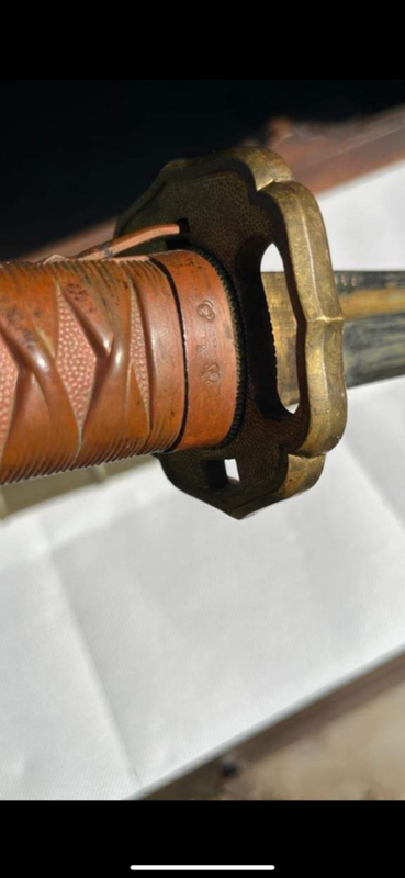

hope for opinion from a sword expert. I know what it is and it is exactly what I am looking for. So these Shin Gunto Type 95 with cooper hilt are offered to me.
One of the sword is in excellent condition, numbered #812, the other one #1353 is in average condition.
Well, I am a rookie and need help by experts. As I can see there is nothing that conserns me.
Stamps good, numbers good etc.
Is there anything that I‘ve overseen and that should be spoken about?
Please have a look and let me hear your thoughts about.
Thank you!
Markus
Ps. Pictures may be a bit mixed up, but that‘s my mobile. I also got some short films but don‘t know how to save and giv‘em to here. Will come soon
Hello Markus
that one looks legit.
Overall the pictures are very small. Could you load up bigger ones to see the details like Stamps, Numbers, Kissaki, bo-hi and the tsuka?
Ah sorry i see the inspection mark is direct on the number so i thought its 1xxxx :laughing:

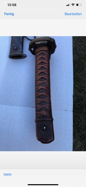

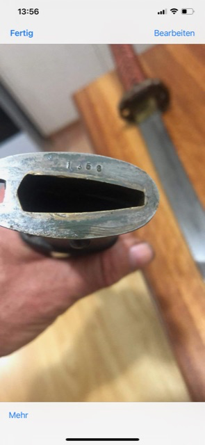

Two questions for other 95 collectors before throwing my hat in the ring......
1. Is the number 812 on the saya throat, upside down or is it that I just haven't seen any coppers with this orientation? (1353 looks ok)
2. Why do you think it is that the later numbered sword (1353) has an 'age appropriate' saya and tsuba finish but a pristine tsuka finish? They don't seem to match unless tsuka has been cleaned.

Markus you should upload better pics to judge it. The best way to see if its fake or not is to flash it with the camera. I should be glowing reddish from the patination and the tsuba should be shine golden.
The stamps looks good.
Note that the copper ones where patinated with niage rokkoshu. In the books is written that these were not patinated - thats not true. All copper work in Japan was patinated to get that look. The fakers didn't do that.
Here is a genuine example (from the web)
WW II Japanese Samurai Army COPPER HANDLE NCO Sword -Antique/Old WW2  Collection | St Croix Blades
This one here was sold over an auction house and it is fake in my opinion.
The tsuba looks bad, the habaki is thin and sloopy. The bo-hi looks crude, the clipper looks like cheap thin metal...
That one is from the plimpton collection which i didn't like because of the paint job. But its a real one.

I did not comment on the swords as the pictures are just too pixelated to make out the details.  However, based upon the pictures posted by Chris above, they both appear genuine to me.  I would like to point out that both Bruce & Rob own copper-handled swords and are more than qualified to pass judgement.  Not sure if Chris or Dan have a copper or not.  Disclaimers aside, the best person to ask is not mentioned above, mainly @Stegel.
As I find serial number 812 the better of the two, I would like to see the following pictures if possible.
Both sides of the handle.
A clear picture of the scabbard throat showing the serial number.
A picture of the scabbard drag or in this case the brass plug.
And most important of all, an overall picture of the sword with the scabbard placed below the blade.

Congratulations Markus!
A very nice sword, i agree with the others that both are genuine swords.
Did you get both of them or only one?
