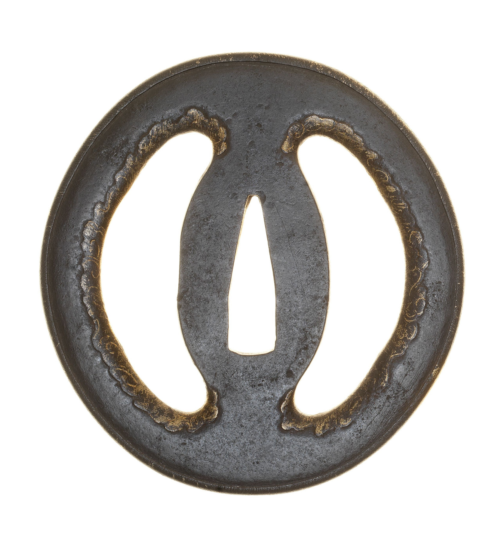

I am taking the liberty of reviving this thread because I am currently writing an article about sword guards featuring large, symmetrical lateral cutouts (sayū-ō-sukashi). I would welcome some informed opinions on a hypothesis—one I was quite surprised not to find in the preceding posts—regarding namako sukashi tsuba and the idea that they really depict sea cucumbers (or sea slugs, depending on the preferred translation).
Does it not seem possible—I hesitate to say probable—that this type of inlaid decoration and "lacelike" cutout work represents, in a more or less stylized manner, the appendages or podia of certain species of holothurians?
And to follow up on the idea of photorealism and the sea cucumber image posted by Thomas, I’m putting forward this tsuba (which I think is superb)!

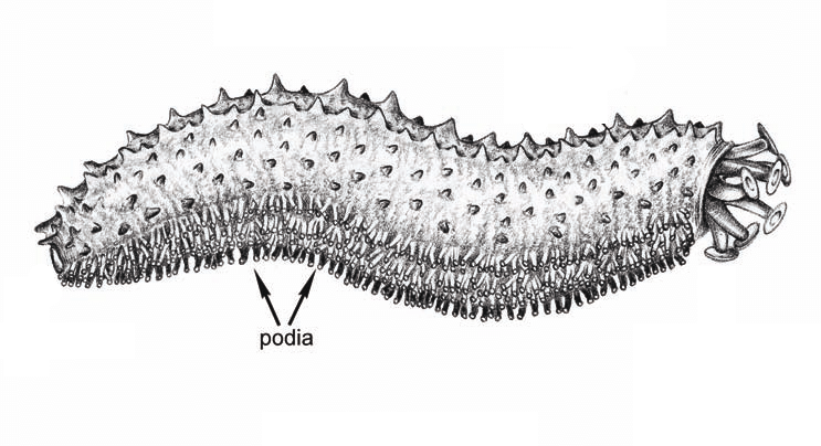

image.thumb.png.f9d4f041ab0d39d5f55e0bf8d6c21774.png  With the number of species - it is not unreasonable to suggest that many variations of namako tsuba are possible, not just one standard form.
I guess each maker might have been familiar with what type of sea cucumber was for sale locally?  From a thread https://www.militaria.co.za/nmb/topic/37315-value-reduced/#comment-386984

Nicolas,
I do not believe that the HIRATA TSUBA pictured above (and the other one) attempts to emulate the PODIA of sea cucumbers. It would not be the intent of TSUBA artisans to create realistic copies of nature. In my opinion, these small SUHAMA-like decorations were meant to "soften up" the very stern basic shape of the NAMAKO TSUBA.
My observation is that a pleasing, balanced shape with inherent functionality can be found in most TSUBA, especially in the iron ones.
Speaking of "oversized" HITSU ANA, I am attaching a TEIMEI TSUBA as example plus two "NAMAKO" TSUBA in HEIANJO style

Thanks for your comments and the other examples, Jean!
It turns out I own two namako-sukashi guards in the Heianjō style that are quite similar to these.
While the presence of notches at the seppadai on certain namako guards—those lacking specific borders for the accessory holes—effectively validates the opportunistic use of the openwork spaces as "oversized" hitsu-ana, I am more skeptical about the idea that this was the design's original function. I tend to think, rather, that the motif stems from a desire for balance and a reduction to the essentials.
However, I may have misinterpreted your message and your inome-sukashi example, as I assume you don't actually view those two heart shaped openings as hitsu-ana?
Nicolas,
you are certainly correct in that the SUKASHI of the TEIMEI TSUBA are not usable as HITSU ANA. I showed it more as a general example of "big openings". The HIRATA TSUBA below (not mine) is probably more functional in this respect.
I also think they are just an abstract design - and the tosogu world has, through custom and convenience, applied the name "namako" or "namako sukashi". The main reason I doubt they are artistic representations of sea slugs is that we don't find sea slugs in any other related item. No sea slugs on menuki, fuchi/kashira, kozuka, armor, family crests, etc... And you don't find any positive relief images, or inlaid images of sea slugs. It's just not a thing, and if tsuba artisans were so impressed with the sea slug as an image, one would expect to find sea slugs elsewhere in Japanese crafts.

I don't think that Miyamoto was attempting to depict a namako. This is probably a fanciful description by some collector at a later time. As is shown in some of the images above, this bilobe design was popular from before Miyamoto or the Higo tsubako. More general discussion of bilobe tsuba here.

The HIRATA TSUBA below is probably more functional in this respect.
I own that one. There are very similar Hirata tsuba in softmetal. I think the design is matsu, or pine boughs, and the Hirata possibly made these for the Matsui clan.
Ah yes, I remember selling that one circa late 2014 or early 2015.
