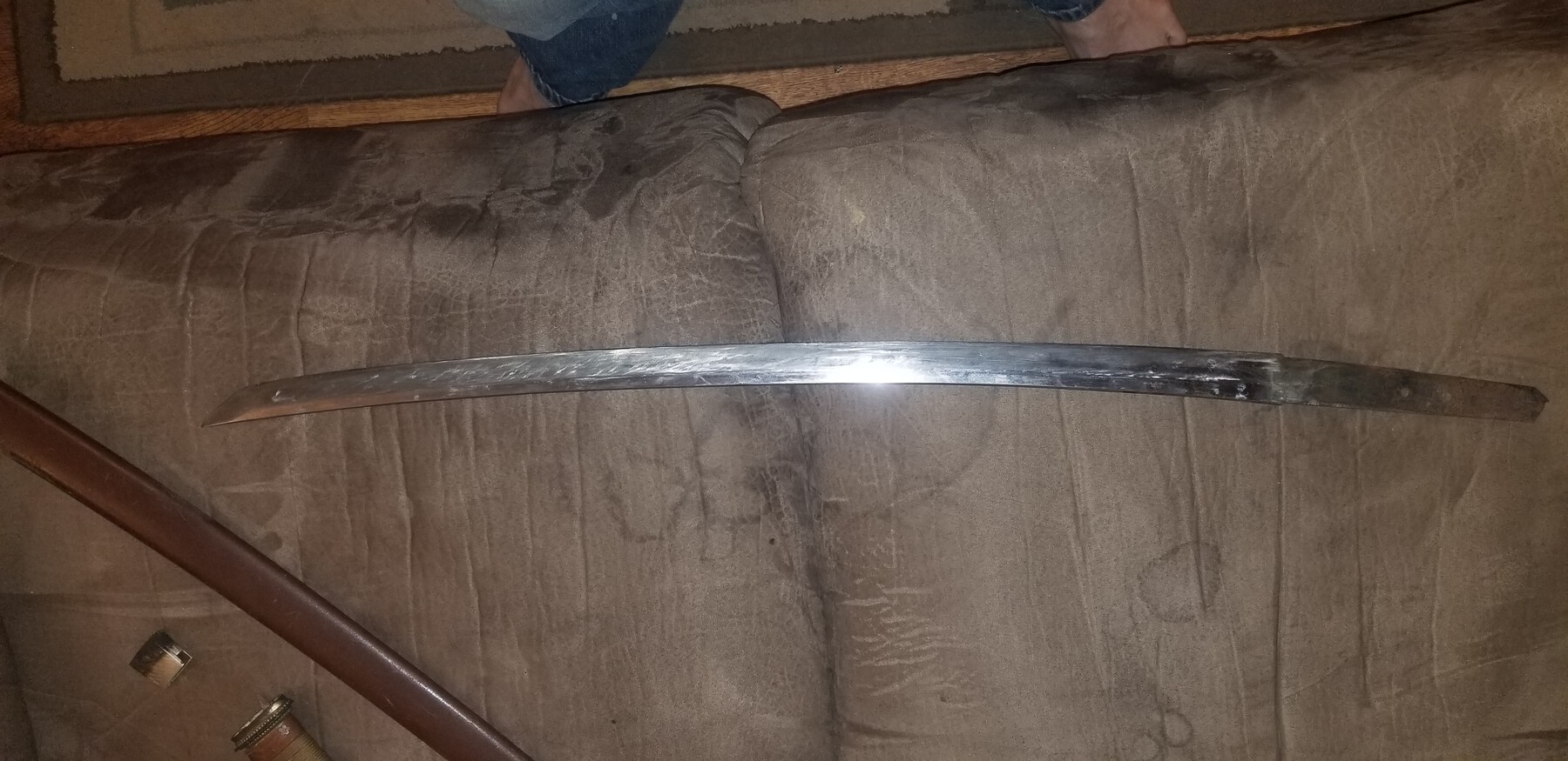

Hello,
I'm looking for any information that can be offered on this sword I inherited from my grandfather. It has hung on his wall my whole life (I'm 44). Unfortunately he passed away without saying much about it and I was never allowed to touch it until he passed. As the story goes he found the sword in the attic of the house he and my grandmother bought when he came back from thre war (he was in the European Theater). The guy they bought the house from had fought in the Pacific. The Tsuba is missing obviously. I can find no discernable marks, stamps, signatures or writing of any kind on the sword. The handle appears to be silk wrapped over ray skin. The inside of the sheath is wood. Best i can tell from my limited research is that it is an officer's sword from WWII, possibly a type 94 or 95. Outside of that I really only have theories about the sword, it's history and it's given condition.  I'll attach photos. Please let me know if there are any other detailed photos that might help. Thanks in advance for any info you can provide.
Hi David

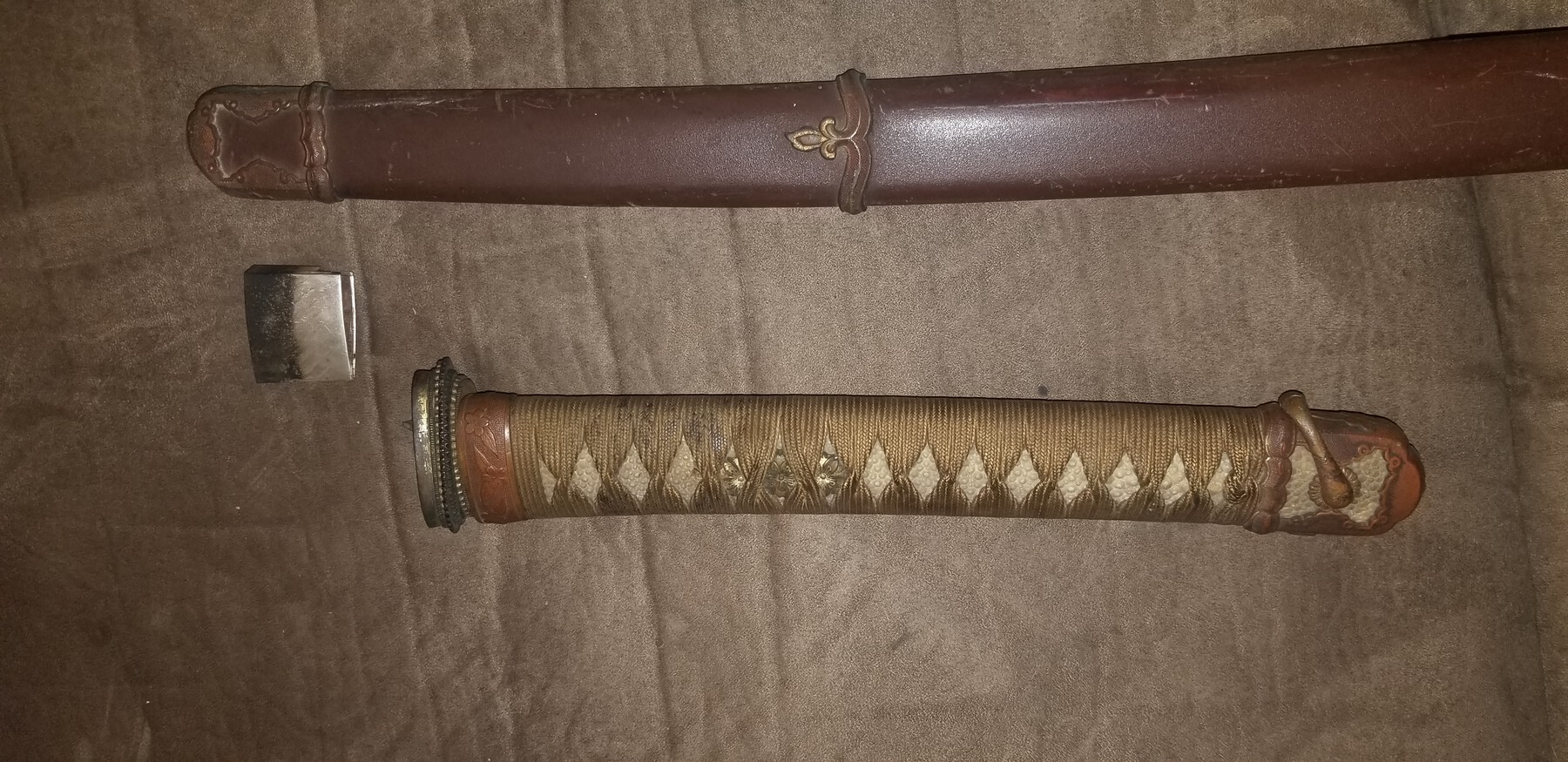

Yes, an authentic Type 98 Shin Gunto, the blade is an old one in pretty rough condition and the Nakago (tang) has been altered quite crudely. I suspect this may have been originally mounted in Kyu Gunto mountings which preceded the Type 94/98. This appears to be a mount of good quality, I can see a family crest on the Kabutogane (end of handle) and what appears to be a rare dust seal Seppa that provides extra protection to the Saya (sheath). If you could get some more photos of this it would be appreciated as they are fairly rare.

Can you take close ups of the blade itself? Tip, temper line, ...etc.

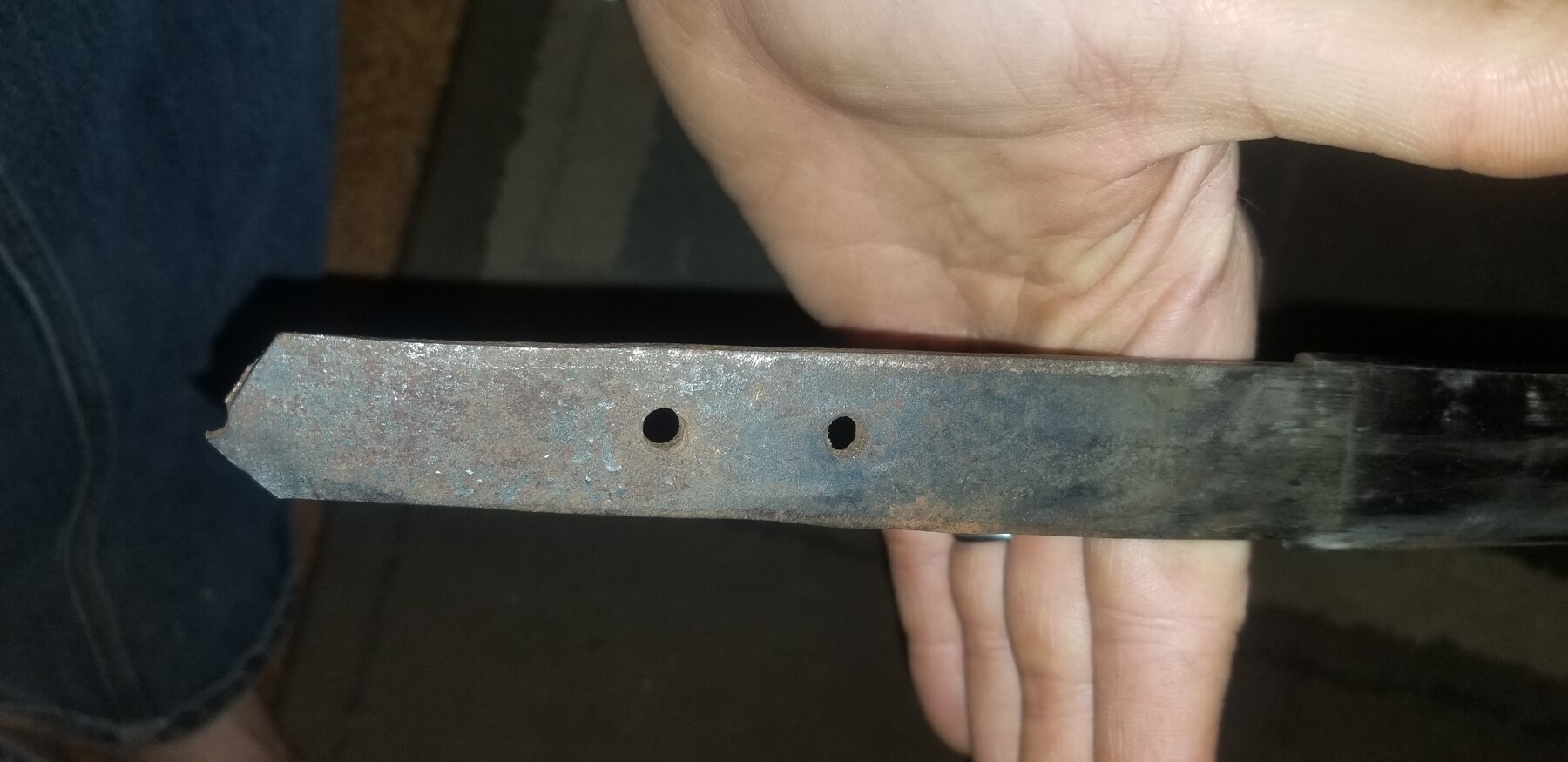

I have a feeling we may have something interesting here. It must have been a very long sword once (the tip of the tang shows the remain of what was possibly the first hole, so long sword, ō-kissaki... very interesting.
I'm away from PC and look on to the pictures from my smartphone.
For me it looks like someone stick a junk chinese Blade as tsunagi into a nice koshirae.
Crude shape, terrible nakago.
But as i wrote i look here from the work with a smartphone....

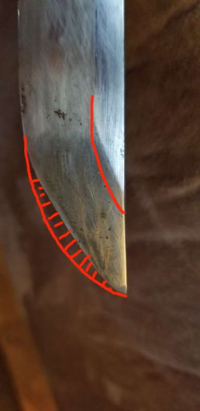

I'm also dubious about the blade. Not the fittings. But that nakago is horrible. Even the shape. can we get a closer pic of the tip? Looks very angled.
David,
I would really help to get clear, close-ups of the blade tip, and maybe one or two clear close-ups of sections of the blade, with any attempt to see the temper line (hamon).  Like the other guys say, this could be something really interesting or Chinese crap, nothing in between!
Even if the blade turned out to be fakery, like John said, the fittings are special.  Haven't seen that family mon (crest) before and I can't say I've ever seen a dust-cover seppa on a Type 98 before.  Even so, it's rare.
Like to see those close-ups!
This is the shape. Look a the shinogi and the yokote. And take a look on the boshi. Ok the condition is bad, but this didn't fit to Japanese swords. The blade looks chinese made for me.
The koshirae is authentic, no question.

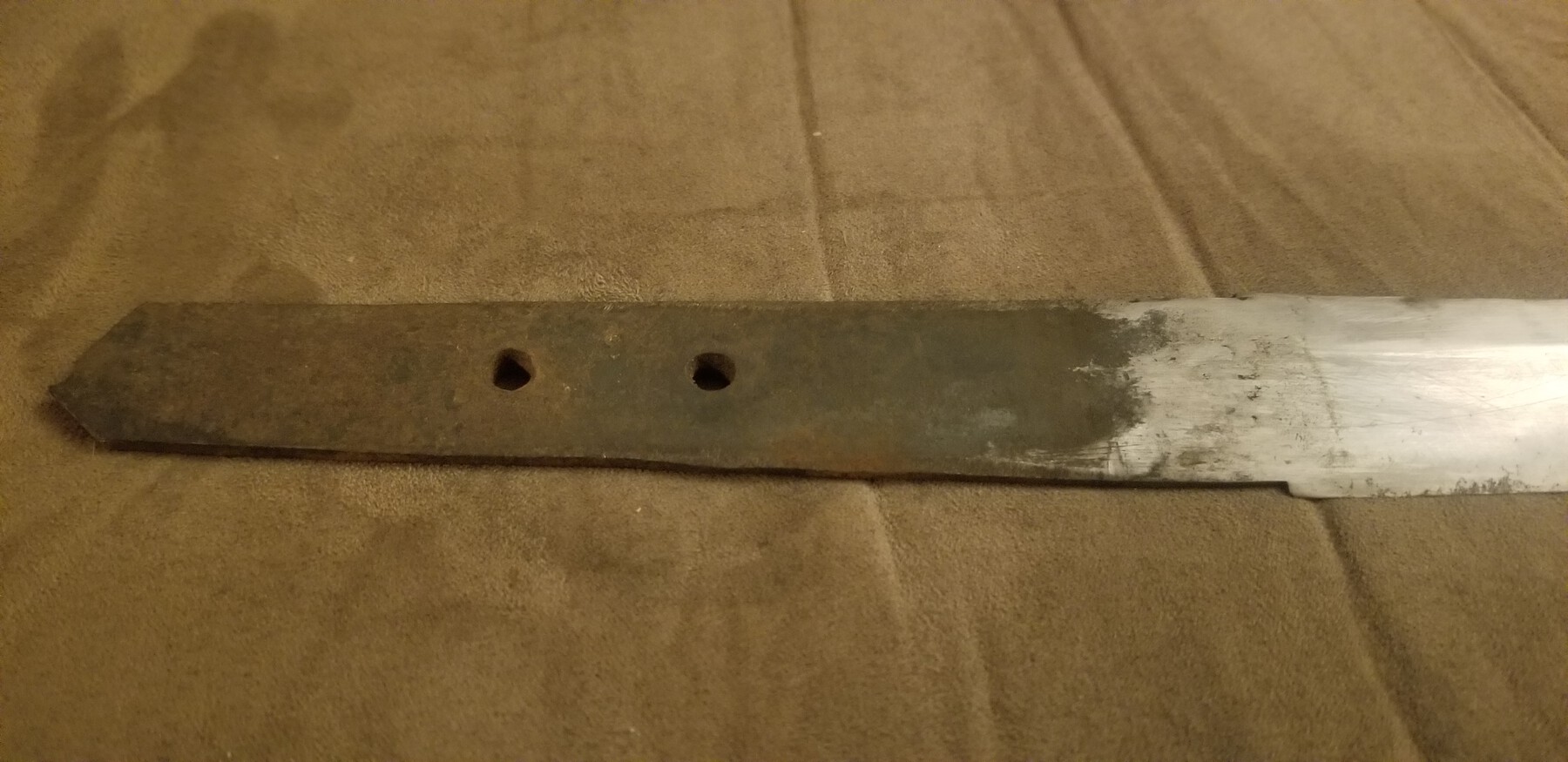

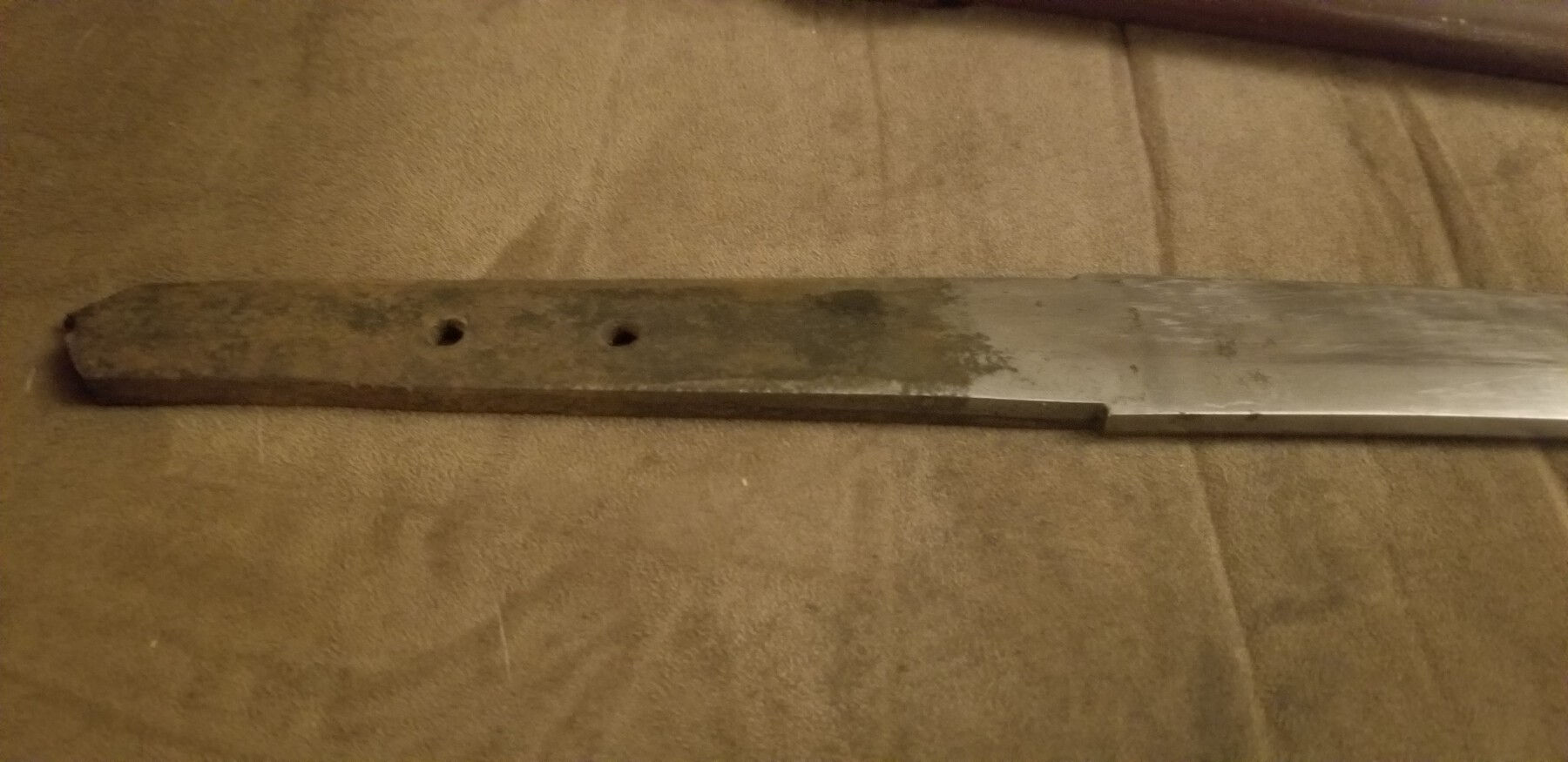

I still believe it’s real but badly damaged. Boshi was massacred, so was nakago. What we’re seeing as a nakago here is actually part of the blade. Poor thing was butchered.

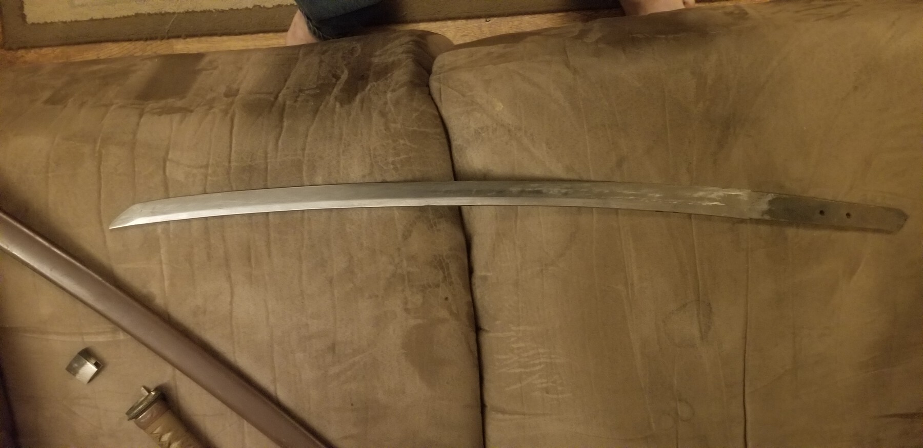

Here are a couple other photos. Is there anything that I can or should do to help preserve our improve this piece? I would be interested in locating a tsuba to complete it for display. Thank you all for the help and information.
IF it's real....and it's still 50/50...I would consider the blade as a tsunagi....something to hold together what are a nice set of mounts. But it is still a nice package, so look after it.

Too me, your sword appears to be severely shortened (o-suriage), as the very end of the nakago-jiri (tang) looks to have a partial mekugi ana (hole for mekugi pin). If this is the case, then the blade was (crudely) shortened by several inches, and has suffered most every other form of abuse as well. Depending on where you are in California, I would advise getting the sword to Jimmy Hayashi in San Francisco to take a look, possibly open a window. Harunaka Hoshino and others in the bay area could also provide an assessment.( Harunaka has a somewhat spurious reputation, but knows Japanese swords well)!  Mr. Hayashi would definitely be my first choice.
Your sword from the photo's shown, does not look particularly promising, however, you never know, and the suggestion mentioned above would be the least expensive and most definite way to find out. The Koshirae , as mentioned is higher grade, present sword could be a lower end replacement for original, but then...many possibilities!

Swords in worse condition have been brought back to life. I would say follow Dave's advice and get Mr. Hayashi to have a gander at it. Who knows? Its most likely not worth the effort, but let the togishi be the judge of that!
This boshi can never be reshaped. This is a dead sword. Not more than a tsunagi for the koshirae. As said before.
