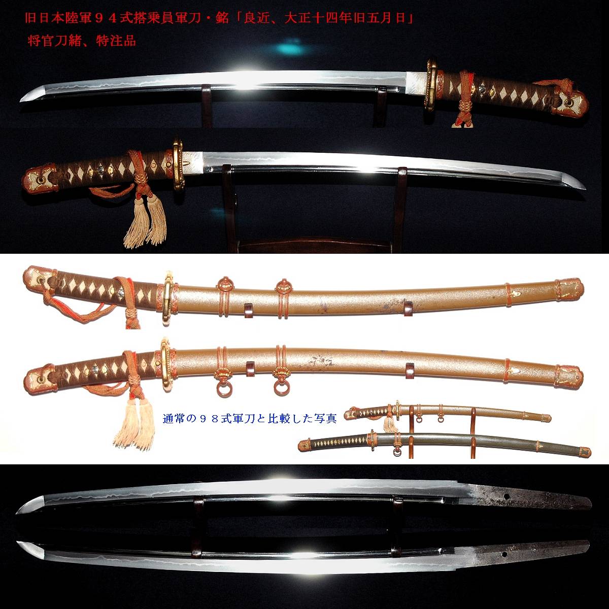

 An interesting sword. Blue/green Ito, which is not all that common and something I like to see. The copper reinforcing bands are different,, but for the leather tab I would actually question if it had ever had a leather cover.

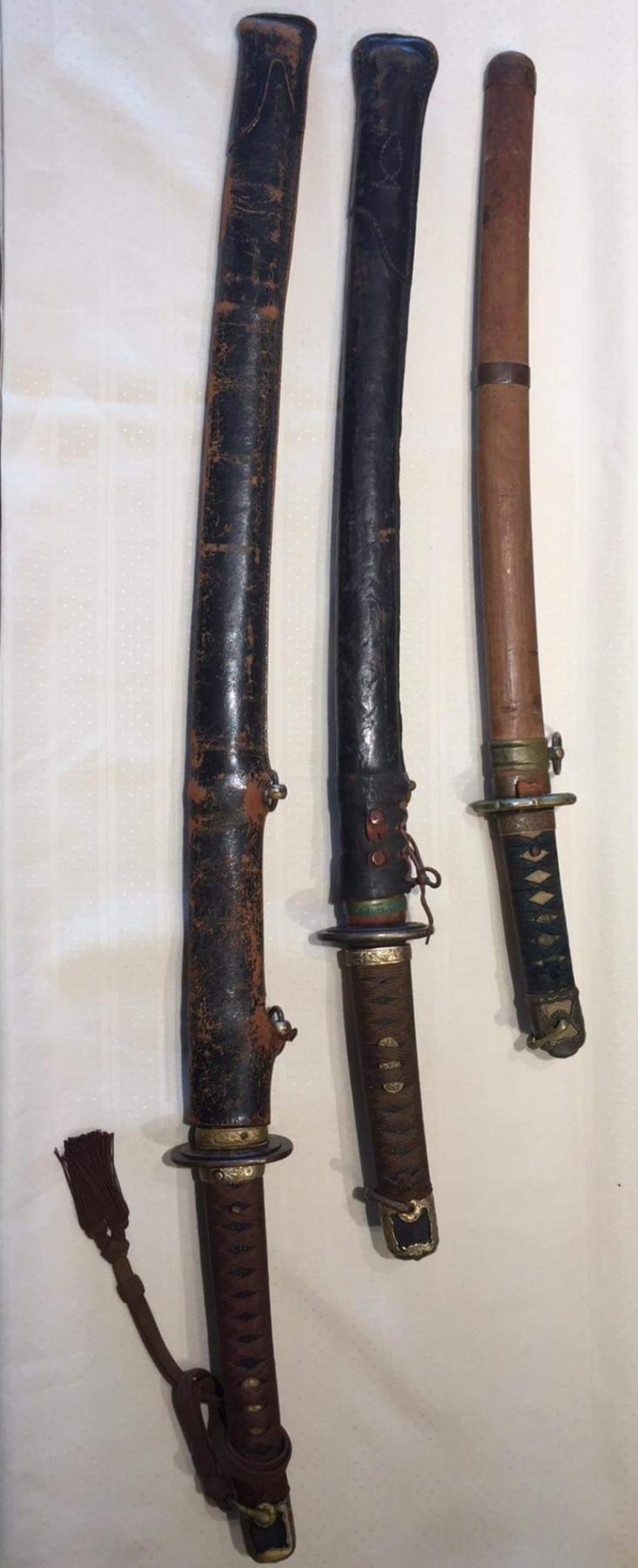

I could be wrong, but I have no memory of ever having seen a Kai Gunto carried by any pilot, or Naval Landing personnel either, in any of my photo's.
I see plenty of Kyu Gunto with the NLF, and the oddest selection of swords which look neither one thing or the other in the famous surrender photo, but I have no memory of radiate tsuba and very rarely double haikan.... This could easily be a result of research bias on my part though.
 Happy to be shown an example though of a Kai Gunto worn by the above.

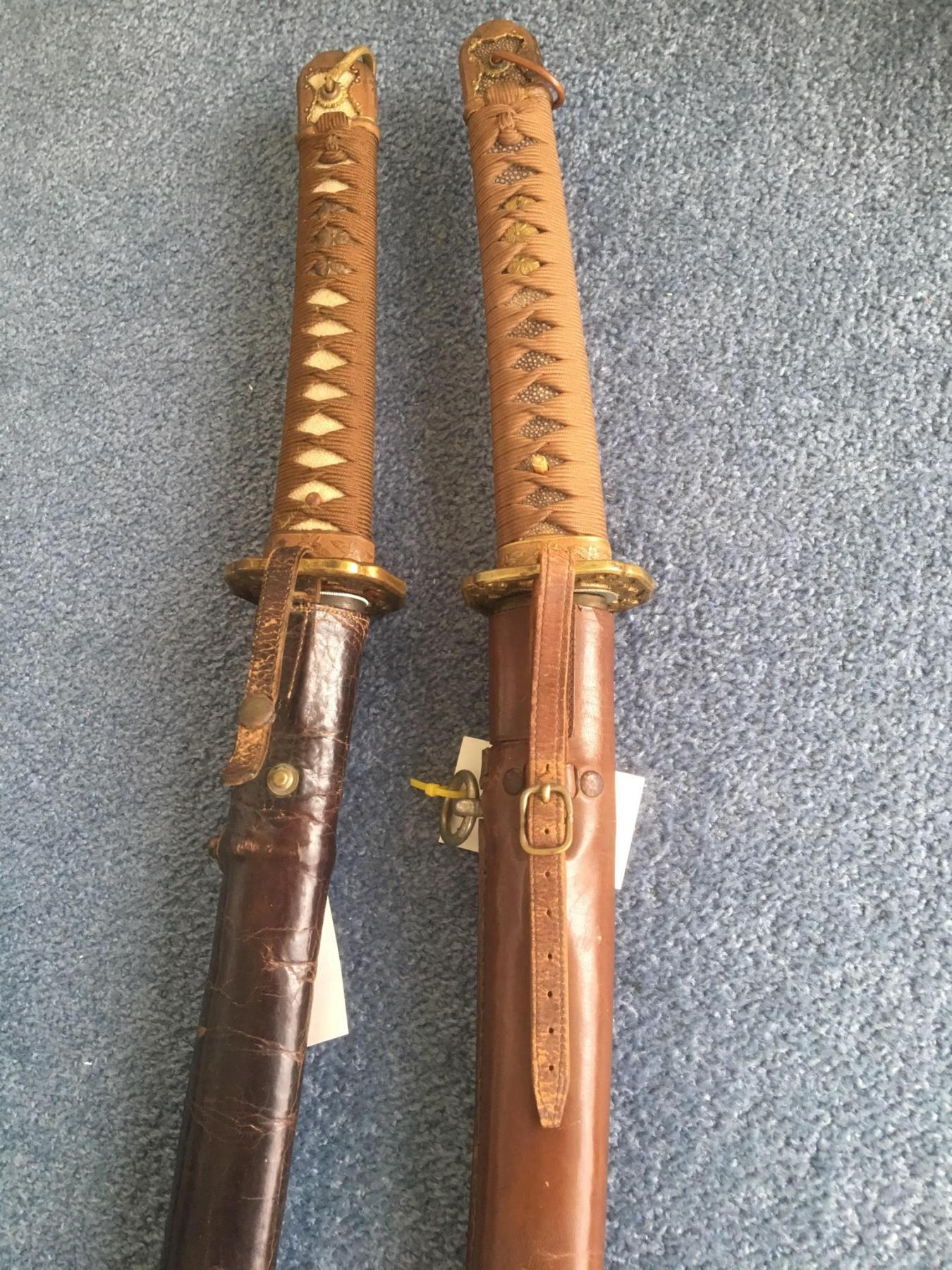

This full size one I find interesting, because it is carried the way the one is in the photo above. Converted bayonet frog or purpose made.These photo's were posted by Geoff Ward some time back but I am not finding the original thread to link to, but here they are anyway.
