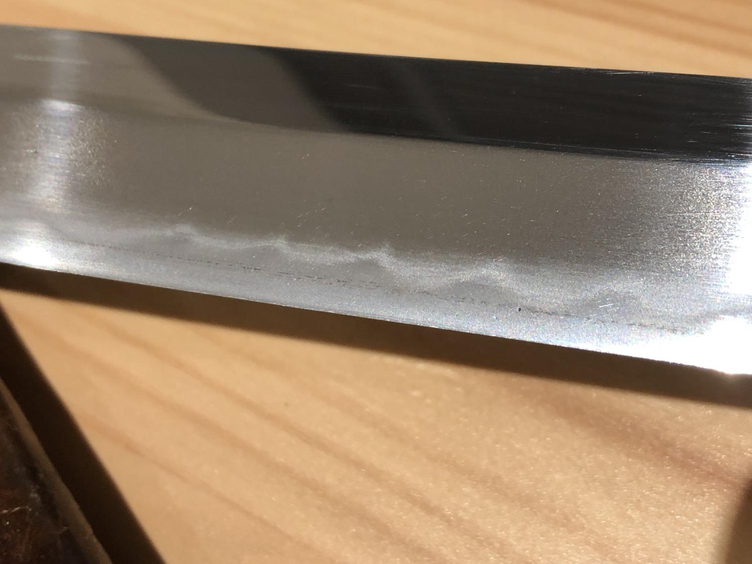

That’s the thing Dean, because I must be blind, but personally, I can’t see Hada here... :dunno:

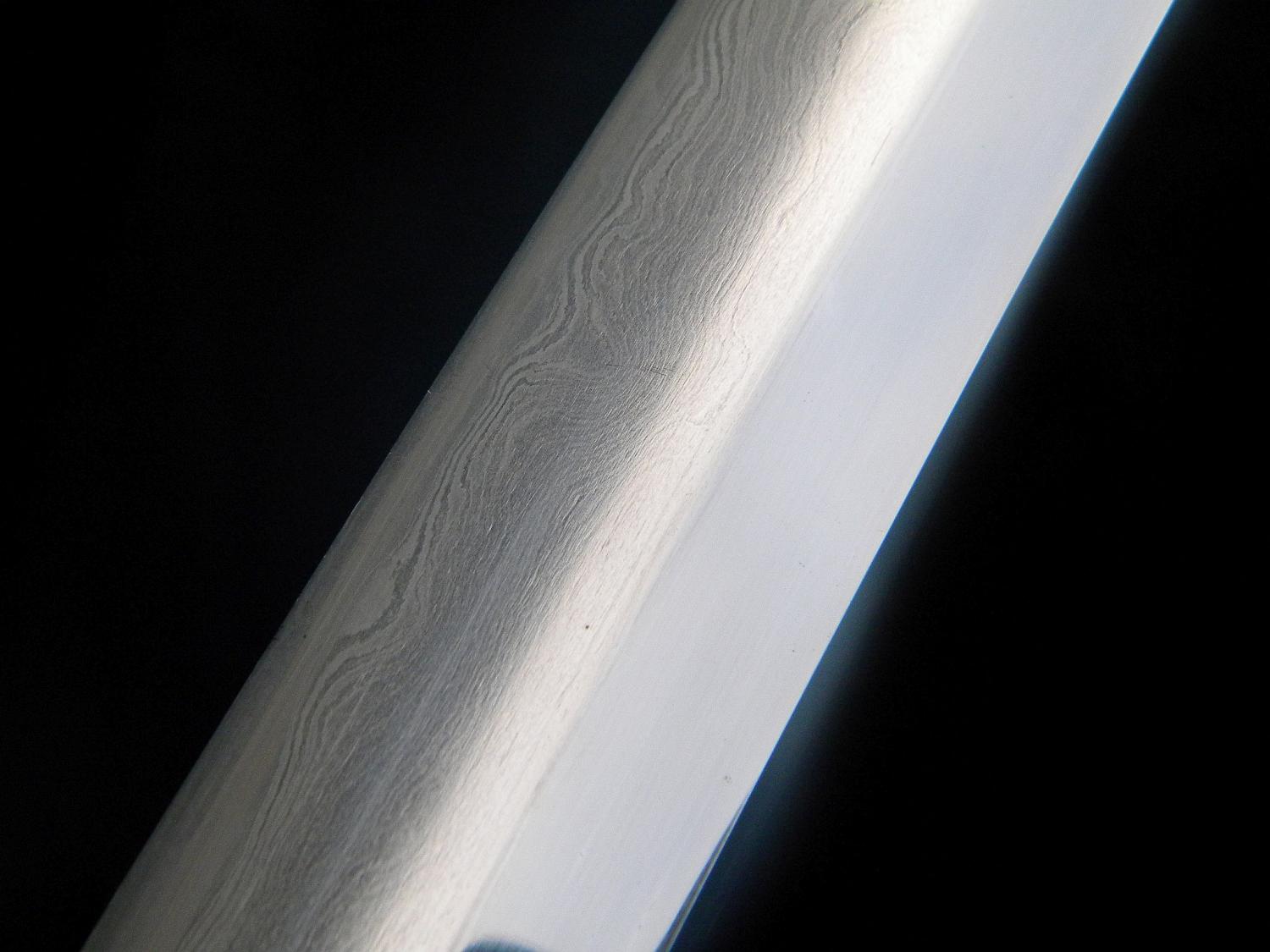

 "Hamfish" has an excellent example of one of these, but I will wait for him to post pic's  and looking at that and others, the most obvious difference is a very clear and coarse grain, possible even to mistake for a modern Chinese damascus.... as has happened on this site.
 I think a fair few of Amahida' swords fall under this description as well. This pic' is from an online sellers page.

Hmm, well Dean there was one photo that appeared to show activity but maybe it's just a anomaly in the steel around the Hamon or could even be swedish railway steel showing that grain I mentioned?
I still see nioi, extremely tiny ko nie, but to me this is muji Hada...
I'm with 16K, I took a closer look at Dean's sword and still unable to see discernible Hada. Very nice looking though!
That is actually the only picture that made me wonder if there was or not Hada. But upon closer inspection I think this is just traces left by the polishing.
Now, just to be clear, my remarks aren’t meant as a way to downplay the beauty and quality of that sword. It is a beautiful, well made blade, probably top of the heap WW2 blade. I’m just stating what I don’t see for the sake of clarifying whether this falls in the category of Hantanren or not.

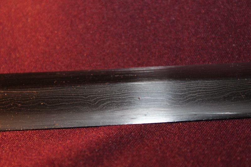

 Got a PM from Hamfish, and he is OK with me posting his pics from my files.... This is possibly the most classic example of a Han-Tanren you are going to see. Made as an Aito with Showa era Buke Zukuri mounts, and then militarised for the war.

Oh, man, interesting and worthy to be kept in a collection but even worse than the worst Chinese fake. This must have been a very low point in sword making.
Why? Are you talking about the last post? Nothing wrong with it, it is just a different forging method. There is nothing low quality there. In fact probably takes some skill to forge that.
Oh, you're right, Brian, it's just not very aesthetic i think and i've seen better looking Hada on Chinese blades. We usually say some bad stuff about Chinese blades when some are more pleasing to the eye than this one. Still, as I said, it's part of Japanese sword history and as such deserves a rightful place in a collection. Just my tastes speaking.

As Brian said.....every weld has the potential to not be a good one, so it takes a lot of skill to produce such a sword. The "half- forged" reference makes sense to me, in that Hamfish's sword would be the result of forge welding a billet less times than another sword which has less hada...forged further, the sword could be said to be muji hada, but which is actually folded so many times the layers seem to disappear.
 The rail track swords are quite well known, and researched, but a bit of a digression here. My take on some of these Showa blades is that they were modern steel folded to give an obvious grain, possibly even several different steels for contrast. I would put Amahida's mixed metal specials in the same category.
 The were not art swords, but pre war were made as aito for martial artists for use as "cutters, and in wartime as something a bit "better" than plain steel.
 I would say that quality of polish was another factor, early Showa there were problems with such, and one of these blades would look quite handsome in the hand even with a less than perfect polish... and if you are cutting you don't need or want a perfect polish
