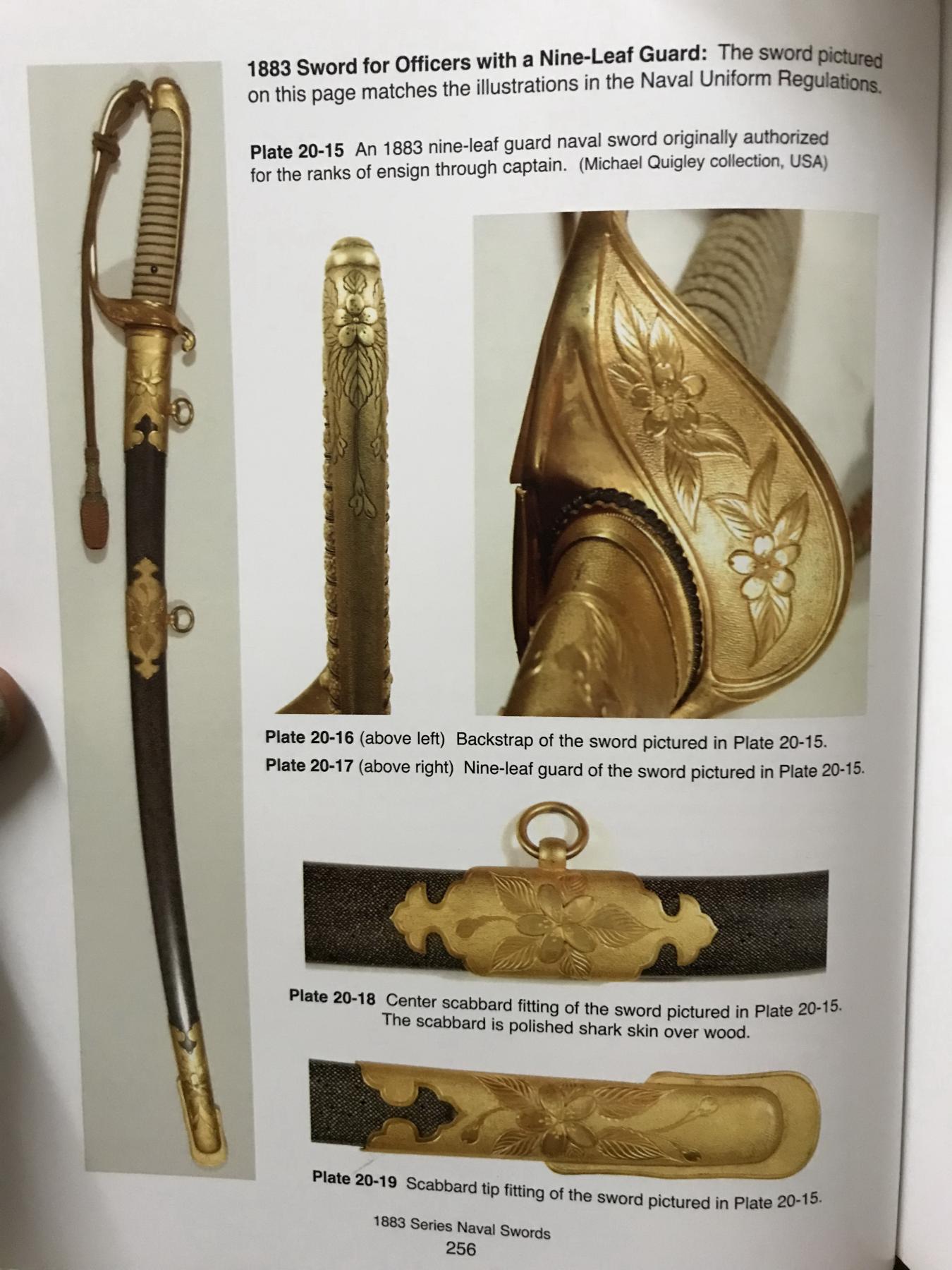

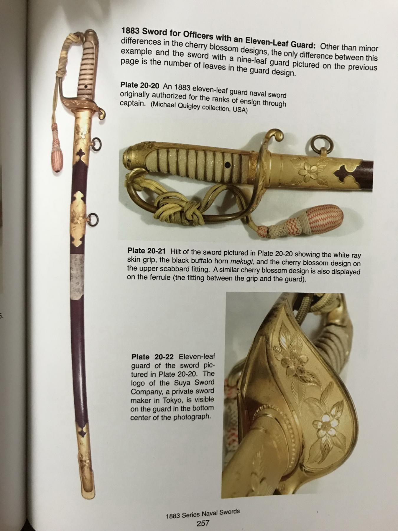

Agree with Mark on this,
confirmed by looking into Dawsons... here's the references Bruce.
1883 Naval Officers sword for ensigns to captains.
From the OP's pics, it appears to be a 9 leaf variant, not 11.
Not sure what the difference is though.
The blossom is not the Plum Blossom from Manchurian usage but a Japanese Cherry Blossom.
The Plum has round petals, while the Cherry has notches at the end of the petals.
Thanks Stegel! Jason's looks exactly like that one in Dawson! It even has the same sharkskin on the saya. I expect we'll see the same backstrap when Jason posts the pics.
