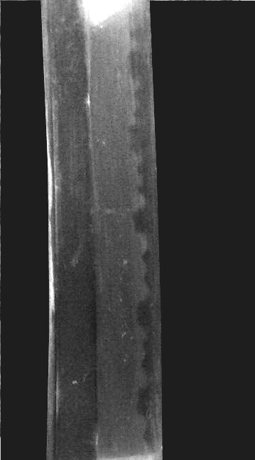

This is very interesting. Is this kind of dedication in a nakago common? Is this a one of a kind Item traditionally forged  or the first of a batch ordered by Mr. Funaoka?  I would love to have any input you guys might have on this sword. Here I attach some pictures for your analysis and comments…

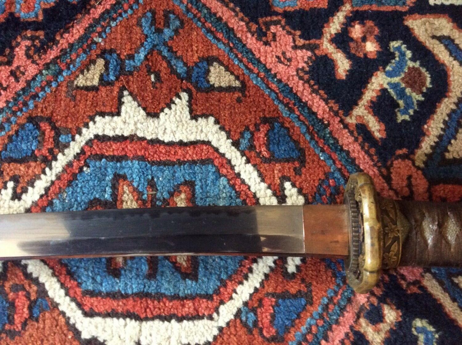

Hard to see and be certain from the pictures, but I concur with Stephen. The Hamon looks like your typical Seki Showato. But better people than me will certainly chime in!
I agree with John, looks to be “handmade”, but there was something done that makes it non-traditional, like maybe a different steel was used or it was oil quenched. The Showa stamp is 99% indication that it was not made in the fully traditional way. Still a very nice blade in upgraded fittings.
About dedications- they are not the norm, but there are plenty to be found on the market.
All in all a very nice gunto!

All the type 98 showa-to are handmade. I think your sword is traditional forged maybe not with tamahagene. Maybe it is oil hardned. The showa stamp is not a sign of bad quality overall. Its a sign that the sword was not made full traditional.
The hamon looks mino to me, not like the seki saw.
A good and honest piece.

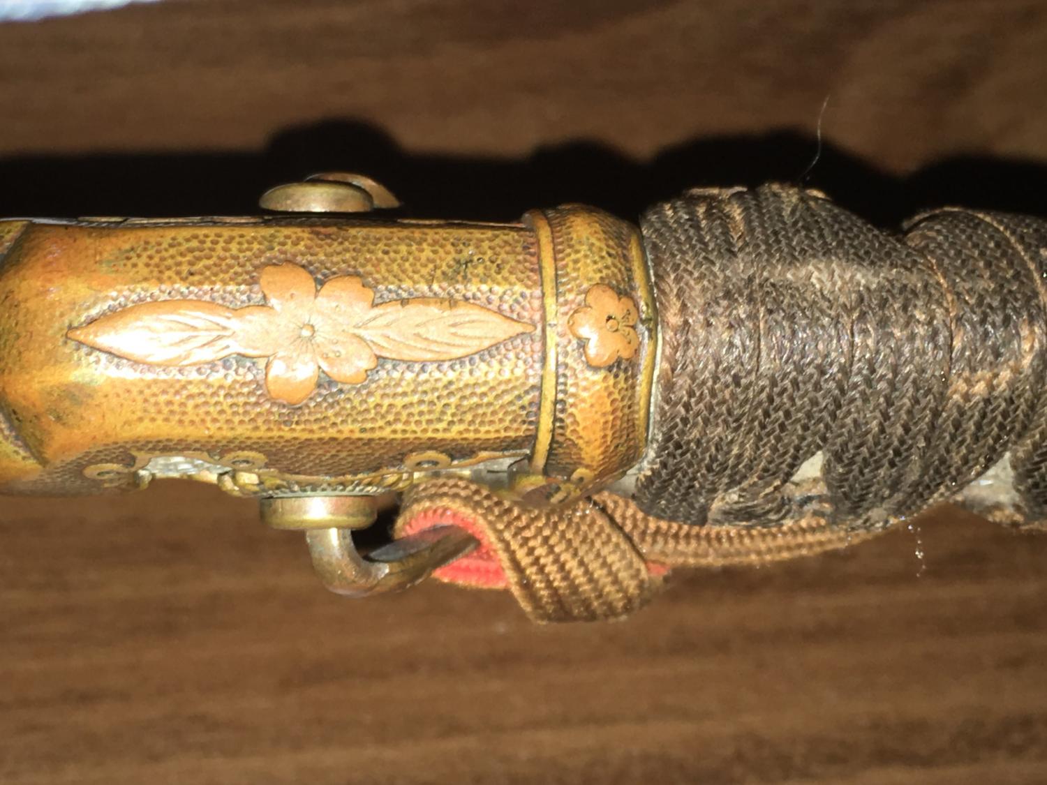

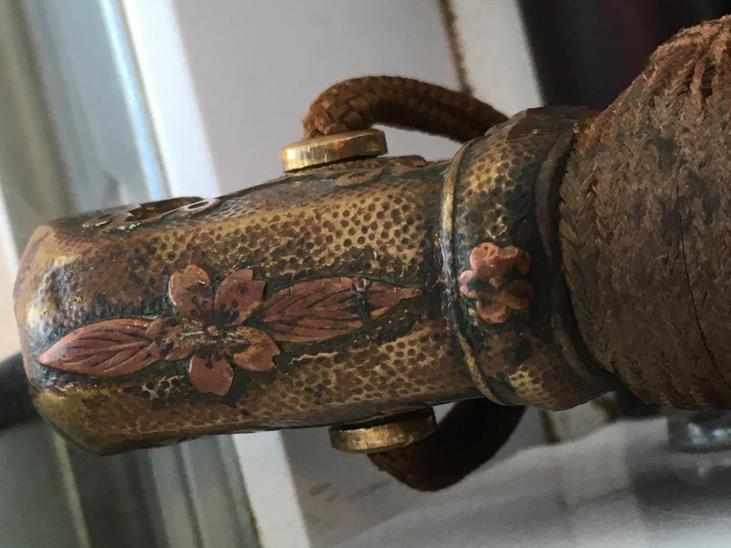

Luis,
I have never seen either of those before. My suspicion is that the brass mekugi is post-war made, though, it does seem to have some age to it. There is really no way to know, only speculation. The cherry blossom isn't a family mon. I was going to say I'd never seen that done before, too, but on the "Mons" thread here: http://www.militaria.co.za/nmb/topic/29606-help-identity-our-mons/page-3, is one just like yours WITH a mon.
Anyone else able to enlighten us on this practice? Neil?
It's the standard blossom cast into virtually all Gunto kabutogane, the definition seems to differ between makers and whether early or later production. Type 94 or early Type 98 should have very crisp and defined blossoms, also use flattens and wears them down. Was interesting looking at my swords to see how all the blossoms are slightly different, something you never really pay much attention to. Pictured are three early swords, you can see on the third one how it's been worn down from heavy use.
