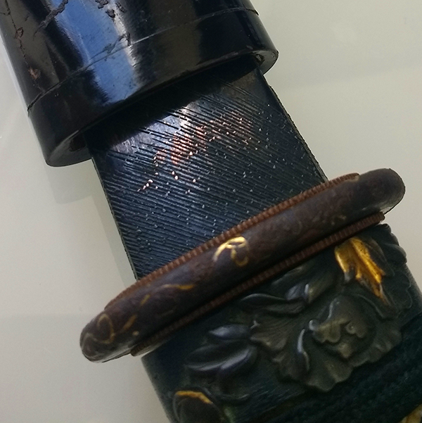

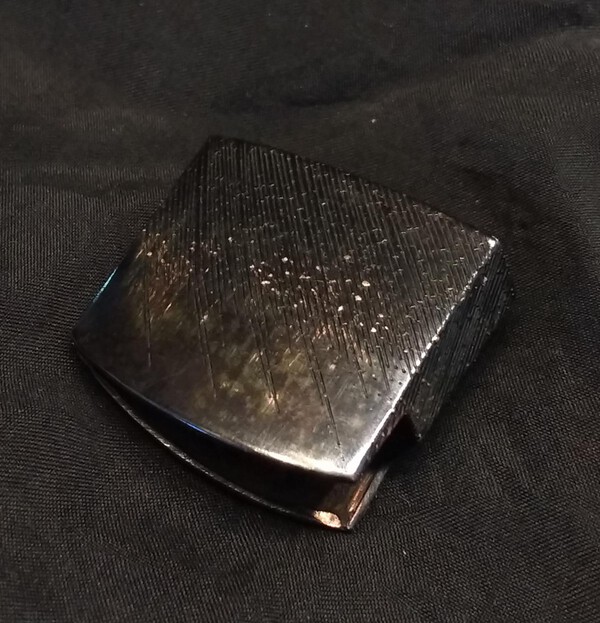

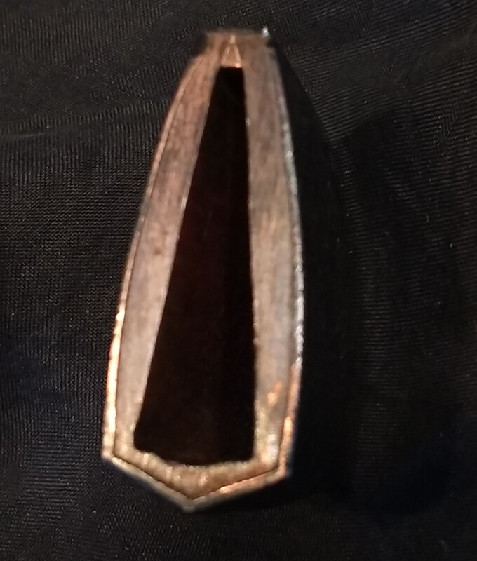

Just a short question? Is this a copper Habaki which is coated with shakudo or is it something else?
Thanks in advance for your reply.
Best regards, Ed
I am not an expert Ed but it look, as you said, a copper habaki coated with a thin foil of shakudo.
I remember a set of photos by Ford Hallam showing the replacement of such a foil on an habaki.
Unfortunately I am not able to find the link again. Sorry.
Regards
Luca
The one negative I have heard regarding shakudo habaki is that polished shakudo may tend to show fingerprints. There is a craftsmen who specializes in two piece habaki with polished shakudo on the inside. They look great when clean however, like those expensive black iPhones, tend to show prints easily.

Just a thought, the shakudo foil is patinated to achieve that lovely black colour.   As the sword is drawn and re sheathed the patina is subject to wear which might account for the fact that you usually see it as the inner part of a niju habaki.
I have one sword with a habaki like the one that started this post and I have to agree it looks smart against the gilt seppa!
All the best.
It is difficult to see from mobile phone photos, but the copper color does show through in those areas where the patina of the shakudo has worn.
Ray FMPOV its silver patinated black, but its in your hand so i trust you.
Ray -
I had a tanto some while ago with a shakuko foil over brass habaki. Might want to see if that  is the case with yours. Looks nice. Pics of the whole sword?
