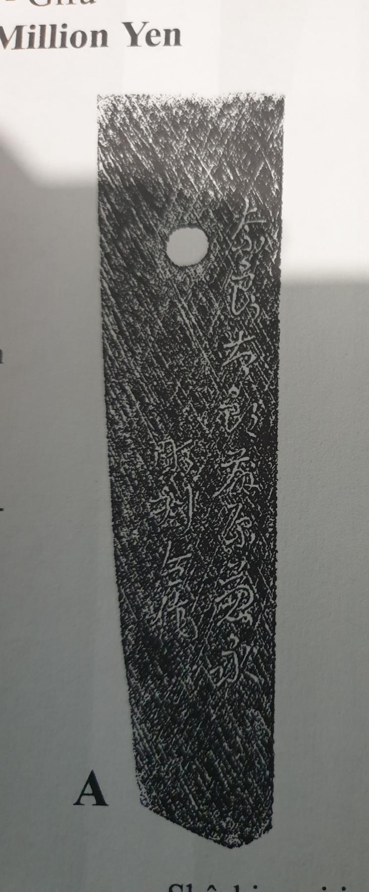

Posted 27 February 2020 - 10:17 AM
I was going from memory when I suggested the book.
Got home what do you know, page 51
Hamfish

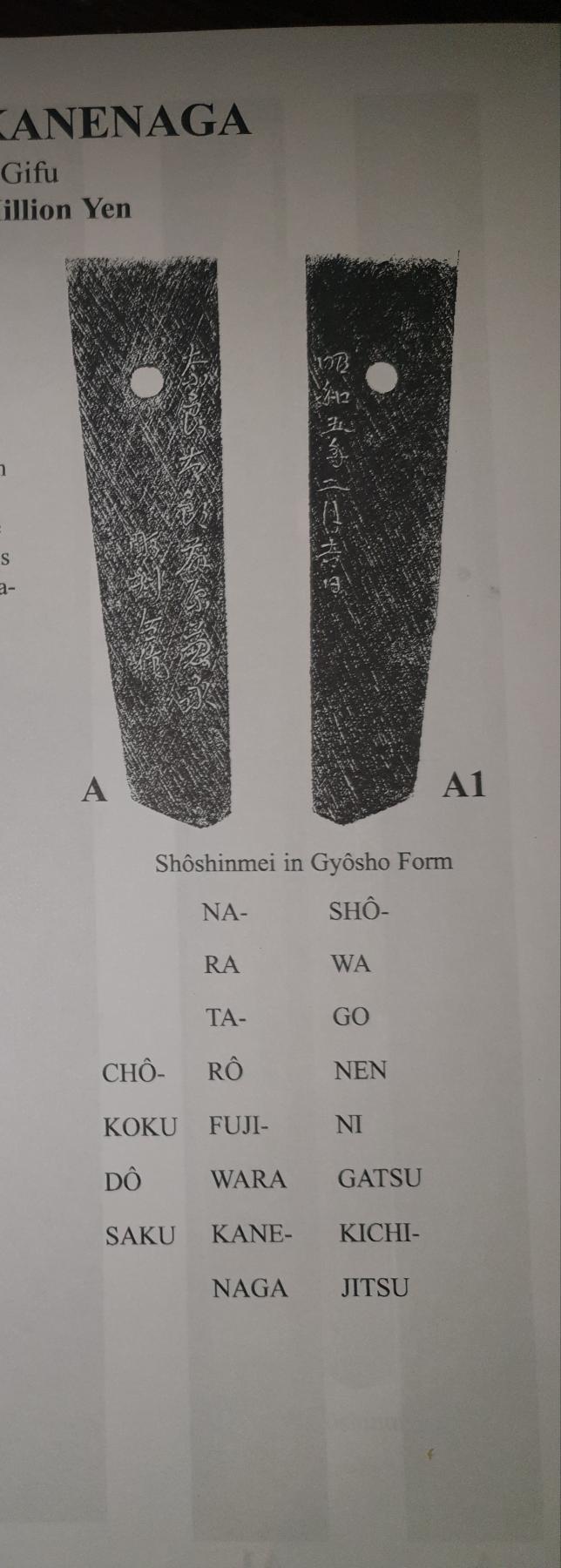

Posted 27 February 2020 - 10:23 AM
Pt 2
