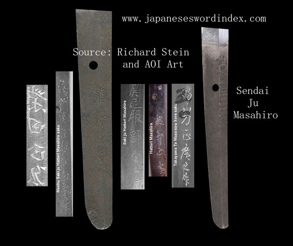

There were 3 Masahiro in the wartime. One from Tokyo, one from Gifu and one from Fukushima.
And one from Kagawa  :)
So you should check all the 4 ones.
We need the gendaito project book from Markus.
  • Jason N likes this
Based on information from the seller, my Hattori Masahiro was from Gifu.

#22 vajo
vajo
    Tokubetsu Juyo
  • Members
  • 4,344 posts
  • LocationGermany / Bavaria
Posted 27 April 2019 - 09:24 AM
Hi Jason
can you compare that signature to yours?
https://www.aoijapan...-masahiro-saku/
That is the one from Gifu/ Seki
#23 Jason N
Jason N
    Chu Jo Saku
  • Members
  • 97 posts
  • LocationTexas
Posted 27 April 2019 - 10:14 AM
Hi Jason
The two kanji for “Ha tori” look similar, but somehow off. The nakago, file marks, placement of the mei, and strokes also all look different to me, but I’m certainly no expert.
-Jason

#25 vajo
vajo
    Tokubetsu Juyo
  • Members
  • 4,344 posts
Posted 27 April 2019 - 11:34 AM
The easiest way is to find out who the smith was. If he was a showa-to smith so he has not become tamahagene. The signature is very thin scribbled so mostley you find that on lower or medium grade showa-to. The blade itself looks very good.
Yours is definetly not that masahiro from Seki/ Gifu.
From my reasearch, there were 3 different Hattori Masahiros that worked as swordsmiths. I believe the Massahiru that was from Gifu and produced swords in Seki is my Masahiro. There are two different Masahiro Mei shown in the linked pic in my OP. The example shown on the left is the same Mei on that Aoi art blade. His mei is the closest match, and I believe he signed (or someone signed) his showato/gunto made to support the war differently than his Gendaito. I’m no expert on mei or kanji though.
-Jason

Posted 27 April 2019 - 05:38 PM
To compare.

Thanks for posting the Nakago pics. I have studied those in detail. None are a precise match. The closest is the pllain Hattori mei with seki stamp. The Hattori mei “working in Seki” is the next closest. All the others are definitely not the same smith and can be ruled out 100%. That said, I doubt the same hand signed any of those Hattori nakago.
Of the dozen or so nakago I looked at bearing “Hattori Masahiro”, the writing is just slightly off from on mine, and I haven’t seen a single other Hattori Masahiro mei on a Gendaito. I’m sure the Showato/Gunto he produced far otnumbered any amount of Gendaito he (may have) made, though.
-Jason

Just to clarfiy on my previous reply...
I believe the Hattori in Seki and the plain Hattori are from the same smith as on my sword, but from different times, and I believe the mei were often signed by workers, not the actual smith. The mei on my sword is the sloppiest example I’ve seen (not very re-assuring) and all the mei I’ve seen I would attribute to “my” Masahiro are better executed than mine. Those swords are also very different than mine.
I’ll be back home tonight, so I’ll try to get some better pics besides the stuff I had archived on my phone.
-Jason
