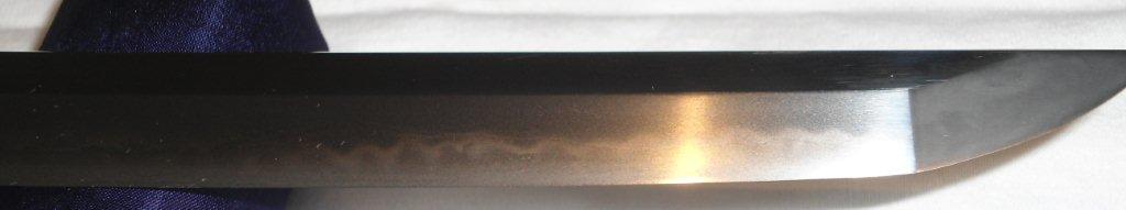

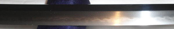

The pic I posted that "runagmc" asked about comes from the British Museum Catalogue "Cutting Edge". It is # 79...a tanto by Tenryushi Masataka (shinshinto). I understand that this collection of the British Museum were all polished under the supervision of the Monbusho and the NBTHK by 33 togishi, incl. Fujishiro, Hagi, Honami, Kishida and many others. Almost all the swords are polished in hadori, but some are sashikomi (if this is what we can still call it?). I wonder if acid was used in such a case as this #79 tanto?
I wonder if Kishida sensei can discuss these sashikomi/hadori swords from the Museum collection that he worked on?

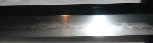

I'm guessing that you would be suggesting my blade is of reasonable polish with perhaps some use of acid applied to the polishing technique ? Although different blades/steels differ in polish outcome , are you suggesting similarities between your lower picture & my lower picture # 5581 ?

In the case of the British Museum polish (my pics) it means that this sashikomi is a best job...done without acid.
As the polisher decided himself which polish to do on the sword...it must mean that some yumei togishi still think sashikomi is more appropriate than hadori for some swords...also, this means that quality of sashikomi must be equal quality to the hadori polish here.
