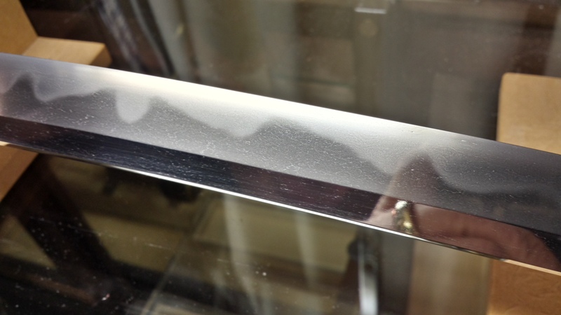

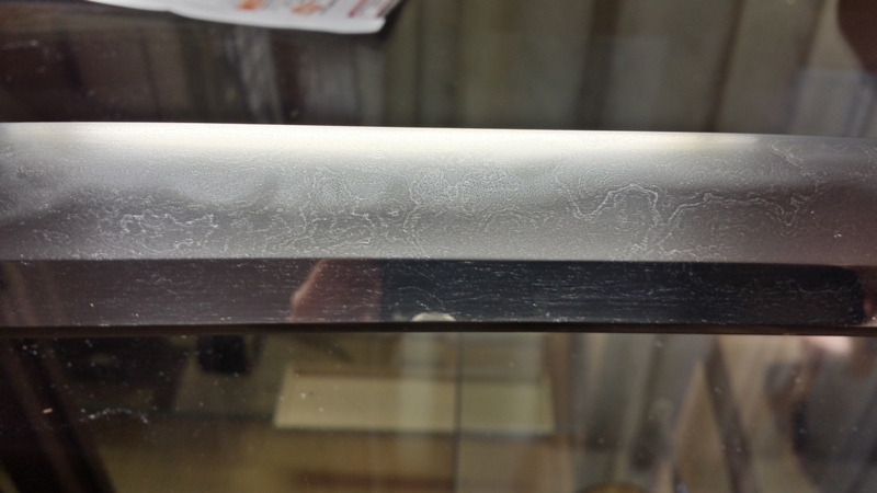

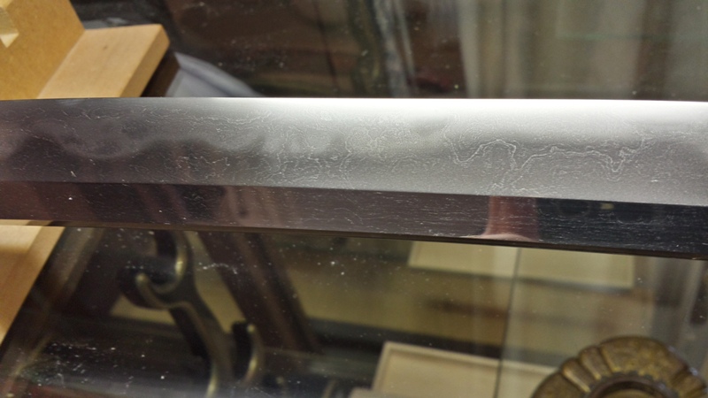

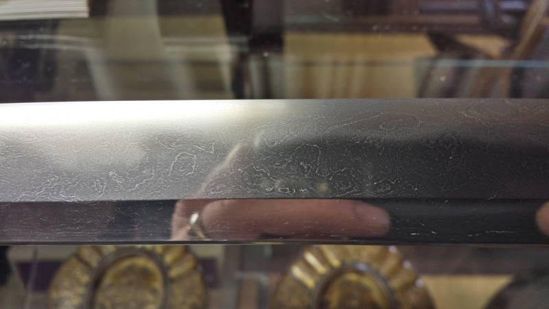

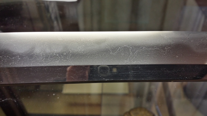

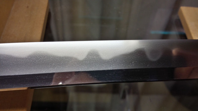

Chris Bowen... Here is an Osaka Shinshinto blade by Masataka in sashikomi polish. (same camera and loc) BTW, if you read my original post I acknowledge that hadori is regarded as superior in bringing out the jihada. Sashikomi is our preference.
George Trotter.. . You write like a true scholar, a good discussion. BTW the 1st pics (in original thread) are the Horikawa Kuniyasu, Juyo Token, and a published sword in Japan. The 2nd is an Osaka Shinto katana by Tadashige. (tokubetsu hozon).
