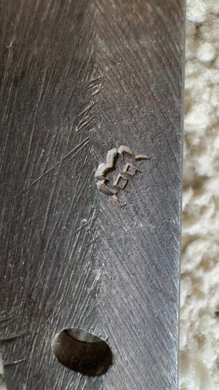

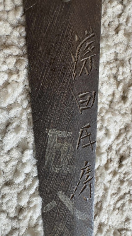

I_Kendo_It Posted September 16, 2025 Report Posted September 16, 2025 I recently acquired a Type 98 Shinguntō and have been researching its history, classification, and potential value as a collector’s piece. I’d like to share my findings here, and would greatly appreciate any feedback, feel free to prove these findings wrong with your expertise and experience . I'm fortunate enough to be in touch with a few Nihontō specialists in Japan whom I met while living there. While I am limited to sharing photographs rather than the blade itself, they were kind enough to tell me a lot of things. Below is the information I’ve gathered from one, (translated from Japanese using AI, so it may sound a bit weird or off): 『On the tang (nakago) of this blade, one can observe the stamp ‘Shō’. This stamp indicates acceptance by the army during the Shōwa period and is most often found on non-traditional Shōwatō (oil-quenched, made from industrial steel). However, the presence of a stamp does not automatically make a sword a Shōwatō, since the only true criterion is the method of manufacture. Some swords bearing a stamp have passed shinsa and classified as gendaitō. On this blade, kitae-ware appear, signs of folded forging ; and the nioiguchi of the hamon stands out and shows similarity to other niedeki sanbonsugi hamon produced by Ujifusa. These characteristics are typical of blades produced using traditional methods, by water-quenching and folded forging. It is shows similarities to gendaitō No. Tokyo 189513 by the same smith (Ujifusa). It is therefore possible that this sword is a gendaitō, although further examination is required for a definitive answer. Photography may not capture all details, and aged or rough polishing may hide nie, nioi and hada. The tang bears two signatures: ‘Shinoda Ujifusa’ and ‘Kanetomo.’ Ordinarily, a sword carries only a single signature, but when two names are inscribed on the same blade, this generally indicates proof of joint work or a master-disciple collaboration. Here, the signatures on this blade do not appear to have been carved by the smiths themselves, but are meishiriki-mei, that is, inscriptions traced by a professional engraver commissioned for this purpose. At Seki, during the war, such a practice was not rare due to the demands of rapid production; nevertheless, the presence of two mei on a Shinguntō remains very unusual. Shinoda Ujifusa was a prominent smith of Seki during the Shōwa period, an award-winning craftsman of great skill within the Mino tradition. Kanetomo was also active in the same region at that time. The presence of both signatures on this blade suggests a collaborative work, with Ujifusa as the master smith, and Kanetomo in the role of assistant or disciple.』 Here is the referenced gendaito : Katana - Ujifusa - Uchigatana Koshirae - Ubu Nakago - Gendai Era - Tok | Tozando Katana Shop I'll also include some pictures ! He advised me to take pictures with a 45 degrees angle as they reveal the nioi better than straight-on pictures on swords with aged polishing. Here you go ! 1/ Overall pictures 2/ Nakago details 3/ Sho-stamp 4/ Hamon details (those pictures are quite hard to take, it's clearer in person... detail gets lost in pictures) 1 Quote

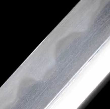

Mark Posted September 16, 2025 Report Posted September 16, 2025 from pictures it looks oil tempered. has decent military mounts and that is popular now. I would think it would be most valued by a military sword collector. In my area it would probably sell in the $650-900 range....... just my opinion based on what i see Quote
Rawa Posted September 16, 2025 Report Posted September 16, 2025 I see koshirae alone sells on ebay in 400-500$ range. But yeah paying ~1500$ for it or more is too much. Can anyne provide Fuller and Gregory 'Swordsmiths of Japan 1926-1945' oshigata 366? It is about this RJT I think. Dunno about this being oil tempered there are't any darker spots indicating oil. 1 Quote
I_Kendo_It Posted September 16, 2025 Author Report Posted September 16, 2025 1 hour ago, Rawa said: I see koshirae alone sells on ebay in 400-500$ range. But yeah paying ~1500$ for it or more is too much. Can anyne provide Fuller and Gregory 'Swordsmiths of Japan 1926-1945' oshigata 366? It is about this RJT I think. Dunno about this being oil tempered there are't any darker spots indicating oil. I can confirm that it has no such dark spots, and the person I contacted compared this hamon from the linked Gendaito by Ujifusa (area with two "hill-like shapes" with a thin nioi side by side) : To this same pattern with two small mounts visible here In my case I'm in the European market. I'm not looking to sell, I'm just curious and love to learn about these things. Quote

I_Kendo_It Posted September 16, 2025 Author Report Posted September 16, 2025 1 hour ago, Kiipu said: The subject of traditionally made and guild stamps can get confusing at times. Sunagashi Yes, looking more into the difference I've come across this, saying that some gendaito also look like they are oil-quenched, and that even some were first water, and later oil-quenched at Yasukuni... It's a rabbit hole I didn't expect. The gendaito linked in the initial message by Ujifusa also doesn't have a lot of hataraki, nioi or nie, and indeed it's quite similar, so it could be the smith's style... I guess the only way to be truly sure is by scientific testing, or time-travel. Anyway I'm getting confused. Maybe the NTHK shinpan who give papers are hiding secrets ? Quote

John C Posted September 17, 2025 Report Posted September 17, 2025 8 hours ago, I_Kendo_It said: the presence of two mei on a Shinguntō remains very unusual E.N. Additionally, you will see a polisher's name on a blade sometimes. Just for added info. John C. 1 Quote
Brian Posted September 17, 2025 Report Posted September 17, 2025 With that Sho stamp, you can be almost assured it is not 100% Gendaito. I would bet on oil quenching. That said, it does have hada and I suspect this is a high level Showato that was forged and folded, but something in the process was not 100% traditional and it therefore is probably not considered a Gendaito, but something in between. Looks like a decent sword, and would probably still paper on a good day. One of those "in between" swords we come across that is high end 'arsenal' made by a smith. Quote
I_Kendo_It Posted September 17, 2025 Author Report Posted September 17, 2025 15 hours ago, Scogg said: Just a quick reminder, as part of our forum guidelines, we ask that all members sign their posts with at least a first name. (...) Okay thanks ! I wasn't sure if just initials would be fine. It's updated now. I have two first names. One is very identifiable, so I used the second one. 13 hours ago, John C said: Additionally, you will see a polisher's name on a blade sometimes. Just for added info. (...) Good to know ! In that case Kanetomo could be the polisher. Thank you. 8 hours ago, Brian said: With that Sho stamp, you can be almost assured it is not 100% Gendaito. I would bet on oil quenching. That said, it does have hada and I suspect this is a high level Showato that was forged and folded (...) Thanks for the info ! After your message I decided to do some research. If you don't mind let me share my findings. Notably the Ohmura website says this : Quote "国・県当局に運動して、鋼材から生産する新作日本刀は全部、「関刃物工業組合」の検査を受けさせ、合格品には刀剣の中心(茎)に 「関」の検査刻印を打った。" (After lobbying the national and prefectural authorities, all newly made Japanese swords produced from steel were required to undergo inspection by the Seki Cutlery Manufacturers’ Association, and those that passed had the ‘SEKI’ inspection stamp struck on the tang (nakago) of the blade.) Quote 昭和14年頃※から名古屋陸軍造兵廠関分工場が検査印「関」を使用するようになった。※ 推定 その為、内務省令に依る「桜の中に昭」の字を配した検査刻印に変更した。 こうした検査刻印を打たせることで品質を保証させる事に成功し、全刀剣需要の大半を独占するに至った。 (Around 1939 (Shōwa 14), the Nagoya Army Arsenal Seki Branch Factory began using the inspection mark ‘SEKI’. Consequently, the inspection mark was changed to one showing the character ‘Shō’ (昭) inside a cherry blossom, in accordance with Ministry of Home Affairs regulations. By requiring these inspection marks to be applied, they succeeded in ensuring quality, and eventually came to monopolize the majority of sword demand.) This indicates that the stamps were inspection marks, rather than distinctions of production processes. And that the "sho" stamp proves army inspection, the "seki" stamp proves seki cutlery manufacturer's association inspection. That means that swords carrying these stamps can be made by any production process. However, there's one more nuance to be made. In the first quote, the word "steel" is used (鋼材) as opposed to tamahagane (玉鋼). As such, it is likely these stamps show tamahagane was not used, though I can't confirm this definitely unless we have primary sources of regulations or legislation. As for the classification as "Gendaito" or not : 1/ NTHK : The NTHK appear to base their classification on the technique and authenticity of the signature rather than the material. Hence the NTHK giving papers to stamped Nihonto that are likely not Tamahagane. NTHK papers aren't extremely strick and can attest authenticity (Shinteisho). I had seen examples of "seki" stamped gendaito papered by the NTHK. 2/NBTHK : NBTHK is a stricter body and only papers "preservation" swords and "special swords" and above (保存刀剣, 特別保存刀剣). Even so, their rules do not at any point mention tamahagane but rather quality of worksmanship, condition, and historicity, and are significantly stricter on newer swords. (31-3 審査規程第17条第1項に定める審査基準 27.5.19~.pdf) It even says that "work by living artists are not eligible fur judging" (生存する作家の作品は審査対象外とする。) so I guess tough luck for modern gendaito smiths, they need to literally die to have their swords even be considered. In fact, the NBTHK even accepts non-tamahagane steel in their sword-making competitions 2025, saying that Tamahagane is preferable but not required. (作刀の部については、日刀保たたらの玉鋼を使用することが望ましい。) 現代刀職展(作刀の部) | 日本美術刀剣保存協会 All that seem to show that mill-steel gendaito exist, they can probably get NTHK papers attesting to their authenticity, but not NBTHK papers attesting to their special historical value. These finding seem to meet what the expert I had initially contacted said, that the real standard to determine what is gendaito is production process. In conclusion that this sword could be classified as mill-steel gendaito, if it indeed turns out it's made with mill-steel, forged in the kitae method, and water-quenched. However personally I don't know if it's folded and water-quenched. Of course I'd be happy if it turns out to be of the standard that could get NTHK papers. Quote
PNSSHOGUN Posted September 17, 2025 Report Posted September 17, 2025 The Sho stamp indicates some part of the manufacture was not traditional, I would hesitate at calling this Gendaito and would think more along the lines of higher quality Showato. 3 Quote
I_Kendo_It Posted September 17, 2025 Author Report Posted September 17, 2025 1 hour ago, PNSSHOGUN said: The Sho stamp indicates some part of the manufacture was not traditional, I would hesitate at calling this Gendaito and would think more along the lines of higher quality Showato. Thanks ! It may be wishful thinking, but here are multiple seki-stamped swords that have passed shinsa and been papered. In practice it seems that those swords are not automatically excluded from being considered "nihonto". 🤔 And given Ohmura indicates that the Sho-stamp and Seki-stamp are basically the same thing : examination stamps guaranteeing a quality threshold can be met ;I feel like my analysis isn't unreasonable. I guess Brian is quite right, saying : "Looks like a decent sword, and would probably still paper on a good day. One of those "in between" swords we come across that is high end 'arsenal' made by a smith." It's in between, and could also be, like you said, a higher-quality Showato. Quote
Brian Posted September 17, 2025 Report Posted September 17, 2025 Leonidas, Trust me, in the 19 years that we have existed, there has been a ton of research, including original production instructions and procedures etc etc. on what exactly those stamps mean. If you search the forum you'll find hundreds of pages about it. The fact is, over the past few years, it is widely accepted everywhere that the sho and Seki stamp are on blades not fully Gendaito. And by Gendaito we of course mean the collector-assigned meaning, and not the true meaning which is just an era. To collectors worldwide, a Sho stamp means it is not fully traditionally made. That doesn't mean it can't be a high level forged and folded blade, but something about it isn't fully traditional. Doesn't really matter how the NTHK or NBTHK regard them, they only really became interested in wartime swords the past few years, and we have already demonstrated that with the right contacts or circumstances, full Showato will sometimes slip through the cracks and get papers. Doesn't change the facts. This is a nice one though. But I wouldn't call it a Gendaito. 3 Quote

mecox Posted September 18, 2025 Report Posted September 18, 2025 @l_Kendo_It Leonidas, interesting sword from early war Seki with Sho stamp. Both were experienced smiths, but rather rough mei, maybe an "experiment" between colleagues? Information and examples of both in NMB Downloads, see top of main page. Shinoda Ujifusa in Japanese Naval Swords Part 1. Kanetomo in Gifu Tosho List 1937 smith #29 1 Quote
