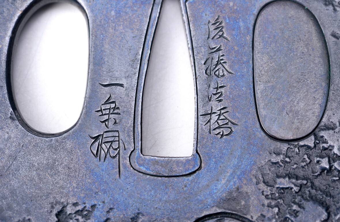

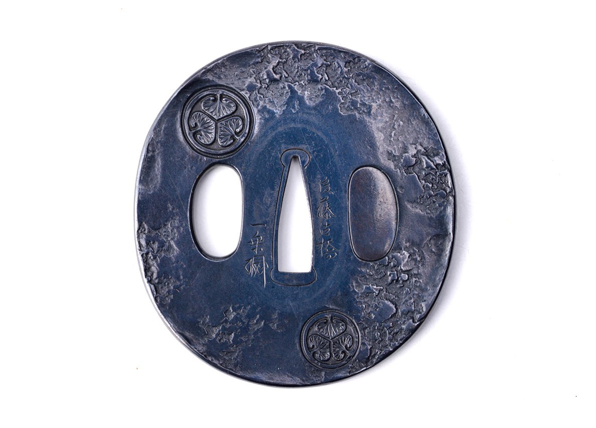

Hello all,
I wanted to share (what I would guess is) a rare occurrence when it comes to sekigane, one piece that is wrapped around the entire inner part of the nakago-ana. A bit of research makes be believe this is called 全周責金 zenshū sekigane. Does that sound right? Do others have examples of this? I am guessing this is just a more "high-class" way of refitting the tsuba, no?

27 minutes ago, Spartancrest said:
This sekigane and the copper insert on the kogai-hitsu-ana were made and installed by me about 15 years ago so please don't think it's an antique addition.(Not directed at you, Dale, just in general.)
I was selling the piece and the buyer wanted to install it on a sword he had so I added it so it would be closer to the dimension of his nakago. I figured it was a better way to do it than the buyer using a punch on the actual tsuba.
  • Love 1
  • Thanks 2
That is exceptional work, very clean and precise. I would love to pick your brain in the future if I ever attempt this.

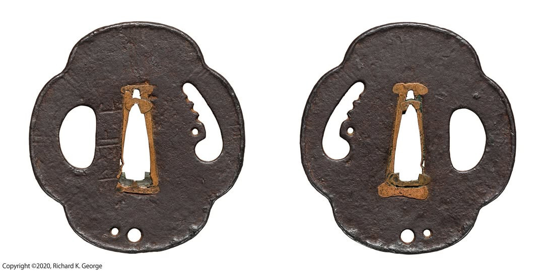

Here are a few of my pieces that have been repaired like that which I could access images of easily...
Best,
rkg
(Richard George)
  • Love 1

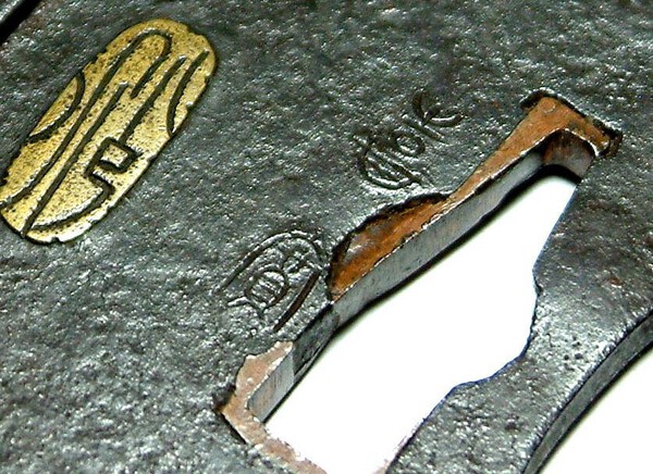

I have an Ichijo shakudo tsuba where the nakago-ana has been completely retro-fitted, probably some time after initial manufacture. You can see in the angled pictures that the alloy used is a slightly different colour than the black/blue of the tsuba. It's an extreme conversion and shows that the piece was important to someone but as to why it was done, your guess is as good as mine.
Best,
Tom
