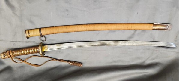

This is listed at a store down the street from me. Looks pretty nice for the price but I’m not savvy with these 95s. I like the relatively low serial number and condition.  I cannot tell if the saya has matching numbers.
What do ya’ll think? Is it worth taking a look at? Considering adding a type 95 to my collection.
Hi Sam ....jump on it if its well priced.
Nice package with what looks like and original tassel ( or bloody good repo but I'm going for it).  One of the first pattern after 'copper' 95's ..made by Suya Shoten Co Ltd, Tokyo !st inspection mark in middle and out of Kokura Arsenal.
Hard to know what's under the string binding but I have a copper that had that done to it.  Not a problem

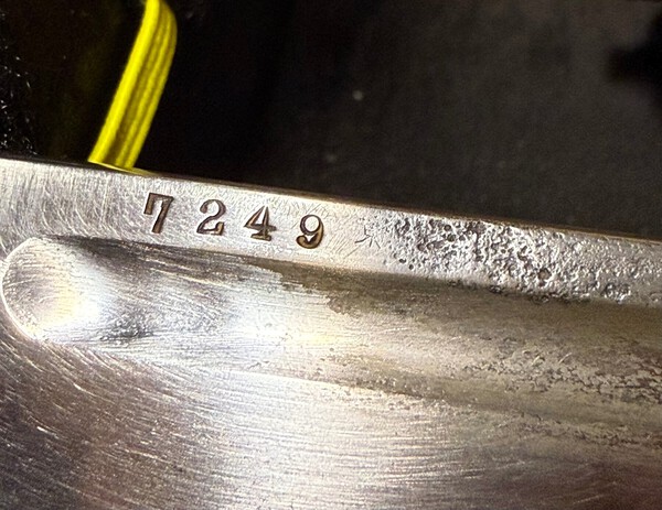

Try and find out what number is on the saya throat....if it matching (7249) then its even more collectable and valuable.

Looks good to me. Marks look good; correct screw in the tsuka. I too think the tassel is probably original. That's worth a couple of hundred by itself.
John C.
Hello,
         Sword and knot look 100% to me…..Possibly had a lacquer applied at some point hence the flaky bits on the metalwork ( but may be the photo’s + my ageing eyes) but that wouldn’t bother me….nice find……

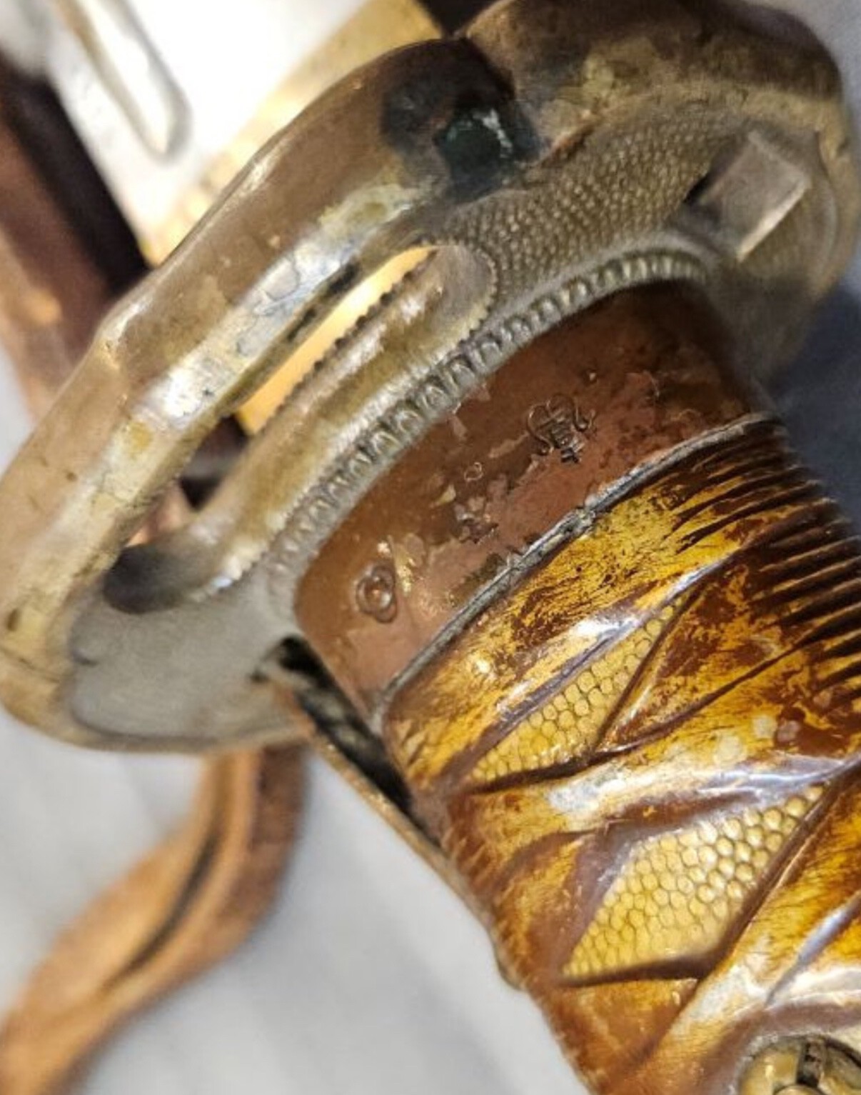

Well, I acquired the sword! Paid a little more than I had hoped, but still very affordable for a neat sword.
Heres some of my own photos of the fittings, I did my best with a new phone.
Some observations: Even though the saya had no serial number that I can find, it fits like a glove with no rattle. The yellowing all over is definitely done over wear and tear, like you mentioned.
Anyway, here it is! Let me know what you think good or bad.

I can faintly see a 東 inspection mark to the right of the serial number.  An unserialized scabbard just means it was replaced by a unit armourer at some point.  Not as uncommon as you think.
As Rob indicated, this is an early aluminium variation with a desirable hilt variation.  It is only the fourth one known in the 7,000 range.  Oddly, I have serial 7241 recorded, but it was tampered with by "Showa22".

Thank you Kiipu, and great eye! I didn’t even see that small mark. Here’s a better photo. That’s great info about the saya and makes a lot of sense.
Much appreciated for the link. I’m going to sit down and read it over this evening. Sounds like I lucked out and found a cool piece!
