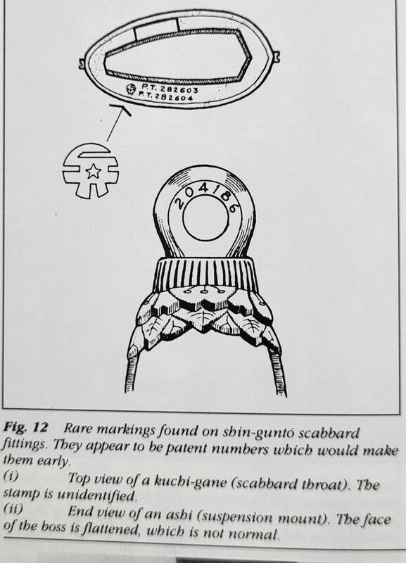

BANGBANGSAN Posted June 18, 2024 Report Posted June 18, 2024 15 hours ago, paul griff said: the saya is the lightweight wooden typ Paul.. Paul Could you post some photos of the says(Scabbard throat and other metal parts etc)?Thanks Quote

paul griff Posted June 18, 2024 Author Report Posted June 18, 2024 Hello, No mon on the tsuka Volker and yes the habaki is silver foil….Trystan , photo’s of the lightweight saya and fittings attached and for comparison the lightweight saya on a 23rd Generation Kanefusa…. Paul. Quote
Bruce Pennington Posted June 18, 2024 Report Posted June 18, 2024 19 minutes ago, paul griff said: Kanefusa Ah, the Shoheikan Gunso Kabushiki Gaisha stamp. The shop made "army and navy koshirae. They also adverstise a wood saya gunto koshirae. The company was located in Tokyo and owned by Mr. Saito" -- Chris Bowen; Fuller & Gregory, "Japanese Military and Civil Swords and Dirks", pg 227. 1 1 Quote
BANGBANGSAN Posted June 19, 2024 Report Posted June 19, 2024 6 hours ago, paul griff said: Kanefusa I thought your Yasunori came with a lightweight wood saya from 尚兵館株式會社(Shoheikan Kabushiki Kaisha), that's why I asked for the photo of the scabbard throat. 尚兵館(Shoheikan)has an excellent reputation for their wood saya. By the way, they are the exclusive distributor for the 23rd generation Kanefusa. 5 1 Quote

Volker62 Posted June 19, 2024 Report Posted June 19, 2024 Paul perhaps you can compare the suspension mount on your scabbard 1 Quote
