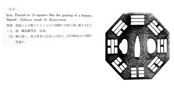

Spartancrest Posted May 29, 2025 Report Posted May 29, 2025 The way the 'ray' lines don't intersect the slots like spokes should suggest the meaning is something else to me. Like this guard from the Church collection. 3 Quote
Bugyotsuji Posted May 29, 2025 Report Posted May 29, 2025 The question is Kurikata Bruno's, right? Dale's is showing the I Ching, the Book of Changes. I ching - 検索 画像 2 Quote
