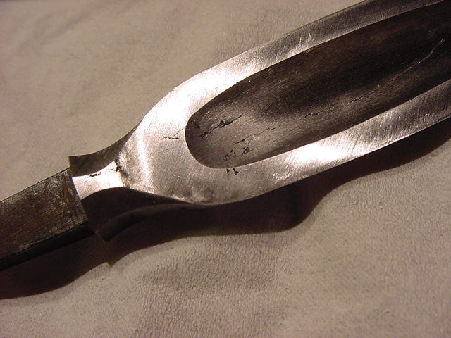

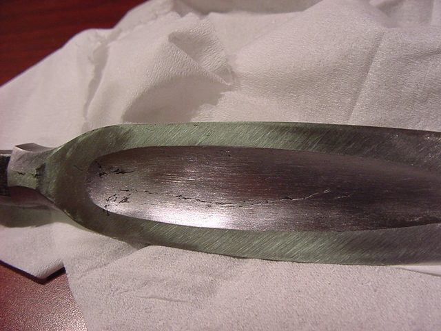

Hi Guys, when I polished this a few years ago I had restored it to the original fashion as you can see here:
http://www.japaneseswordcollector.com/nao/nao1.html
There were no openings in the hi or on the neck. I've polished many blades that have had lacquered grooves and quite a few had no openings or flaws under the lacquer, some others have had some problem areas but nothing that isn't seen on non lacquered grooves.
Between the fashion at the time, the smiths tastes and preferences, the customers request, and maybe the "used car salesman" tactics of the sword dealer, there are many reasons but in the end it boils down to taste whether one likes lacquer or not.
It should be noted that to prepare the groove and then lacquer it would be about the same as polishing it completely cost wise, so unless there was something to cover up no cost would be saved by lacquering in my opinion.

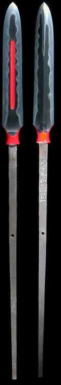

I saw this restored yari on another forum and wondered if lacquering was perhaps originally done as a shortcut to finishing the blade, thinking that a coat of lacquer would be a lot quicker to apply than finish polishing the hi and/or kerakubi.
With your above comment, I guess not.
As a polisher, do you think it is quicker to lacquer than polish, regardless of cost?

Depends on what it is - every blade is different, lacquer work does take time as does polishing a carving. There are no solid answers for that question.
Louis

Seen this Yari many times and has always admire your work on this one Louis
Thanks very much John, I appreciate that. I love working on yari, very technical and can be very beautiful if you get the right one.
