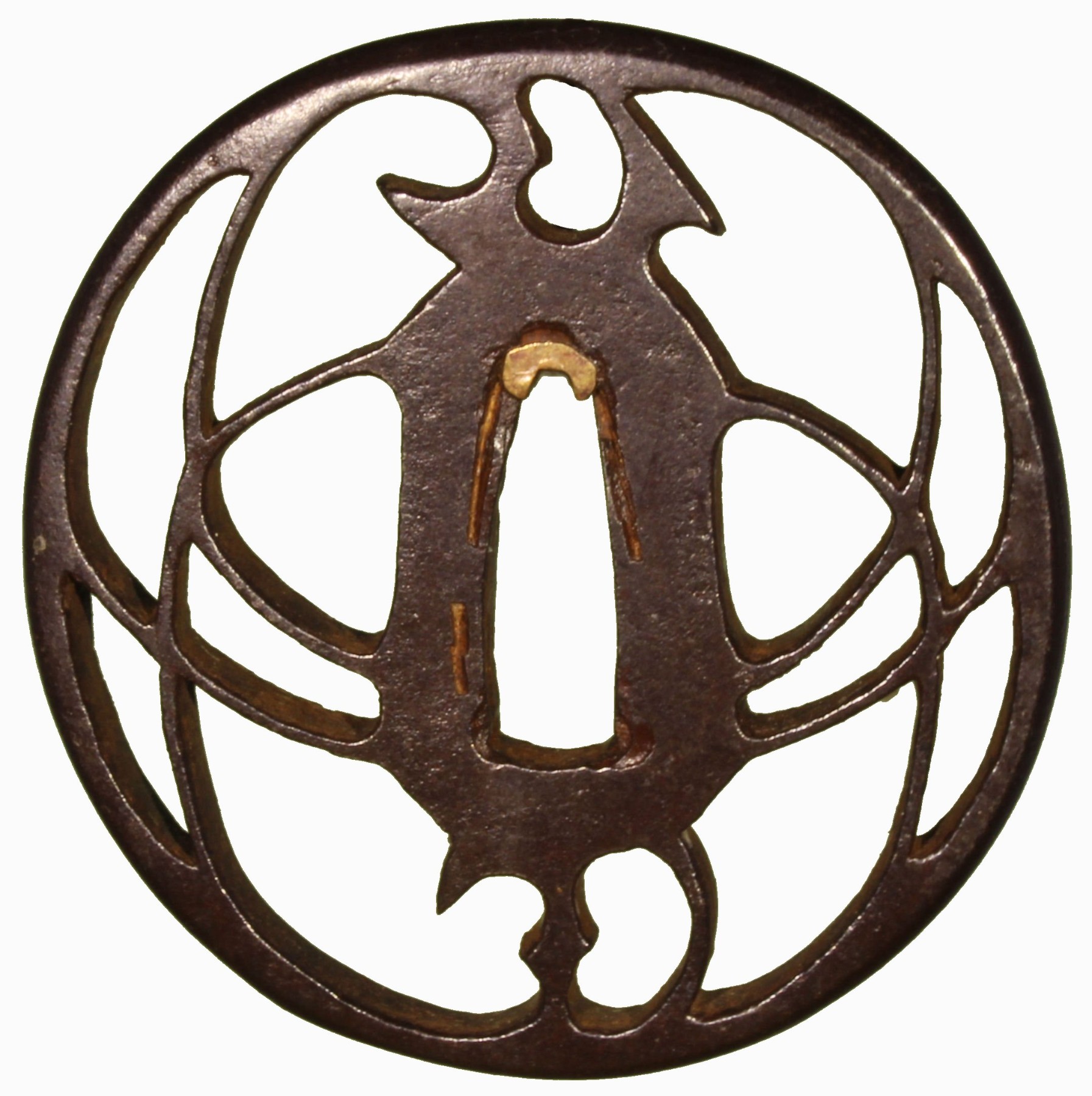

I've just bought this tsuba and I wondered about the theme
I do have some tsuba that I've no idea about theme
I wondered if it was from a sketch, an idea or just made it up as he went
Maybe he started then kept making additions
A tenuous thought was this a ring of beads

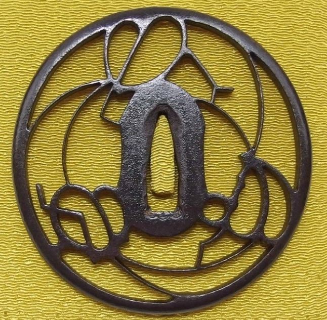

Hi Grev, the subject of Akasaka tsuba is 武 蔵 鐙 - Musashi abumi. The Stirrups of Musashi refers to a book reporting the Great fire of Meireki in 1657 (according to "Tsuba - Kodōgu Gadai Jiten" by Numata Kenji).
  • Wow 2
Tom nailed it.
Then Mauro put the smackdown on a theme I didn't know.
By the way, veeeerry nice Akasaka.
Do you know the thickness of that one?
The first one definitely looks like a rimbo/rinpo/rinpou 輪宝it, and it looks like the ends of the spokes are either jewels (which are often seen in these wheel motifs, like in the image below), or maybe even the tips of vajra (a handheld scepter with Buddhist symbolism).
 image.jpeg.bc9831d774a3c19ec7f182161a30b9d7.jpegVajra | The Demonic Paradise Wiki | Fandom
The rinpo is a Buddhist symbol shaped like a wheel with eight spokes (usually 8). The eight spokes represent the Buddhist "eighfold path" to reach enlightenment (don't ask me what the eight steps are though)
Two great results - thanks
A quick search of the Akasaka tsuba but I can't see the design and the relationship to the book
Curran it is 72 x 71 x 7.2mm and is papered
  • Love 1

It's a bit difficult. I would think it was a suzumushi motif. But its all antennae and no bug. Hard to say for sure what it is.
suzumushi 鈴虫 = cricket
