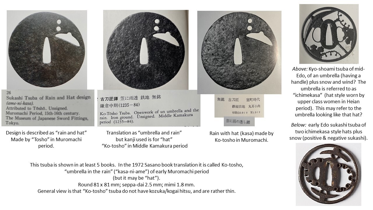

Bugyotsuji Posted May 18, 2022 Report Posted May 18, 2022 Recently this arrived forlorn and bereft of accompanying story. Iron, 7.3 x 7.2 x 0.4 cm. Thickness suggests not Ko-tōshō, but maybe Tōshō.(?) And then I began weaving a story regarding the theme. I wonder if anyone arrives at the same thought as me… PS There is no ‘correct’ answer as far as I know. Quote

mecox Posted May 18, 2022 Report Posted May 18, 2022 Piers, maybe Tosho, long sukashi definitely an oar, the other likely an umbrella, but could be old Japanese straw hat. A fisherman? Can you paddle a boat and hold an umbrella? 2 Quote

Bugyotsuji Posted May 18, 2022 Author Report Posted May 18, 2022 Nice spot on the oar! The kasa (straw) hat, yes. Mecox has sailed close to what I was thinking, and Dale’s hat looks good. As to the samurai neckties, least said soonest mended. So what story does that fit? And if so, how could that resolve the age difference between Ko-Tōshō and Tōshō? Quote

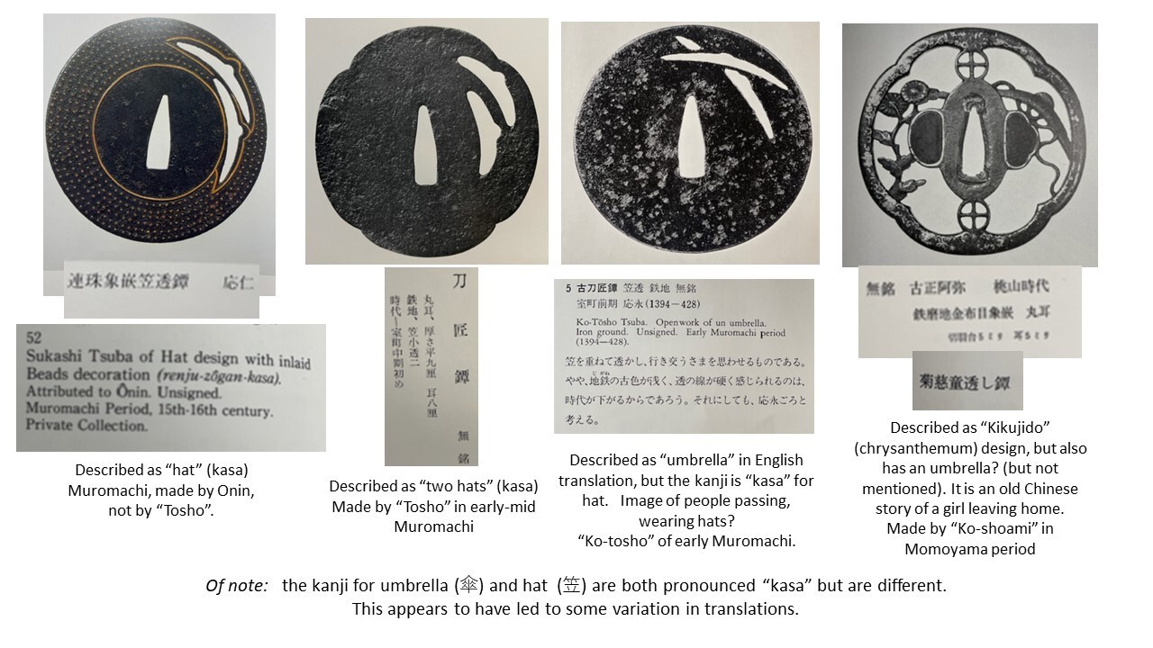

Bugyotsuji Posted May 18, 2022 Author Report Posted May 18, 2022 There’s a fine line between them, Barry. Shapewise they must overlap considerably, the difference being in the military function of the jingasa. Interesting facts. The dome-headed rivets you find on Katchū armour (on the Mabisashi visor for example) are called Kasa-no-byo for their sombrero/umbrella/hat-shaped appearance. Also, wound scabs are called Kasa-buta or covering lids. 1 Quote

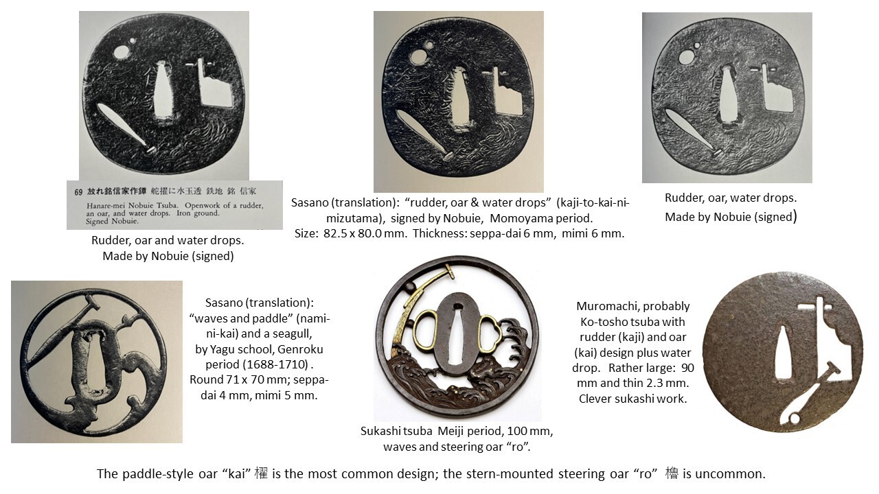

mecox Posted May 19, 2022 Report Posted May 19, 2022 Interpreting these tsuba gets a bit philosophical...and you need to ask the maker. But for this one I would go with umbrella (kasa) which is a common design item with rain drops (kasa ni ame); and an oar or paddle (kai). So with an umbrella in a paddled boat, suggests a passenger, so maybe theme is "water taxi" , boatman and passenger in the rain. Re the tsuba, rather small (7.3 cm) suggests small katana (or wakizashi), plus the tsuba looks rather crude and thick, so more like "Tosho" as opposed to "Ko-tosho". The latter are earlier and Muromachi, even Kamakura, and are larger often 8.0-8.5 cm, basic but well made and designs neatly cut, and well forged iron. So themes can be rather open. 1 Quote
Bugyotsuji Posted May 19, 2022 Author Report Posted May 19, 2022 Mal, many thanks for your input. Your mention of rain has rather poured on my parade, though. In my imagination was… Oar = Musashi, who carved an oar, and took advantage of the angle of the sun (suggesting open boat, nice weather, woven hat for shade) to better his opponent Sasaki Kojiro. Fitting story for a tsuba. But, if it is telling this story through Rusu-moyō, that means that the Tsuba has to be later than the fight on the island (1612). 1 Quote

Bugyotsuji Posted May 19, 2022 Author Report Posted May 19, 2022 The difference between 櫓Ro and 櫂Kai. https://www.google.co.jp/search?q=櫓+舟&tbm=isch&hl=ja&client=safari&prmd=ivn&sa=X&ved=2ahUKEwiA9LKLyOr3AhVFw4sBHUBCDGAQrNwCKAB6BQgBEP8B&biw=414&bih=715#imgrc=wweSpk9YZlB5qM 1 1 Quote
mecox Posted May 19, 2022 Report Posted May 19, 2022 Bloody hell....well looks like 櫂Kai is the correct term for the tsuba design. And the other term is the origin of the old Japanese song "ro, ro, ro your boat gently down the stream...." . I'm getting ready for that glass! 1 4 Quote

kissakai Posted May 19, 2022 Report Posted May 19, 2022 I always thought thickness is an age in determining ko tosho and tosho. I'd expect ko tosho to be thinner 2 Quote
Bugyotsuji Posted May 19, 2022 Author Report Posted May 19, 2022 Me too, Greg. And here is a more detailed depiction of a fancy Kasa design, strings and all! 1 Quote
