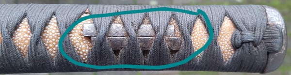

Brian Posted January 18, 2022 Report Posted January 18, 2022 Piers, Similar implements to those used by my fire-guy? 1 1 Quote
Bugyotsuji Posted January 18, 2022 Report Posted January 18, 2022 That’s a thread from the dead, but as good as ever! Very nice watchman! Quote

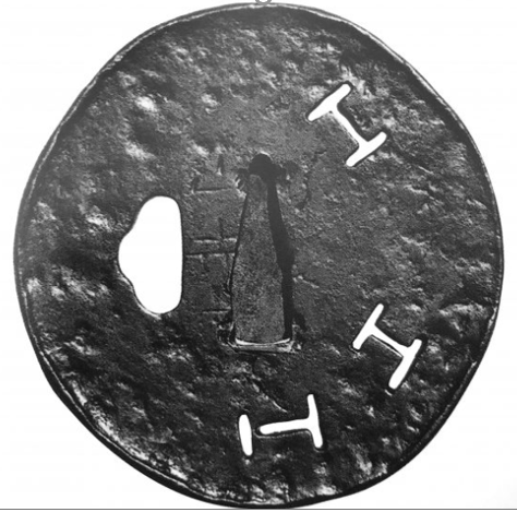

mecox Posted January 18, 2022 Report Posted January 18, 2022 Here's another variation on the design used on a plain iron tsuba from end of Muromachi era. These ones are jogi, or measuring sticks (basically rulers). The suggestion is that smaller scale ones may be the sangi counting sticks. Of course we cant always know what the tsuba-shi had in mind with the design. 1 Quote

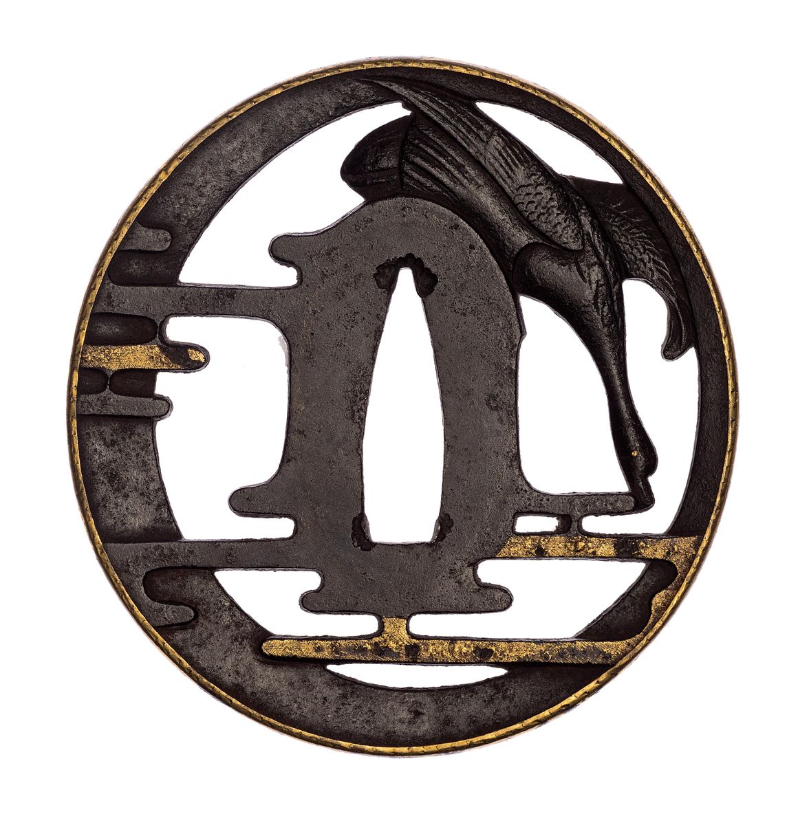

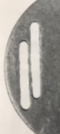

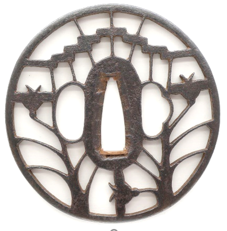

GRC Posted January 18, 2022 Report Posted January 18, 2022 (edited) OK, unless there are any more options to add, I think it's SUMMARY time And again, these associations are not absolutes. I'm just trying to find distinguishing characteristics and differences... 1- long skinny, 2 sticks, with square ends: JOGI (measuring sticks/rulers) 2- thicker, 2 sticks, with square ends, side by side or crossing each other: HYOSHIGI 拍子木 (clappers/rhythm sticks)... which has connections to kabuki and battle signaling. 3- not sure if these would look much different from# 1 or 2, but presumably they would be perfectly parallel and level or also involve some perpendicular sticks too: SANGI 算木(counting sticks) like these maybe: an Owari example from Sasano stating "cross braces (Sangi)": 4- vertical parallel bars with with rounded ends (maybe a key feature here?), has two possible interpretations so far: a) NIBIKI (RISING MIST BANDS). This is how Sasano described these first two tsuba examples sold at Sotheby's. *Jean Collin notes in a post below, that "mist" is typically represented by horizontal bars that have a "flowing" connection to each other, and provided the third image (below) as an example. b) SCHOLAR'S SCROLLS. Sergei Varshavsky suggested this alternate explanation for the VERTICAL BARS with rounded ends, by referring to descriptions in "Symbols of Japan", by Merilly Baird. VERTICAL AND SEPARATE: HORIZONTAL AND FLOWING: 5- more than two and up to 8, staggered "blocks", that are touching/connected (usually accompanied by some type of garden or pond motif): YATSUHASHI wood plank walking bridges And just to totally mess with everyone, what the heck are these "I-beam" sukashi? from Yamakichibei? Edited January 19, 2022 by GRC added alternate views for #4 after reading Jean's post and reading the info about the tsuba that Dale posted from the Varshavsky Collection. 1 Quote
ROKUJURO Posted January 19, 2022 Report Posted January 19, 2022 I would like to express my doubt concerning 4) as 'rising mist' (VARSHAVSKY collection). Mist or fog usually occurs parallel to the earth surface in nature, so unless the TSUBASHI did not intend the TSUBA to be seen in an unusual angle (which I have problems to imagine) I am not so sure about this interpretation. In other TSUBA mist or clouds are always depicted horizontally: I have seen rain depicted as big droplets (in KO-TOSHO TSUBA) or as fine parallel grooves, often in an angle, in later TSUBA. 2 Quote
