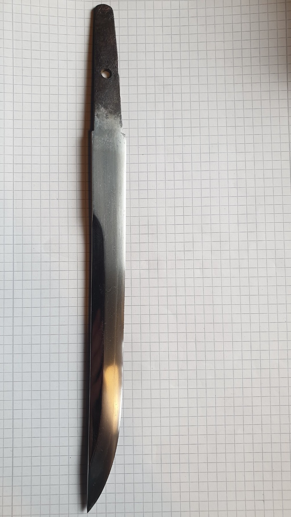

Hi, i bought some swords in the past and came across one small Tanto with a hada that looks strange for me. It's hard to see with the eyes but I handle to made a picture of it. Any ideas what this is called? I know the state ot the blade is not the best...
To give some perspective on the sword, how about shots of the bare blade both sides and tang both sides plus closeups of the boshi both sides????
The hada seems to be genuine enough to me, though.
BaZZa.
Looks like a combination of masame straight grain towards the mune and mokume wood-burl grain near the ha. The dark lines delineating the wood-burl are chikei. As Bazza says, nothing untoward there.
Hi, thanks for the answers. I already read about chikei but was not aware what it actually is. Is it something what is good to see on blades or is it something what is very common. I just ask because i did not see it on any of my other swords.
Thanks for the link, yes this helps because it explains the difference between chikei as an effect from hardening and as a simple steel layer pattern from mixed steels. I think it is quiet similar to the difference from wootz steel and pattern welded steel.
Judging from hada alone this is something relatively modern, no earlier than shinto, and quite possibly much more recent.
There was a movement within shinshinto (Ikkansai and others), who experimented a lot with very high contrast hadas which they could heat treat only at very low temperatures, so you see almost no transition between hada and hamon, while the structure is quite vivid.
Ok, thank you a lot. But shouldn't it be more prominent then? It is very dense and as i said it is hard to see with naked eyes. Maybe next picture explains it. The motohaba is 2cm. 20210930_141500.thumb.jpg.09918ab8b233cd512d1ab45175eb9c8a.jpg
Nice  little  late shinshinto tanto. Such hada  is not  uncommon  during this  time.
It is a pitty that the polish is in such terrible conditon. It seems that there is  intensive ji.nie.

Hi together, thank you for the good replies. As I am also a collector of european swords I am fimilar wird layer pattern in steel, but the structure on this tanto seems to be different, thats why I am asking here.
I added another picture where one can see that these lines are harder areas that stand out from (some long time ago) polishing.

@Christan
I believe it is called hada-tachi (hada that stands out).
@John
I still think it is hada. But we'd have to see it in hand.
It is hada. Chikei must consist of nie. this is not the case. Beside this hada  ji-nie is visible on the blade. The  very smal black points. I do not  mean the pinholes. I do think that marius is right, that the other thing is simple hada tach. this can be the result of polishing or the combination of two  or more sorts of steel. If one polishes a sword with mixed steel to hard, than it will be to strong hada tach.
This  hada tach can raise problems in meaning of seeing  other fine hataraki like ji.nie in the light reflex. Therefore honami said once that  a blade  like  sadamune should  never been polished hada tach.
Just some  random thoughts about hada tach.
