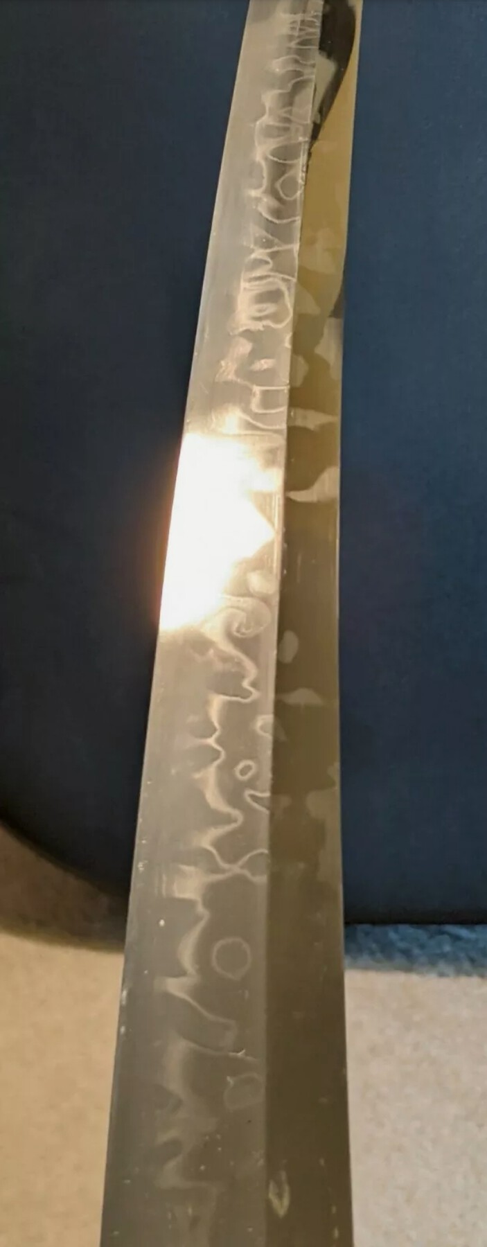

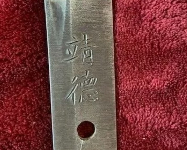

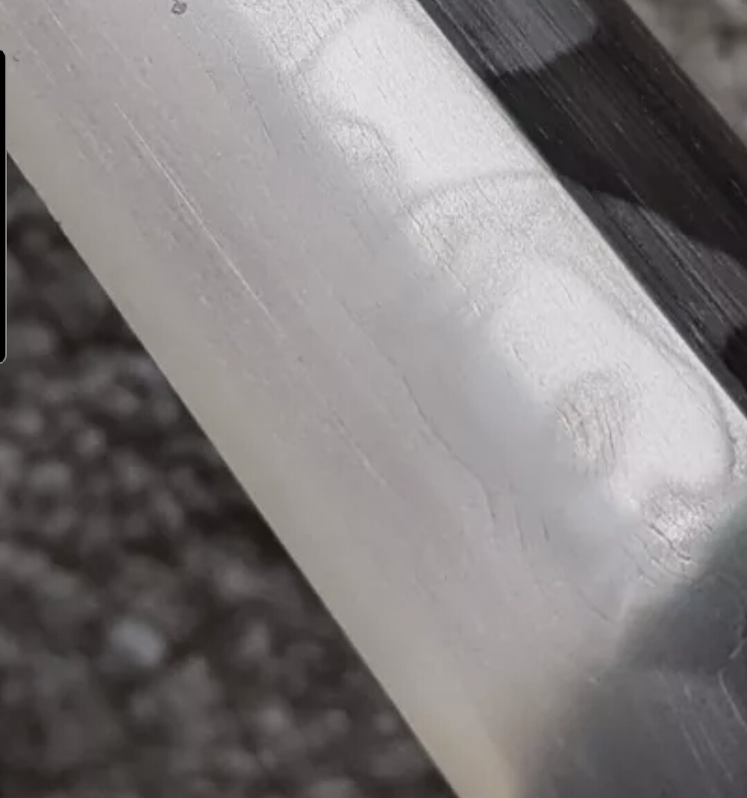

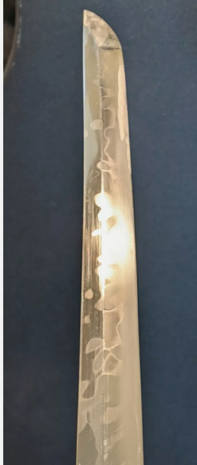

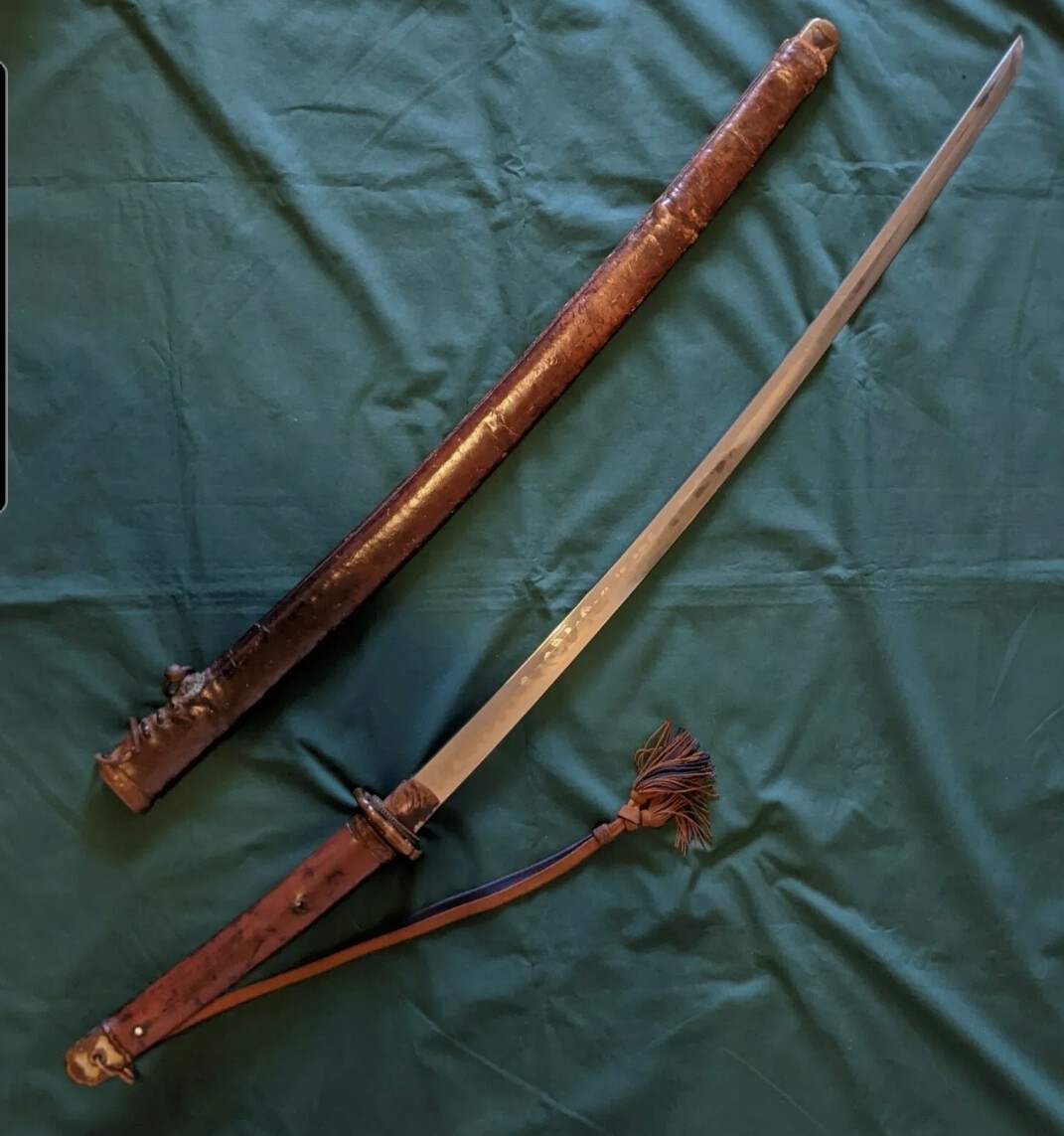

waljamada Posted February 20, 2021 Report Posted February 20, 2021 So here is a flamboyant one. Is this an authentic Yasunori mei who became a Yasukuni shrine Smith? Thoughts on the sword itself? Below are pictures of the sword in question with a large temper/hamon, 28.5" nagasa in early type 98 mounts. At the end is the mei of this sword and some other examples Yasunori mei examples I've found on some websites. There is also a photo of the flaws that exist on the blade (few openings and nail catcher knick). 1 Quote

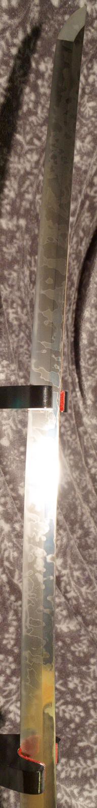

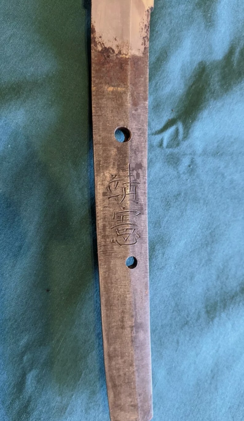

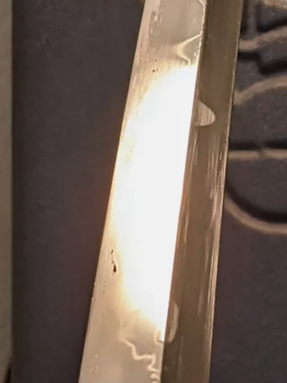

waljamada Posted February 20, 2021 Author Report Posted February 20, 2021 Here is the flaws and mei photos...uploaded in a weird order but photo #4 and 5 are the mei for this sword. 1 Quote

PNSSHOGUN Posted February 20, 2021 Report Posted February 20, 2021 The mounts are real, the blade looks Chinese. 1 1 Quote
waljamada Posted February 20, 2021 Author Report Posted February 20, 2021 Sorry to ask John, but what does my eye need to be catching? Here's why my eye was tricked: This blade has hada/forging/folding evidence, right looking patina for early 20th century (can of course be faked), yasurimei (could be a sign that it's the correct yasurimei to match the gimei), age looking wear on blade, water quenched hamon (is a bit messy though), real koshirae early type 98 (from what I see and if this is fake too Im even more afraid) shape of nakago doesnt draw immediate questions to me, shape of blade looks Japanese (but a non typical early 20th century shape but also a non typical blade) well fitted (according to seller) to a gunto saya with a 28.5" nagasa which is quite uncommon and would require uncommon saya....it all can make sense as an authentic gimei nihonto...I'm afraid...=|:^( Quote
Bazza Posted February 20, 2021 Report Posted February 20, 2021 Jumping in as the thoughts occur to me. Any Yasunori I've ever seen (a few! And I owned one at one time) are suguha and all about 25 - 26 inches long. Oh, and only one mekugi ana. Longer blades may be special order, but this certainly isn't one. BaZZa. 1 Quote
PNSSHOGUN Posted February 20, 2021 Report Posted February 20, 2021 1 hour ago, waljamada said: Sorry to ask John, but what does my eye need to be catching? Here's why my eye was tricked: This blade has hada/forging/folding evidence, right looking patina for early 20th century (can of course be faked), yasurimei (could be a sign that it's the correct yasurimei to match the gimei), age looking wear on blade, water quenched hamon (is a bit messy though), real koshirae early type 98 (from what I see and if this is fake too Im even more afraid) shape of nakago doesnt draw immediate questions to me, shape of blade looks Japanese (but a non typical early 20th century shape but also a non typical blade) well fitted (according to seller) to a gunto saya with a 28.5" nagasa which is quite uncommon and would require uncommon saya....it all can make sense as an authentic gimei nihonto...I'm afraid...=|:^( The Hamon has a very distinctive look on these Gimei swords, suspect it has to do with the steel and polishing methods. There is another sign which is dark areas in the Hamon. If you look through many of the Komonjo blades you can see exactly what I'm talking about, the Hamon just looks wrong. The other fact is these Gimei are focused on the higher end Gendaito of the period, so Yasukuni, Minatogawa, top level smiths etc etc. Finally Yasukuni Shrine swords are generally Suguha, rarely Notare and very rarely Choji. You would not see a Hitatsura Yasukuni-To, let alone with such glaring flaws. The sword would be interesting to own for a few hundred dollars, about what the mounts and tassel are worth. 1 Quote
waljamada Posted February 20, 2021 Author Report Posted February 20, 2021 John, thank you for that. I do know what you are talking about from the Komonjo blade hamons. They do seem to have a type and I can identify the hamon characteristics you mention in them. Someone went the extra miles with this gimei blade over the usual "authentic Japanese" komonjo blades with "unfinished saya" Quote
lonely panet Posted February 20, 2021 Report Posted February 20, 2021 didnt read much so i might be stated. biiiig fake. the listed examples of mei are both kotani yasunori and kajiyama yasunori. ones a founder with differant nakago shape, the other is a student of his. approx 2 years between them 1 Quote
16k Posted February 20, 2021 Report Posted February 20, 2021 The Hamon definitely looks like a Chinese Hamon. I’ve seen plenty of them like that. To be honest, they look quite good in hand. Quote

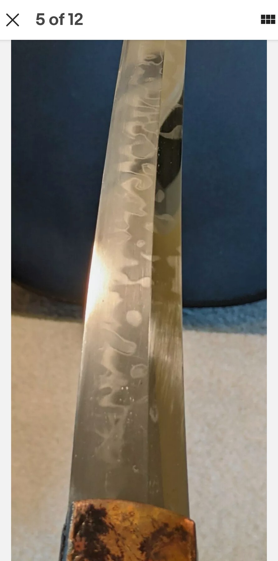

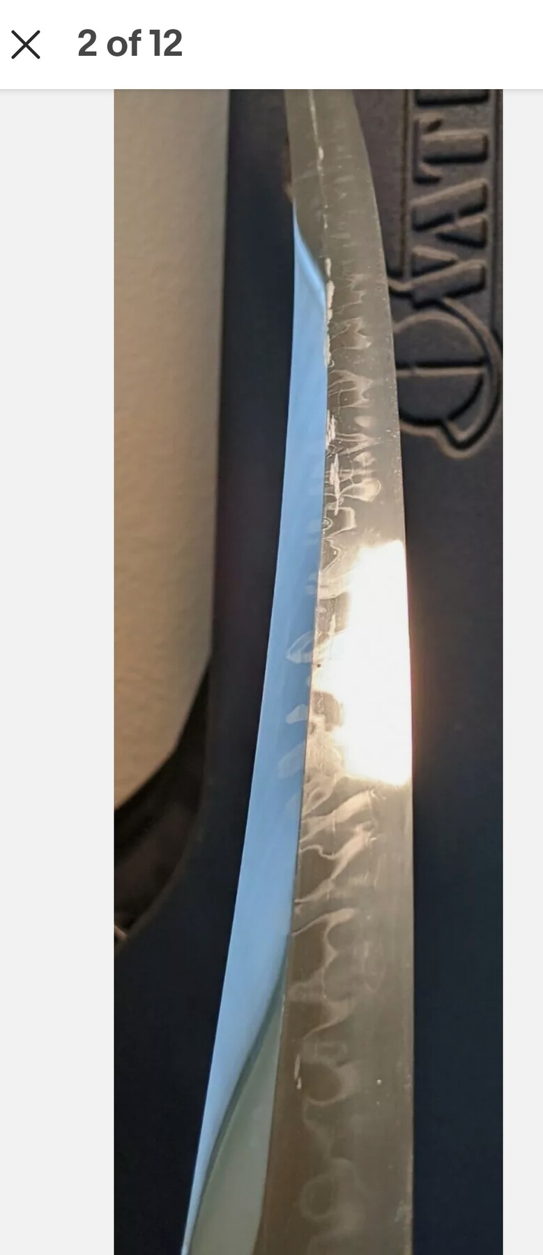

DoTanuki yokai Posted February 24, 2021 Report Posted February 24, 2021 Just found this blade, is this also a fake ? 1 Quote

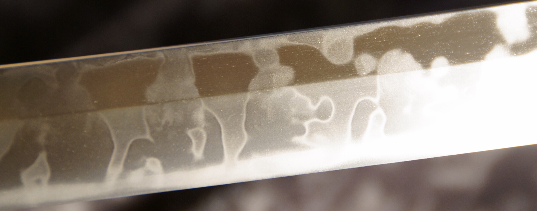

Hoshi Posted February 24, 2021 Report Posted February 24, 2021 Looks like the Chinese are into bad imitations of Hitatsura. Always innovating looking for the next treasure hunter. 1 Quote
DoTanuki yokai Posted February 26, 2021 Report Posted February 26, 2021 I also think the gimei yasunori is a real nihonto or at least I wouldn’t call it a fake just from the images. The blade I have posted is made by Ozawa shigenori and won nyusen price 2017. Some people wouldn’t even realize the treasure in front of them being overly suspicious (Not me downvoting anything btw) 1 2 Quote
Hoshi Posted February 26, 2021 Report Posted February 26, 2021 I would think Chinese too if you didn't tell me it was a prize-winning Shinsakudo. Nioideki on Muji hada... The difference in visual quality of a modern Hitatsura sword compared by one by Akihiro/Hiromitsu/Hasebe/Yozozaemon is simply astonishing. Has anyone in the Shinshinto realm of gifted smiths try re-creating Hitatsura? Naotane school perhaps? It would be interesting to compare results. 1 1 Quote
