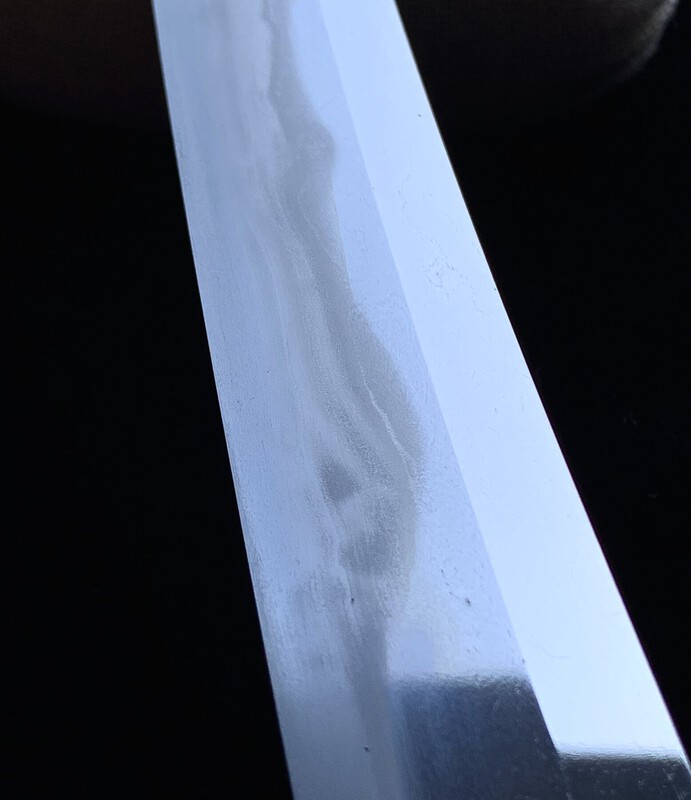

Bugyotsuji Posted October 6, 2020 Report Posted October 6, 2020 Recently I spotted a wakizashi in Shirasaya at a local auction and decided to take a gamble. No-one showed much interest, perhaps because there were no Shinsa papers and no koshirae. I made a mental price limit and bidded towards the top end of that. Surprisingly the bidding stopped with me. Gulp! Osaka, Tamba no Kami Yoshimichi? Several people have since looked at it, with no especially negative comments so far. Plenty of Sudareba. Opinions differ as to which generation, but on Sunday my sword Sensei commented that he could see traces of early work in it, possibly shodai. The Mei does seem to correspond too, but I know there are many gimei out there. He advised submitting it for NBTHK Tokubetsu Hozon. If it passes shinsa, I have a very nice koshirae that is looking for a blade, and I just wonder if they can be married. It's a wide mihaba, and those last 5 centimeters... hmmmm... and the problem of the mekugi position arises. Long-term winter project ahead to keep me warm? 😅 5 Quote

Brian Posted October 6, 2020 Report Posted October 6, 2020 When you have sudareba....that narrows down the possible smiths a lot. So the outcome sounds promising. Of course the call for pics is inevitable. Bring them on! And sounds like you did great. 1 Quote
Bugyotsuji Posted October 6, 2020 Author Report Posted October 6, 2020 Well, you know my photography skills... 🤪 11 1 Quote
Brian Posted October 6, 2020 Report Posted October 6, 2020 To me, looks like you scored bigtime. Can not be anything but one of the Yoshimichi's. 3 Quote

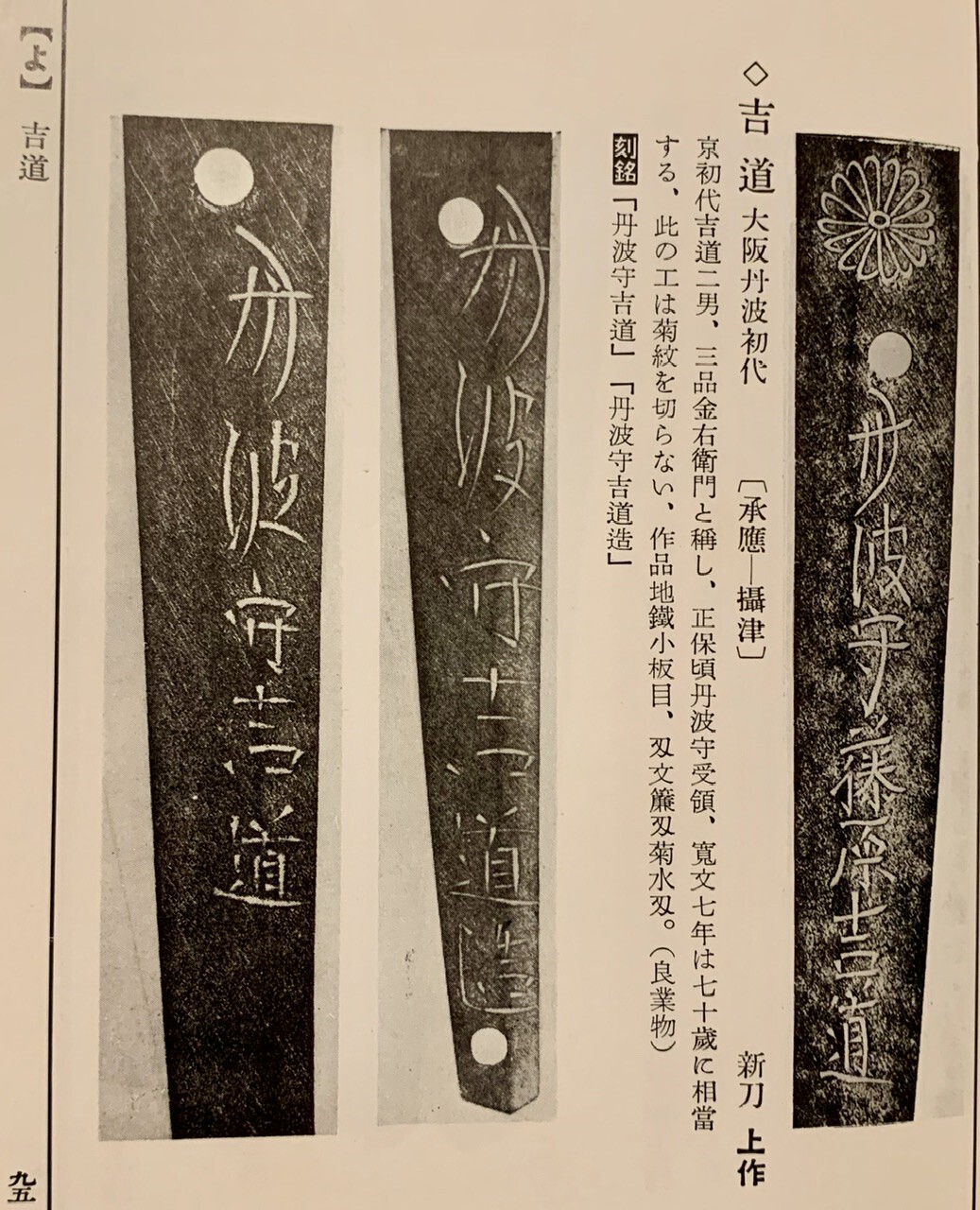

Bugyotsuji Posted October 6, 2020 Author Report Posted October 6, 2020 Dirk, sending you a pm. In the meantime this is from my Fujishiro. (Left of page.) Quote

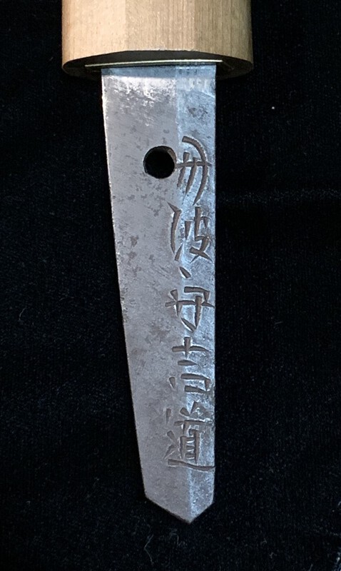

Bugyotsuji Posted October 6, 2020 Author Report Posted October 6, 2020 Your inbox is full? Oh, well, wasn’t planning to strip naked in public, but ‘in for a penny in for a pound’. I’ll have to go take a shot! 😂 For Paul and Dirk 5 Quote
Jacques Posted October 6, 2020 Report Posted October 6, 2020 Seems to be this one (smith not sword)😀 6 1 Quote
Bugyotsuji Posted October 6, 2020 Author Report Posted October 6, 2020 Cool, thanks for that, Jacques. Looks similar. The explanation says that from the relatively thick stroke cuts not sure, but maybe early example from third gen.(?) Genroku straddles the Ako Ronin affair. Quote
Brian Posted October 6, 2020 Report Posted October 6, 2020 If you squint a bit...could even be the same sword. Very close. Even down to stroke and ana placement. Can't be much doubt about it being shoshin. 1 Quote
Jacques Posted October 6, 2020 Report Posted October 6, 2020 8 minutes ago, Brian said: If you squint a bit...could even be the same sword. Very close. Even down to stroke and ana placement. Can't be much doubt about it being shoshin. Fully agreed 1 Quote

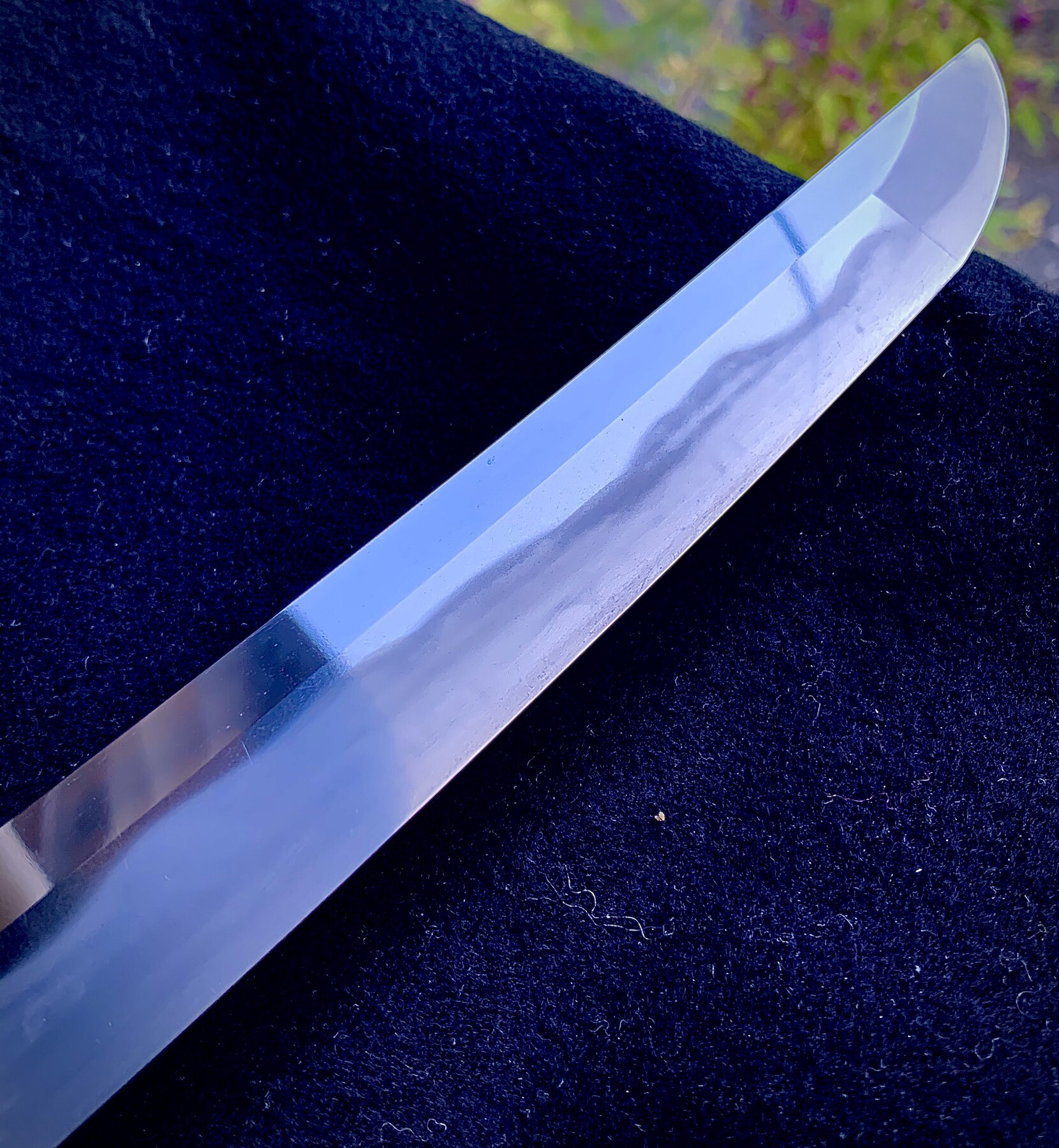

Bugyotsuji Posted October 6, 2020 Author Report Posted October 6, 2020 This side of the blade. Hmmm... they both have Table Mountain from Cape Town, but not so close to the Shinogi line. Quote
Popular Post Yasaka Azuma Posted October 6, 2020 Popular Post Report Posted October 6, 2020 Congratulations Piers. It's certainly the same compared to the tang that Jacques showed us. Picking up a sword in a book is a rare luck. 13 1 2 1 Quote

Promo Posted October 6, 2020 Report Posted October 6, 2020 All I can add is playing a bit around more in Photoshop with the pictures, to make yours look picture look like the one in the book and put them side to side. If this is of any help, see attachment. 7 1 Quote
Bugyotsuji Posted October 6, 2020 Author Report Posted October 6, 2020 Jacques, where did you find that p.870 entry!? Quote
Jacques Posted October 7, 2020 Report Posted October 7, 2020 12 hours ago, Bugyotsuji said: Jacques, where did you find that p.870 entry!? Imura's Shinto taikan 1 Quote

Babu Posted October 7, 2020 Report Posted October 7, 2020 Yes it's the same sword as the oshigata in the book. 3rd generation? Quote
Bugyotsuji Posted October 7, 2020 Author Report Posted October 7, 2020 On 10/6/2020 at 9:23 PM, Bugyotsuji said: The explanation says that from the relatively thick stroke cuts not sure, but maybe early example from third gen.(?) From post #14 above. That is roughly what the blurb says below the oshigata. Unusually deeply incised, but could well be an early example of the third generation, “judging by the somewhat similar 鏨切目, tagane kirimé (cold chiselwork)”, but at the end it says 「いずれの代に該当するか不明である。」Izure no dai ni gaito suru ka fumei de aru.(= not clear which generation it fits with). And that is why I found interesting my sensei's comment interesting, where he found signs in the blade indicating possible early Yoshimichi work. Quote
Bugyotsuji Posted October 8, 2020 Author Report Posted October 8, 2020 17 hours ago, Jacques D. said: Imura's Shinto taikan Is this Imamura Nagayoshi? Quote
Jacques Posted October 8, 2020 Report Posted October 8, 2020 12 hours ago, Bugyotsuji said: Is this Imamura Nagayoshi? Author of the shinto taikan is Iimura Yoshiaki 1 Quote
